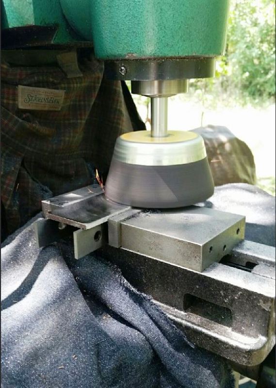

    Not having the coins for a surface grinder, I tried this affordable alternative today and I'm happy to say "That'll do, pig".
    I bought a Dewalt cup grinding wheel and made an arbor for it to mount in my mill and it works.

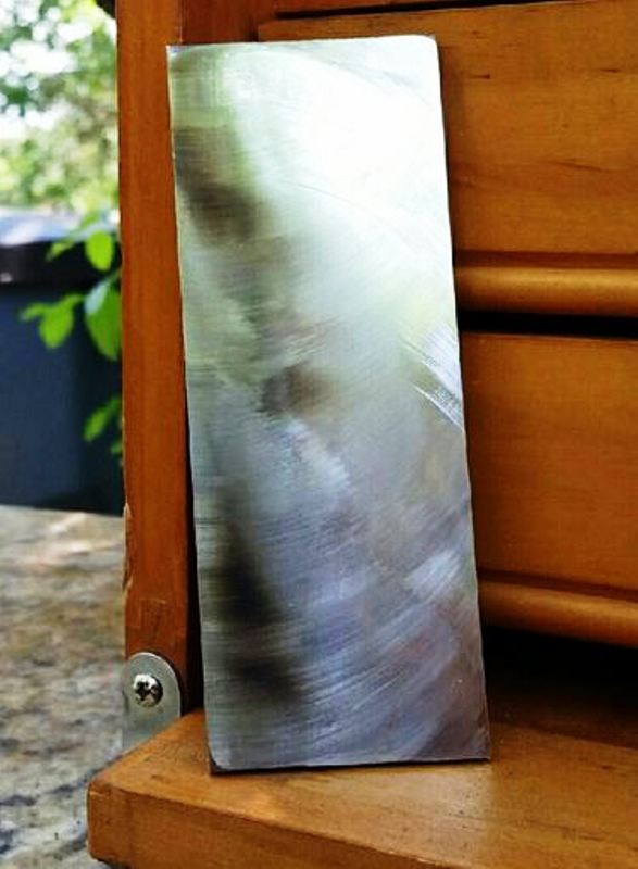

    I spent a little time surfacing this piece of mild steel and while it doesn't look like a high dollar surface grind finish (it's a Blanchard grinder after all and they never do) it did produce a surface that's as flat and smooth as I could hope for and it will work just fine when I need things to slide over each other smoothly and accurately. It's a better surface that I've ever milled with my carbide surfacing cutter.
    Everything on the mill must be covered to catch as much grit as possible but plan on spending some time afterwards with an air nozzle and a brush, and make double certain that all of your covers will stay in place as the table travels and watch them closely anyway. I had a bit of trouble getting my cooling mist completely under the wheel's surface and so had a couple of spots that are heat discolored but I think I can solve that issue with more practice using it.
    That test piece (which has had only soap and water cleaning after grinding) is absolutely smooth and flat as I run my finger nail across it so I know it will work for my purposes. All in I think I've got less than $30 in this experiment and I've added another tool to my repertoire. If you need a surface grinder and can't afford one, this technique is worth trying.

    And for people who don't know, don't blow any air AT any sliding joint or bearing. You'll just embed grit in the joint. Only use a brush or vacuum around the ways or the old tool maker will appear to slap you with the air hose.

    I remembered after the first surface that I hadn't dressed the wheel face true so I clamped my diamond point in the vise and made the wheel perfectly flat and tried it again on the opposing face and I discovered why Dewalt made the wheel with the face angled a slight bit. With the stone face exactly parallel there's no clearance for dislodged grit and the wheel jammed frequently on it, so I'm going to have to put a relief angle back into that stone's face. I was able to solve the heating problem with lots more coolant (but it didn't wash the grit out of the grinding area).

    Be very careful using compressed air when cleaning machines. The air can and will drive grit into everything and that can and will cause increased wear on sliding parts.

    I only use air to clean out my table grooves, everything else gets brushed out and wiped off. If I remember to wipe everything down before I start so loose grit doesn't stick to anything then my shop vac does a pretty good job. I'm also gonna cut up an old shower curtain for a drape so that no grit can get through it.
    It makes really flat surfaces but since I can't rotate the work too like an actual Blanchard the surface doesn't look very uniform but maybe that's a good thing because it should hold oil better than a slick surface.

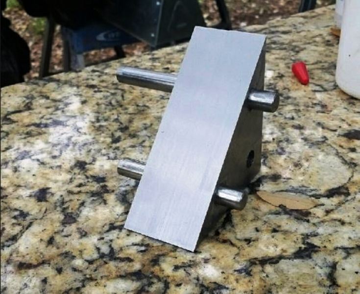

    Actually I'm not really sure why I'm thinking about trying surface grinding because planing in horizontal mode leaves a beautiful flat finish (here's two 1" thick triangles pinned and planed together) and it's a lot faster than grinding. To speed things up I ganged two cutters onto the arbor for the roughing cuts and then finished with a single cutter to level the surface. It's certainly flat enough for anything I might make.
