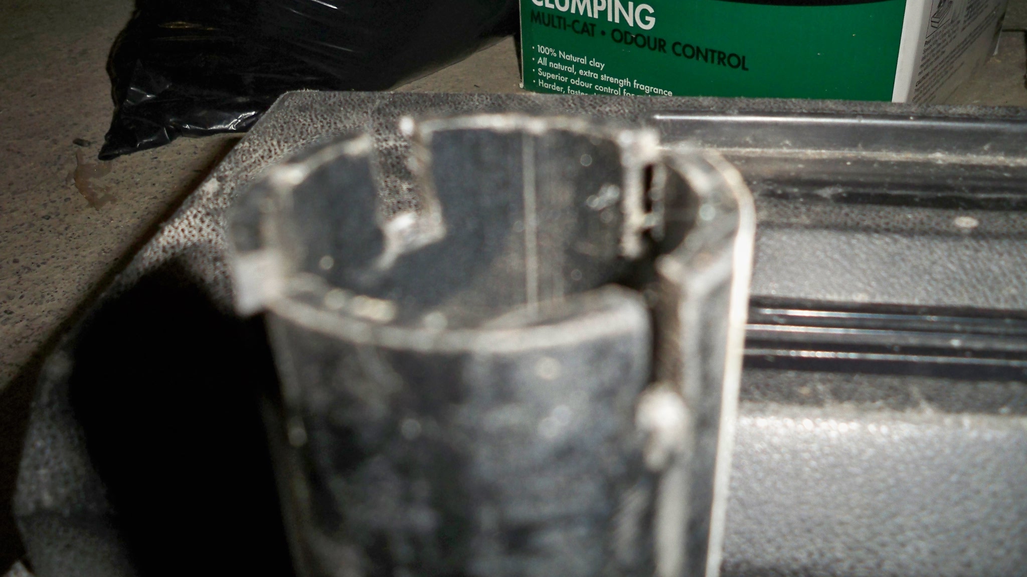

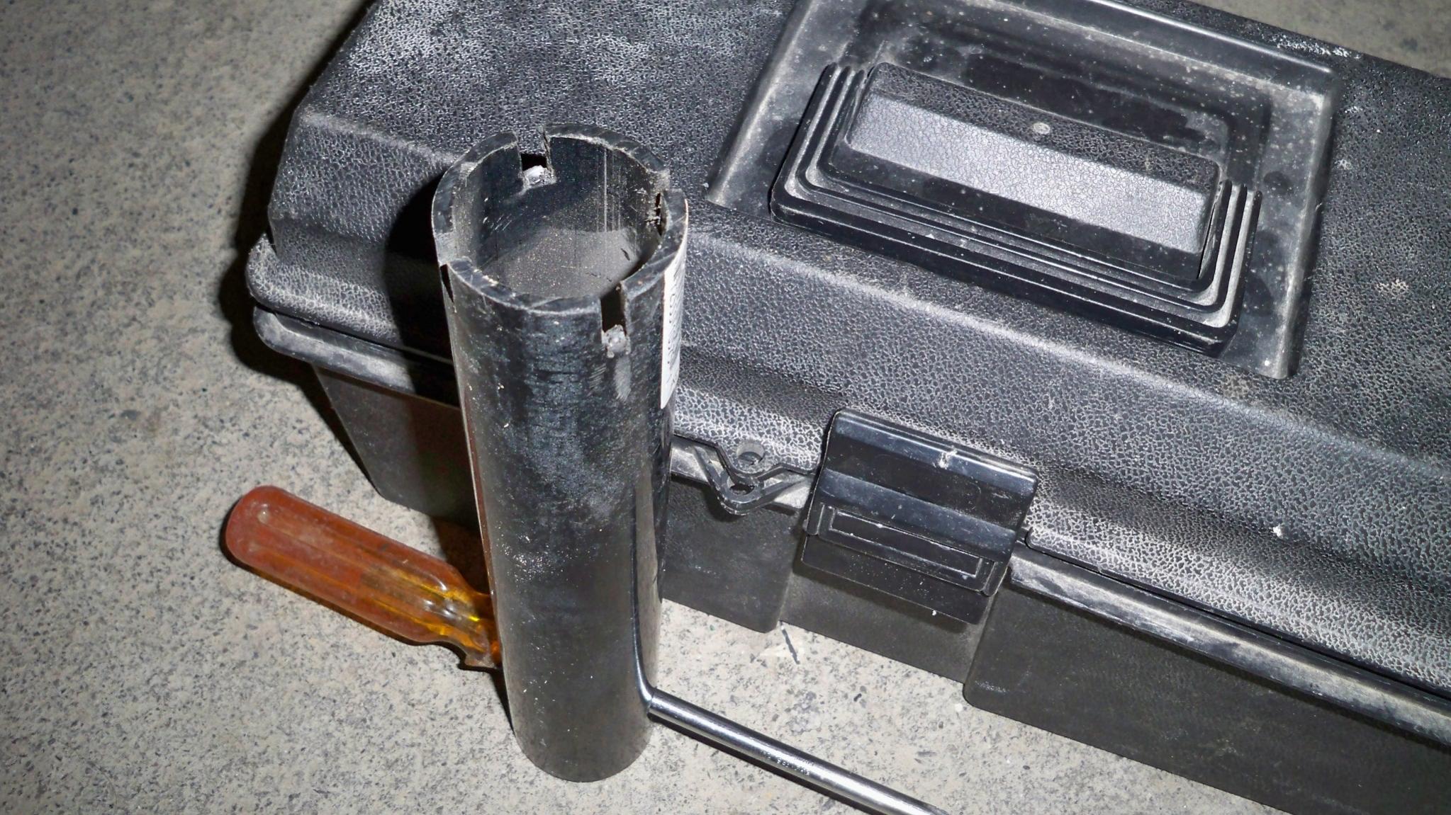

    Plumbing Tool-100_3953.jpgDoing a change out of a set of taps can be a bit tedious without the right tool for removal and installing. I used a short piece of 1 1/2 ABS drainage with these notches cut in one end with a hacksaw. drilled a hole through the other end to insert a rod (or screwdriver) for leverage. made it quick and loaned it to neighbour who was "stressed" at the difficulty he encountered and he was amazed at how easy the job became! The tool also kept ME from winding up under that kitchen sink too! LOLPlumbing Tool-100_3954.jpg
