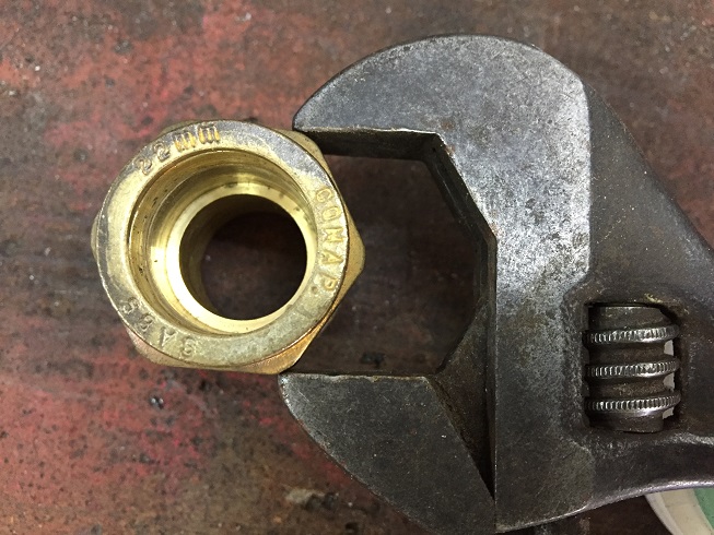

    Here is SA we have 15mm and 22mm general domestic water pipes.
    It turned out my shifters were just to small to grab the 22mm fixtures.

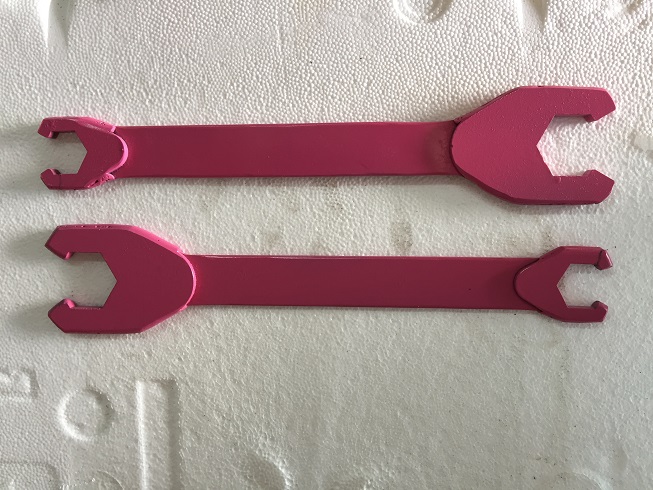

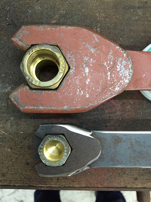

    So I drew up spanners that will fit these connectors. I added a lip on the open side of the spanner as I found a couple of occasions I needed to have the spanner stay on the nut while I move the other spanner to the next flat. Can always cut it off at a later stage if it is more trouble than worth.
    I had them cut from 3mm mild steel with a double plate on the mouth side to add a bit of strength and not have the spanner too heavy. I created more leaks by over tightening these type of connectors than having them too loose and not squashing the ferril.
    Here they are in bright pink as
    1) I will not loose them and
    2) That was the only bright paint I had on the rack (after the last project I helped the little grand daughter with)
