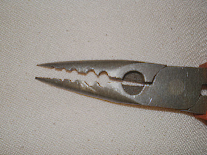

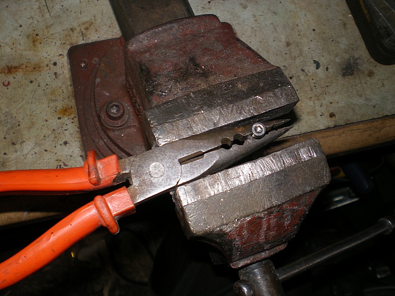

    Some years ago I modified a cheap (no name) pair of long nosed pliers by drilling 5 different sized holes along the joint. They have proved so useful for many tasks that they are always on my bench. i.e. working on small screws, grinding and polishing items, and as I have always made up my own bowden cables they are a heat sink when gripped in the vice for soldering nipples to retain the cable temper. As a bonus they are non marking.
    Cheap tools can be useful for some things as they are usually soft enough to be modified.

    Good idea, so good, in fact, that tool manufacturers sell them...
    https://www.amazon.com/TNI-U-TU-346S...e+clamp+pliers
    https://www.amazon.com/dp/B016XE2CHA...539448856&sr=3
    https://www.amazon.com/Park-Tool-Nee...le+nose+pliers
    Modifying cheap tools is a frequent job here in Garaj Mahal. I have a pair of long-reach needle nose pliers dedicated to holding stuff in the torch flame. I'm sure the hardening in the jaws, if there ever was any, is long gone but the only function required of them is to grip stuff so all is well.
    Over here there's a retailer, Harbor Freight, who issues coupons for free tools in their advertisements. Their free, cheap screwdrivers have been ground into too many dedicated "tools" to count.
    Regards, Marv
    Nice that you were able to get 5 holes...lots of choices there. So true about modifying cheap tools. Have to give credit to my dad on that one as he made all kinds of special tools as I was growing up from the 99 Cent bins. He always said if you're going to use it every day, buy one, otherwise make something for a few uses...which sometimes turn into decades. ~¿@
    Done similar with needle nose, pliers to Hog ring pliers, screw drivers (made T-Handles and carb bowl scrapers...Lots...even just use the round bar and reshape it for what ever the need), various wrench types, bent, bent at just the right angle, ground, notched...most all from the 99Cent bin at Hardware stores or HFT. Tweaked a HFT 17mm open end awhile back to reach a pesky bolt head changing the window regulator in my car. Had to bend it in two places to keep a low profile and grind it thinner...and still drew blood but got it out and back in.
    Thanks for bringing this to the forefront again, OlderDan...It's what this forum is about I think.
    PJ
