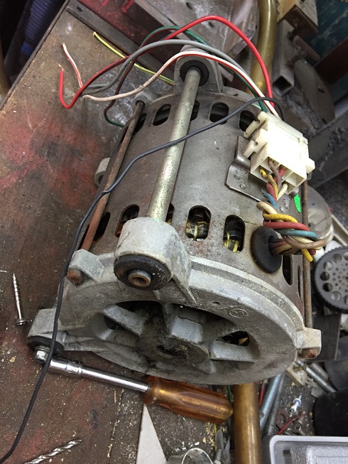

    Friend scrapped a Defy Auto Front loader washing machine, some 30 years old.
    Motor and Cap came my way, but no idea how to wire it.

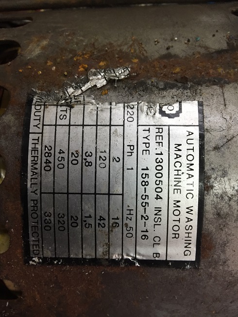

    It is a 240V AC single phase motor, 2 speed and the slow speed has forward and reverse.
    From the wiring I received the White wire seems to be Neutral as it has several spade connectors attached so assume it went to all the switched and elements and thing.

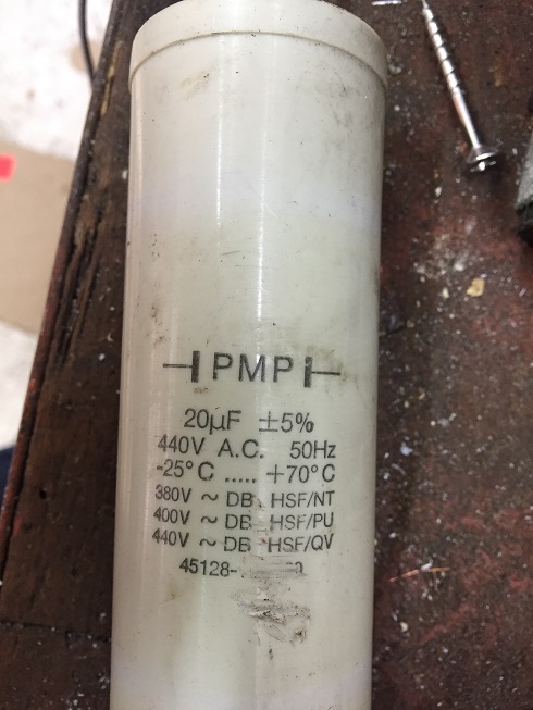

    This is the cap that came with it.

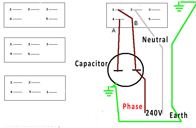

    Connector can be vary according the brand
    but the same numpers represent the same wires/connections
    Quick speed
    Capacitor → 1, 4
    Phase → 1
    Neutral → 2
    Not connected 3, 5
    Slow speed 1
    Capacitor → 3, 5
    Phase → 3
    Neutral → 2
    Not connected 1, 4
    Slow speed 2 (In reverse direction of Slow speed 1)
    Capacitor → 3, 5
    Phase → 5
    Neutral → 2
    Not connected 1, 4

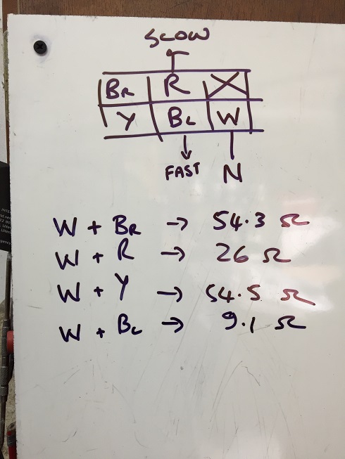

    so for my understanding....
    I must use the sketch to determine what number configuration my motor is using.
    So because I have no wire connected to the top Rh terminal my plug configuration should be the 3rd schematic
    [1, 2, Nothing]
    [5, 4, 3 ]
    From the wiring received with the motor terminal 3 appears to be the Neutral.
    any way to check what wire is neutral?
    Thanks Again.

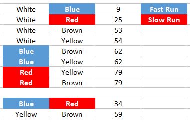

    Not working on this motor.
    Perhaps if somebody can explain to me the science behind an AC induction motor.
    This is what I learnt from the net....
    There are RUN windings ( Low resistance) and START windings (High resistance).
    Centrifugal switch somewhere inside to switch off start windings....sometimes.
    So seamed easily enough to measure all the coils and as I know it is a 2 speed motor, the lowest 2 readings will be the 2 RUN windings.
    Then find the common wire connected to both these coils and it should be your Neutral. Turned out to be the White wire.
    Anything wrong with my logic so far?
    Now to find the Start coil....should be one of the coils also connected to the White wire. So Brown or Yellow.
    Tried both and it still only hums.
    Connecting Neutral to White and Live to Red or Blue runs perfectly if you give the motor a spin in one or the other direction.

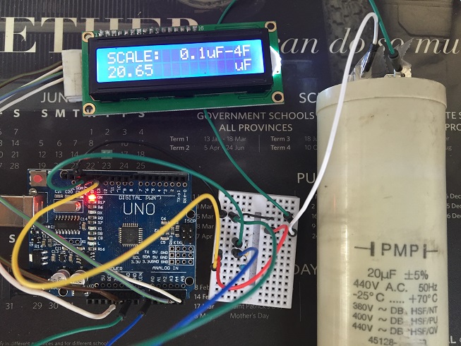

    Found some info that a faulty Capacitor can also be the cause.
    My multi meter can not test a cap so quickly threw this together with an Arduino micro controller.
    Cap spec is 20 MicroF and tester confirms it so Cap seems to be GOOD.
    Credit to ElectroNoobs
