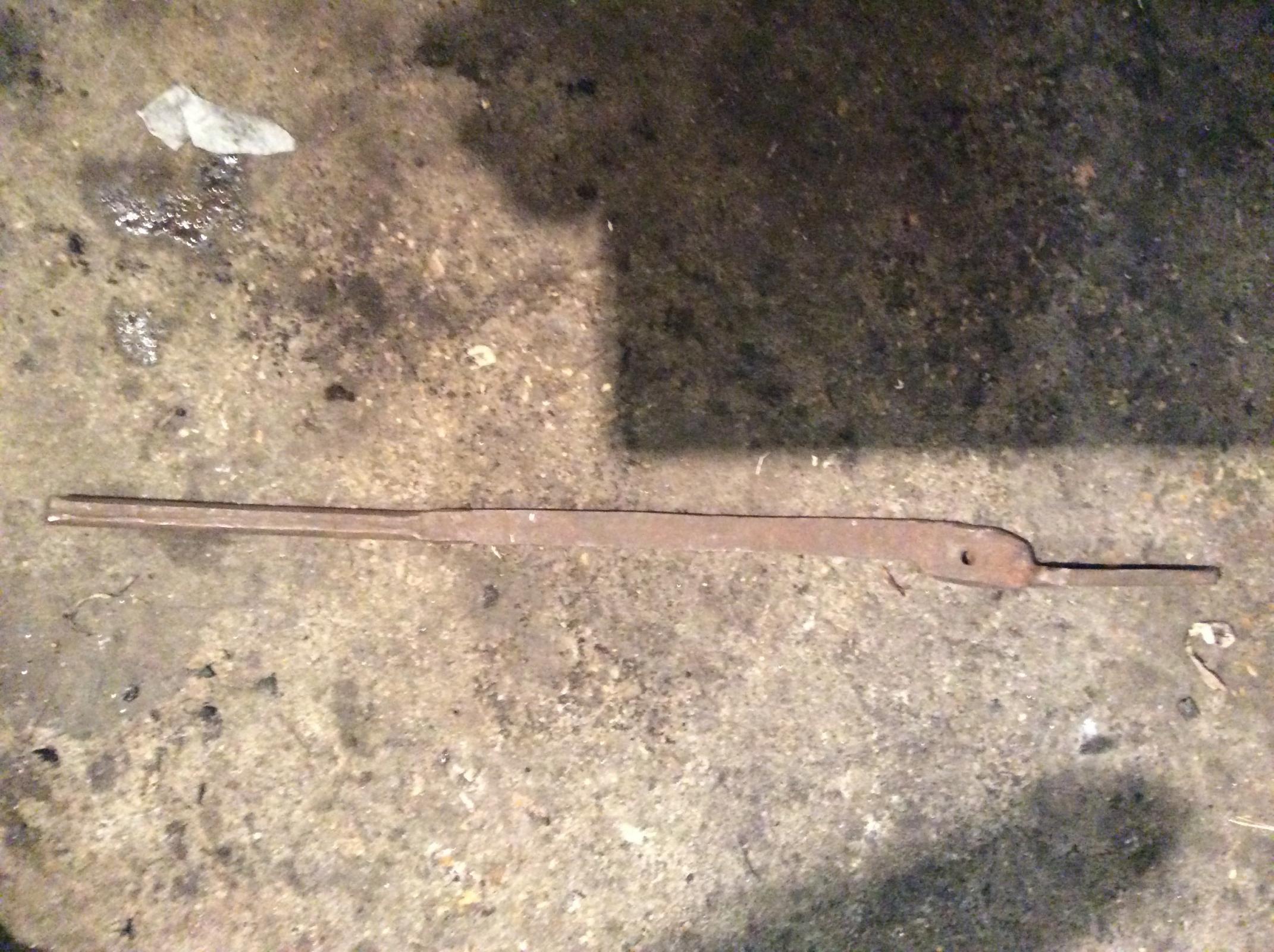

    This is half a pair of flat jaw tongs; the other half broke at the boss.
    Not needing another pair of flat jaw tongs, and having seen on Pinterest a pair of pivoting jaw tongs, I decided to make one.

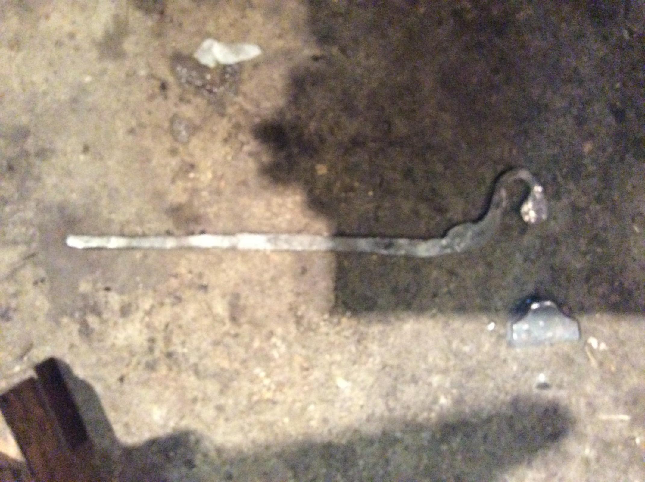

    I estimate I used 6 to 8 gallons of charcoal to do this! I am sure there are many who could do better

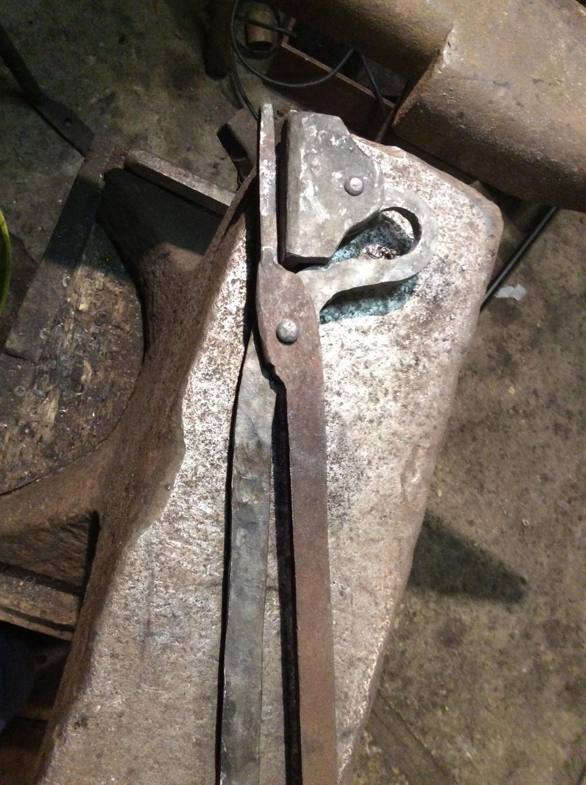

    Here is the finished product
    I understand that they are useful for holding a tanged tool, so probably tongs like these are handy for knife-makers. I have never made a knife although in my twenties, I wanted to.

    Nice reclaim Philip.
    Not being a knife maker either, the pivoting jaw does look like it would be good for griping a tang. A slight "V" grove in both jaws would also seem to me as being useful.

    Despite having done little smithing, and no plans ahead, this still interests me. We use swiveling members in rigid clamping like vises, but never seen used in a portable type tool.
