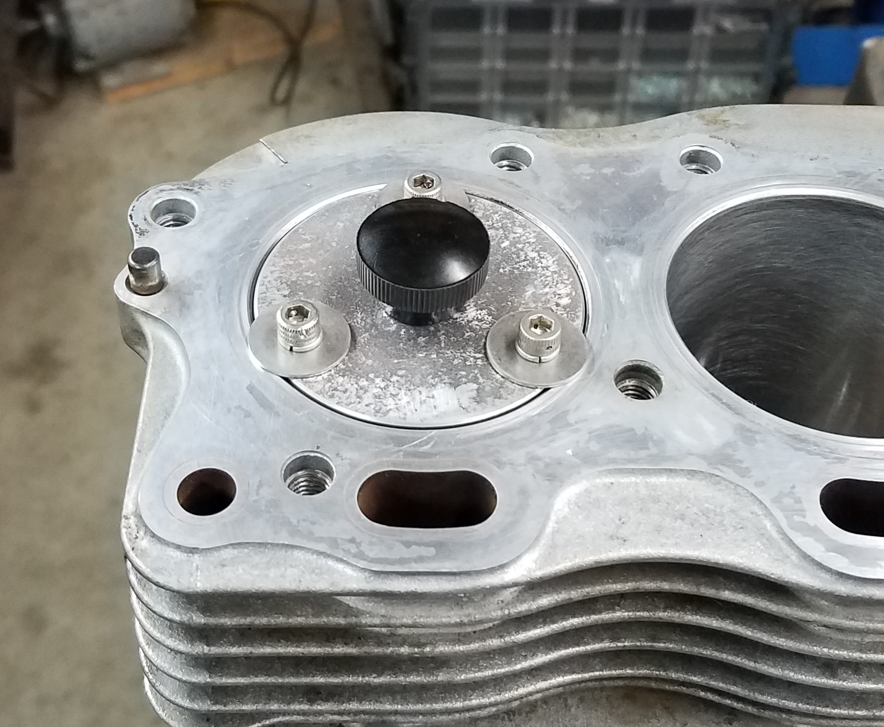

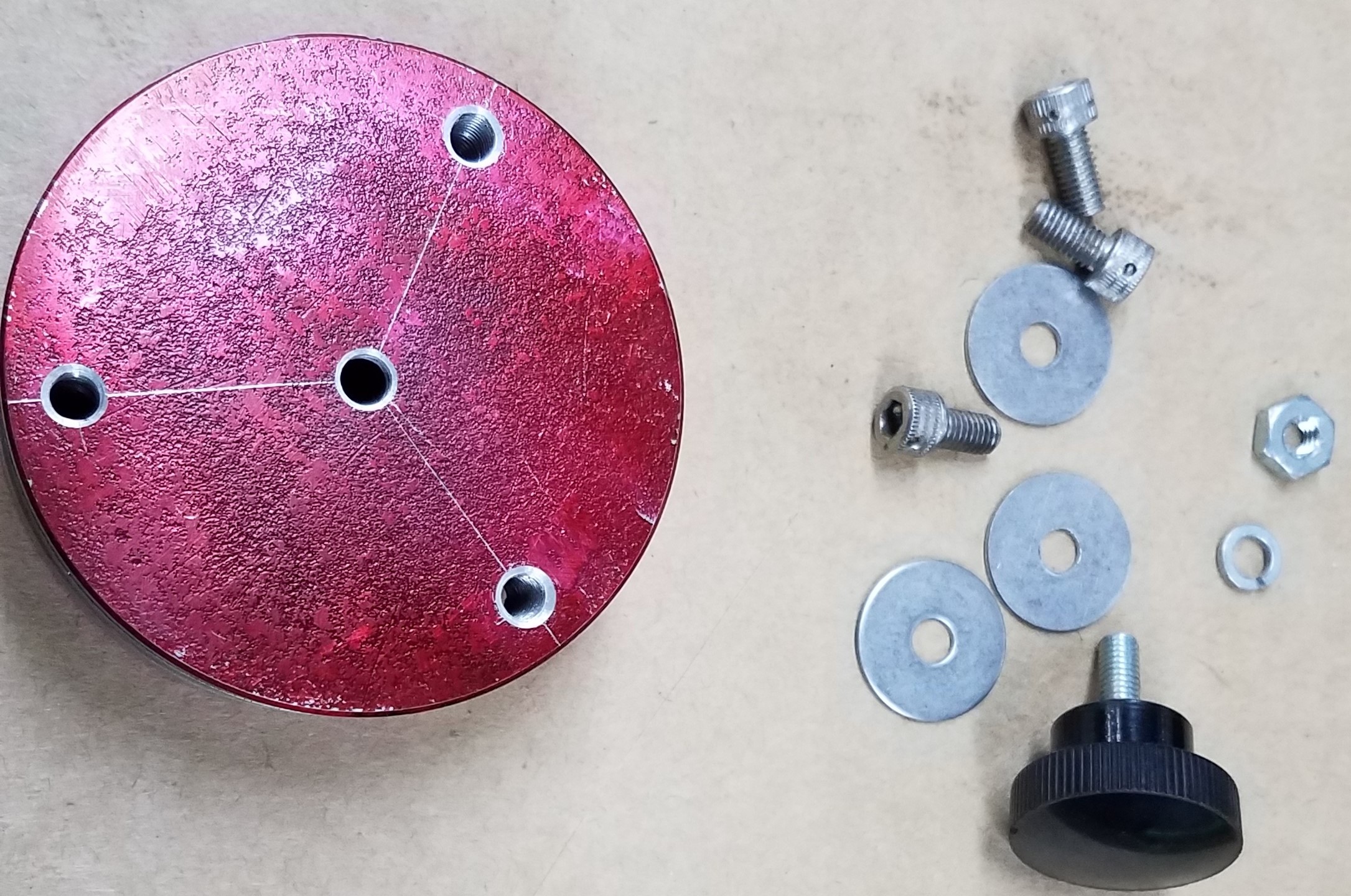

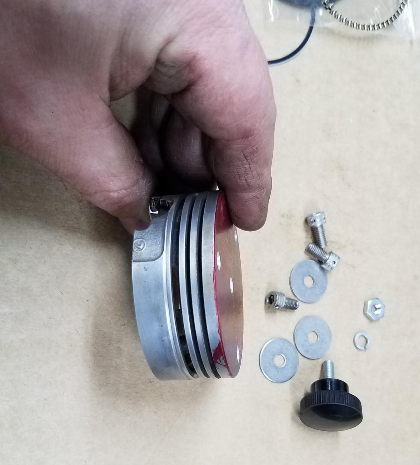

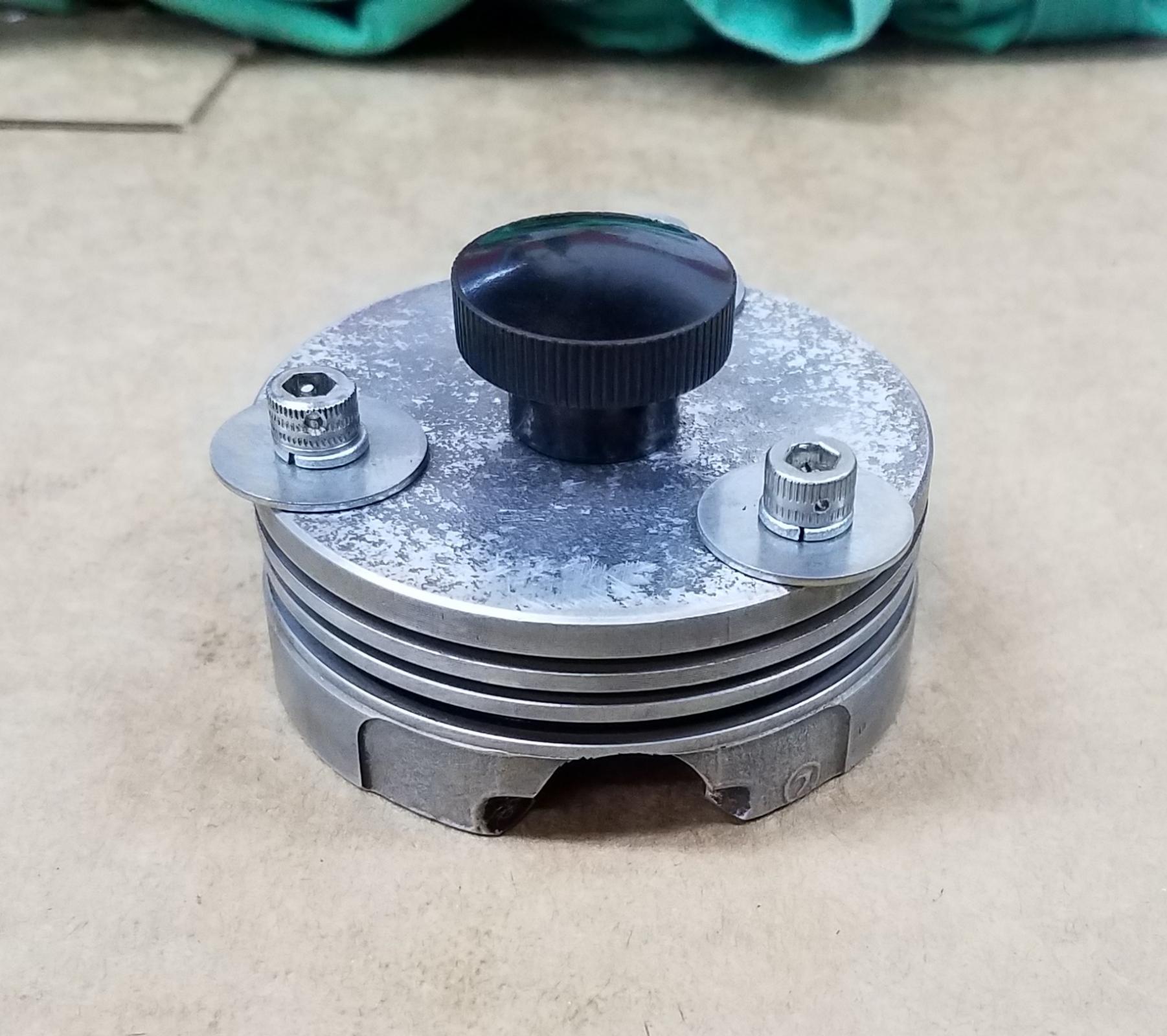

    As a side job, I rebuild engines for a local golf cart business. I generally see the same types of engines over and over, so making a tool to help speed things up is a benefit.
    When I build the engines, I always check the piston ring end gaps to make sure they aren't too tight. I have found some that are and would have been catastrophic had I installed them. Anyway, I have to push the ring down into the bore to a specified depth and measure the gap with feeler gages. Normally, I use a new piston held upside down to square the ring in the bore, but it's not exactly accurate and it is somewhat cumbersome.
    So I whipped up this little tool from a used piston to make it easier. The length between the top and bottom of the tool is within .003" all the way around, so much more accurate.
    As I get in other engine types for rebuild, I will make the same tool for each.

    Needs a little explanation? I’m presuming that you milled the bottom of the piston square to the top & now you are just pushing the rings down the cylinder equidistant & then measuring the gap after the piston is removed?

    Yes sir that is it exactly!

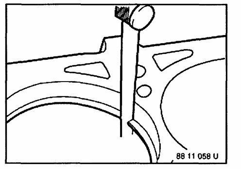

    I'm sorry, I guess I should have explained, I was just thinking that anyone who knows how to rebuild an engine, would understand. I've attached an image to help explain. I thought I had taken a photo of the ring in the cylinder, but I didn't.
    Why this tool is useful:
    To measure the end gap of a piston ring, the manufacturer will generally specify a depth into the cylinder that the ring must be placed. In this case 1" from the top.
    The usual way of doing it, in lieu of a special tool, is to turn the piston upside down and use the crown of the piston to square up the ring. I would just put a couple marks with a sharpie around the piston to establish the correct depth. The cylindricity of the piston gets the ring somewhat square to the bore, but because there is a lack of a positive stop, the piston can still rock a little in the bore and leave the ring cocked. With this tool, the ring is quite square in the bore, thus giving me a more accurate measurement of the ring end gap.
