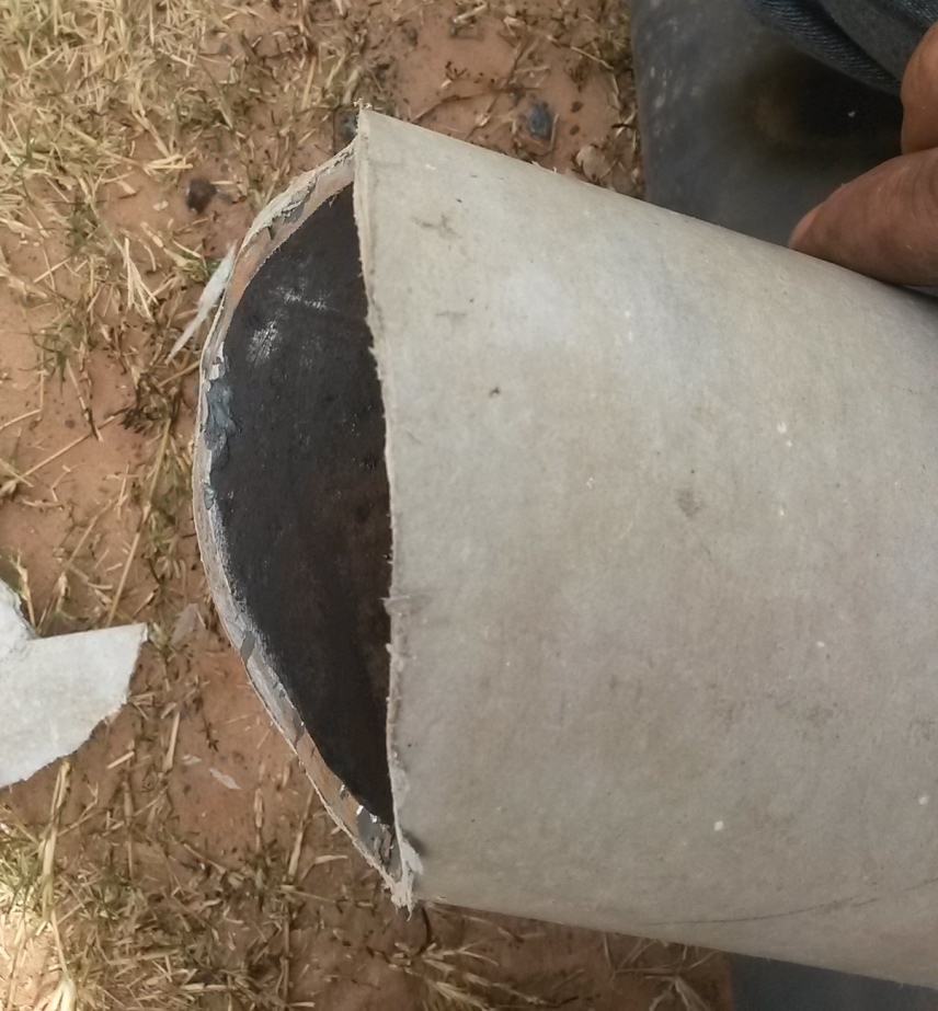

    I needed to build an A frame gantry crane this week in anticipation of the arrival of some new toys
    The A frame needed several braces to be coped to fit the legs so I laid out 1 then cut it and ground it to a good close fit. Then took an old piece of asbestos pipe wrap and cut out a template so I could reproduce the results
