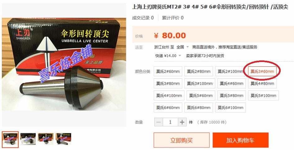

    Very simple approach to fabricate bull nose live center. I would make it the same way now when I saw what you did, but already bought one 60 mm diameter made in China and they call it umbrella live center. Thanks for sharing.
    Best regards
    LMMasterMariner
