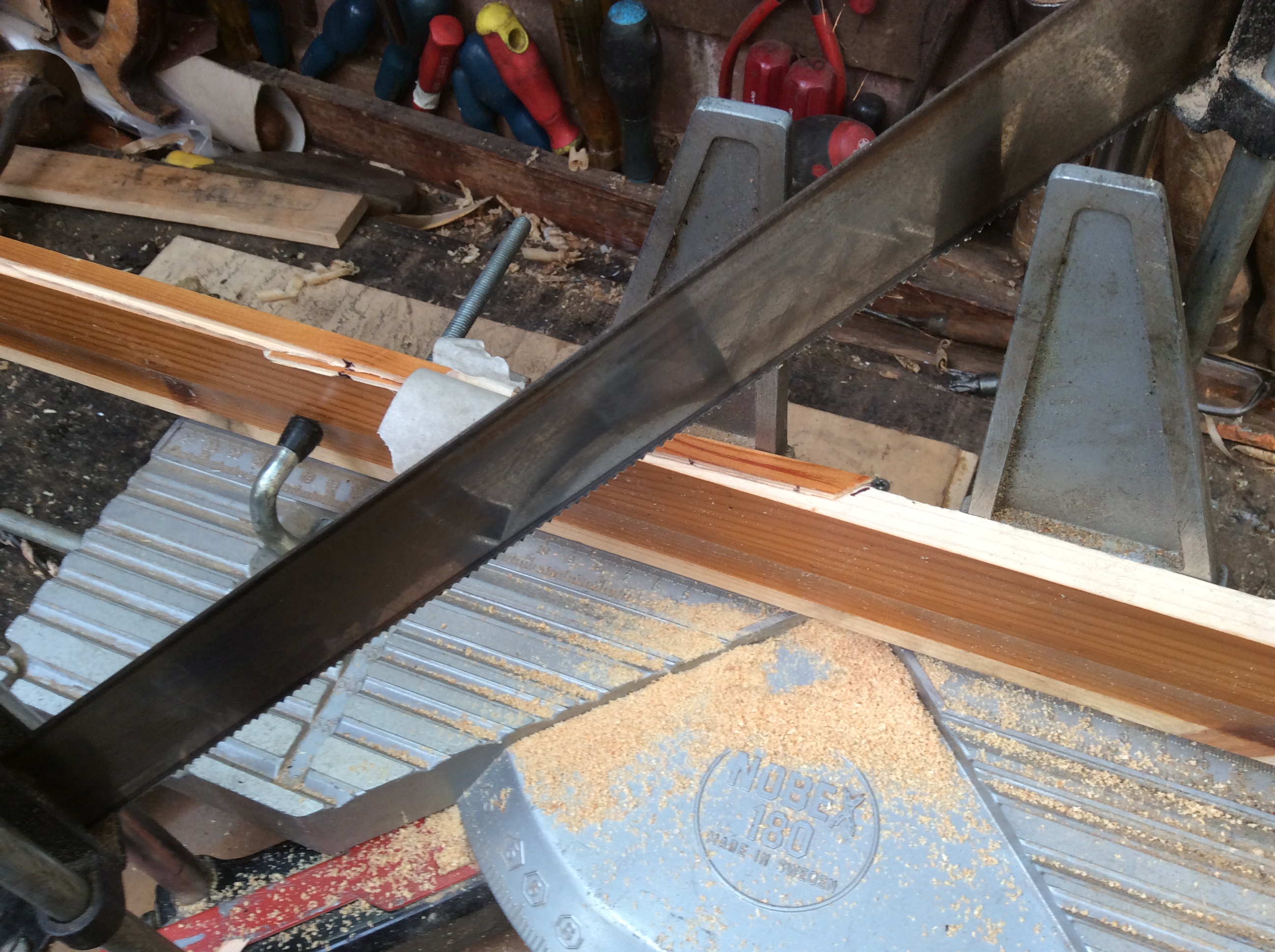

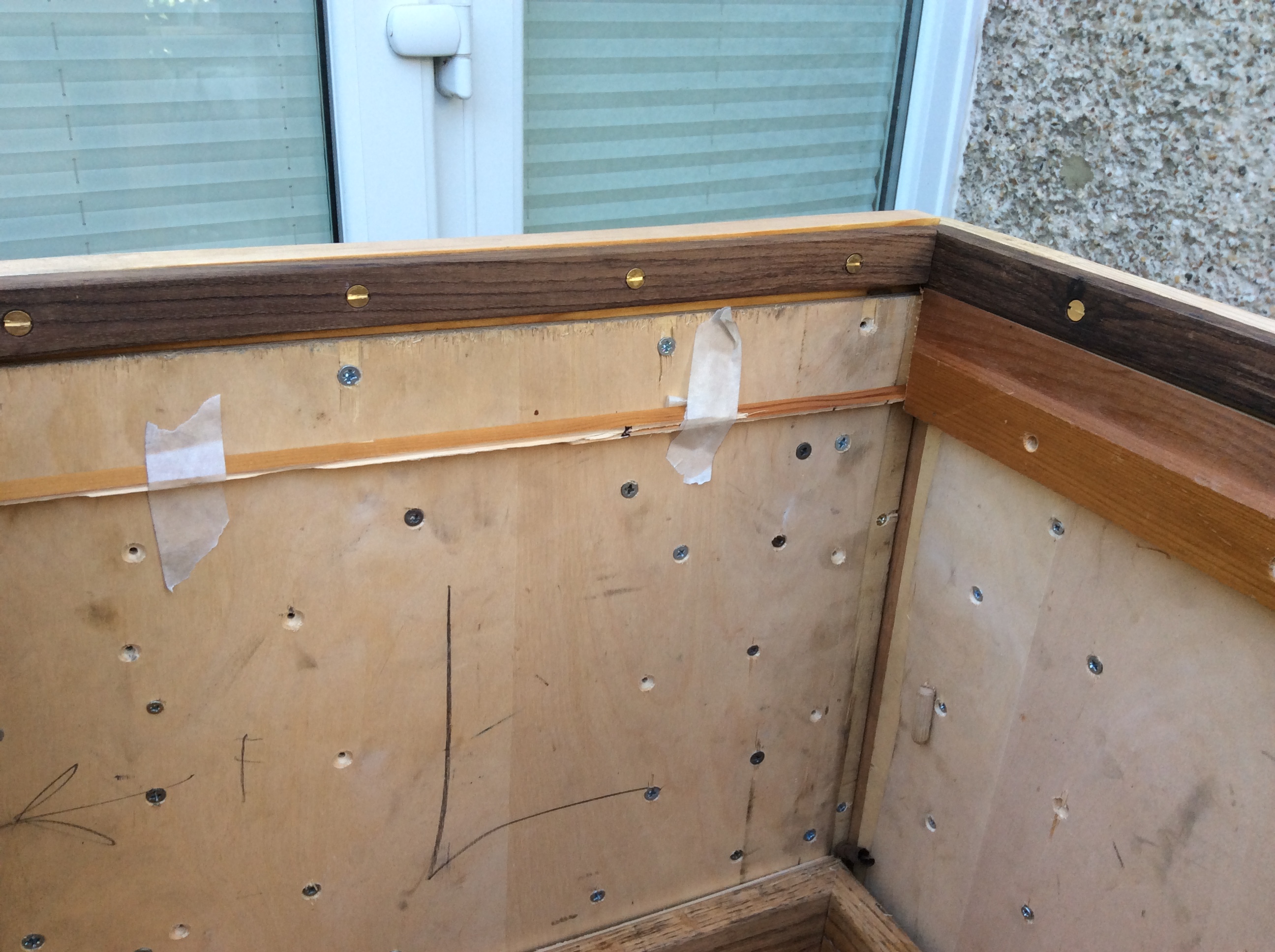

    I am lining the inside of a hope chest. The external panels are screwed from ply on the inside and the unsightly mess will be covered with tongue and groove boards. I have taped the rods to the ply to take a picture. Can you see the mark across the two rods?
    I do not know how to measure the internal dimensions accurately except by using pinch rods. These are just thin laths ( from the T & G) pointed to get inside the corners.

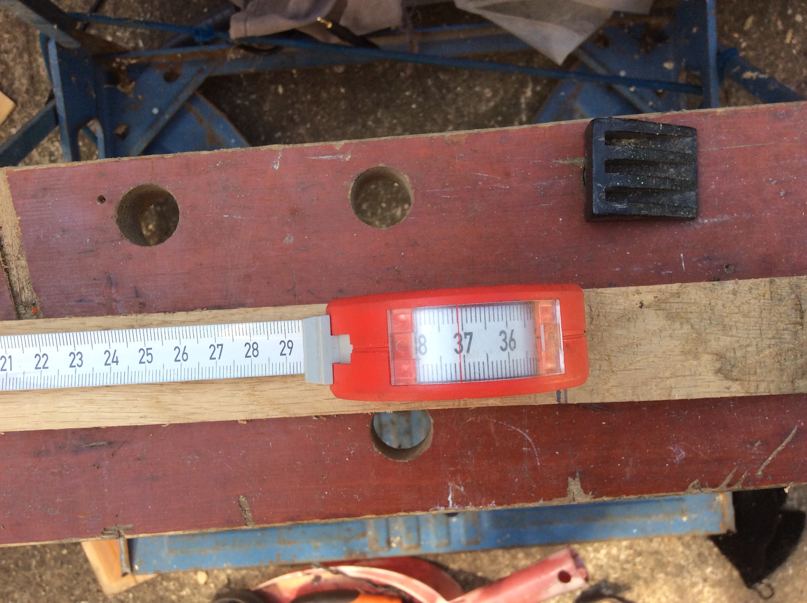

    Then the rods are transferred to the mitre saw.

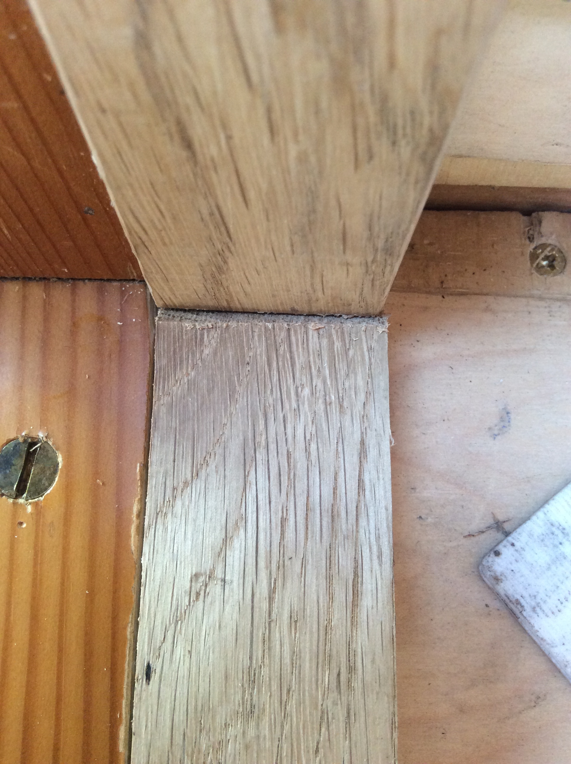

    Pinch rods supplement: internal mitres-7cf84067-6d0b-4c93-80d9-41bf9721ee1b.jpeg
    Internal mitres are usually scribed which is more difficult and this will be quite satisfactory.

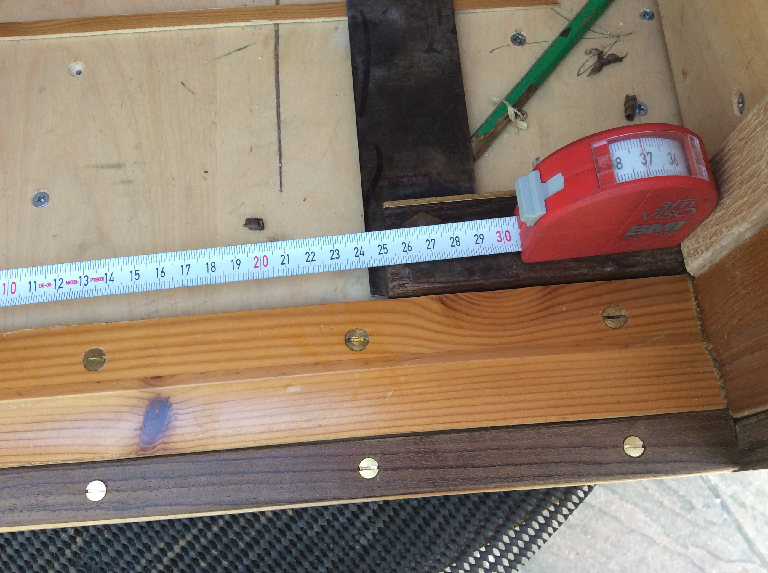

    I concede it is possible to use a tape measure.

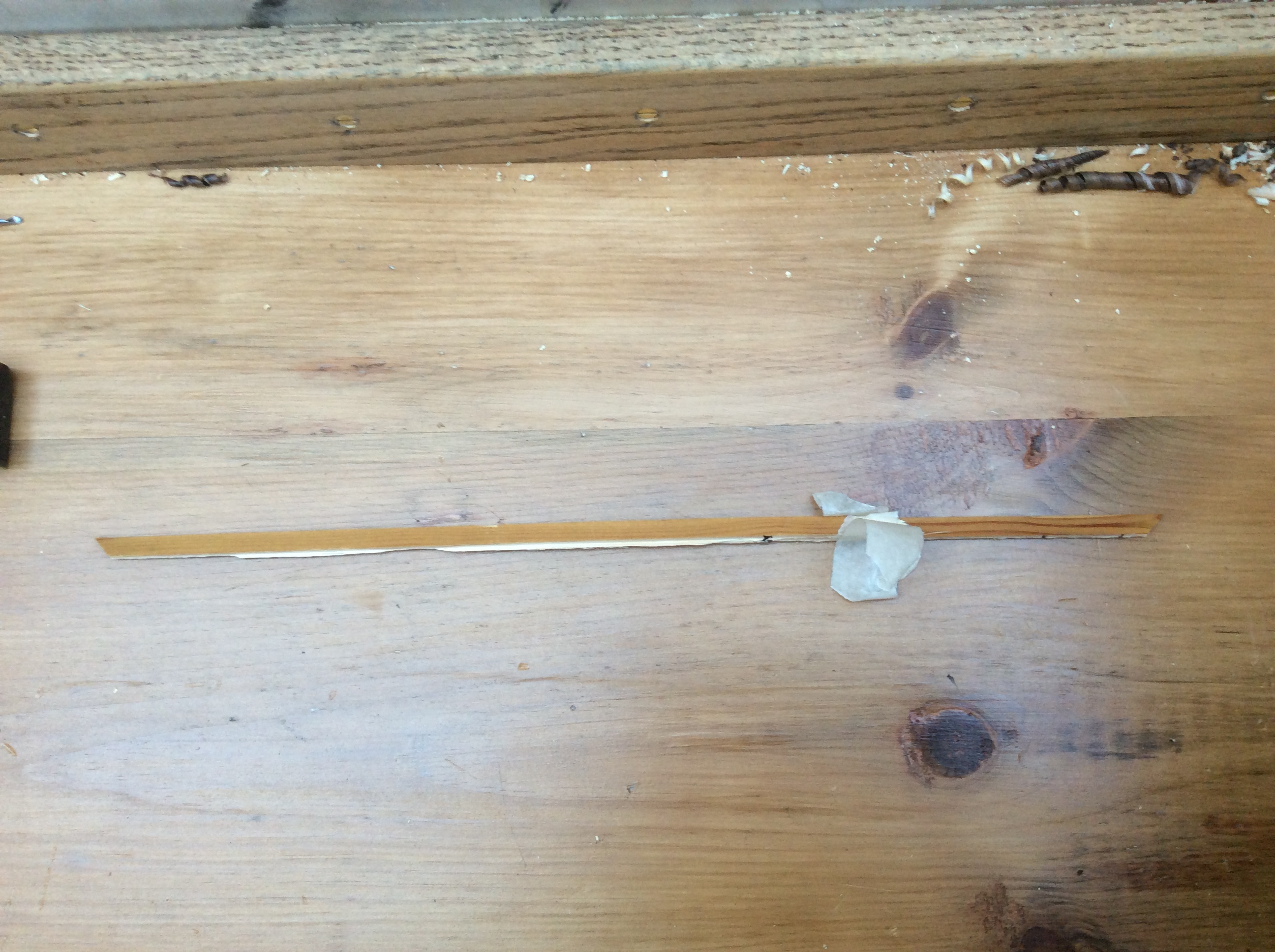

    Pinch rods supplement: internal mitres-606dbf9f-2dd3-4cc3-a749-07f0c60c23cb.jpeg
    Hmmm
