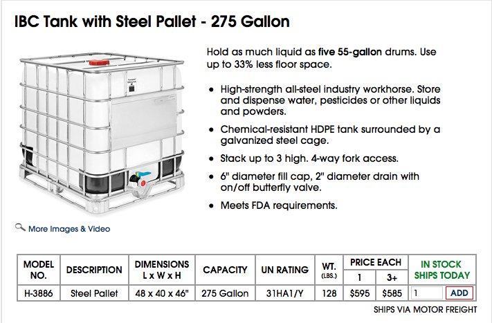

    What is that container about 250 gals or more, that is around 2000 pounds, well above a half ton.
    The container looks to be a cube about four feet on a side => ~64 ft³.
    Assuming the liquid inside about the same density as water at 62.4 lb/ft³, that's about 4000 lb or two tons.
    Regards, Marv

    Those totes are typically 275 gallon, so a bit more than 2200 pounds full of water.
