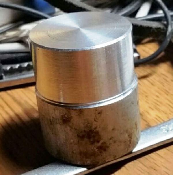

    I've just almost finished my tangential tool holder that's similar to your version. Actually it's cutting beautifully and I'm waiting for some black oxide solution to surface treat it before posting it here. Maybe one of those cutoff tool holders is next, but for now I'm loving making chips with my new tool holder. I'd heard that they were good but I didn't have a clue that they were this good and I've never made a chip before that was 3' long. Thanks for the inspiration.

    I've got mine converted to a QCTP so all I have to do is set the blade in a mount upside down and then it goes right on when I need it.
    Hey Dan, if you don't have a tangential (diamond) tool holder you should look into buying or making one. I'm truly stunned by how well the one I just made cuts and the finish on aluminum and steel is the best I've ever seen from my lathe. I think a fella could upgrade from a collection of carbide tools with a few TTHs and be out of the insert buying market to boot.
