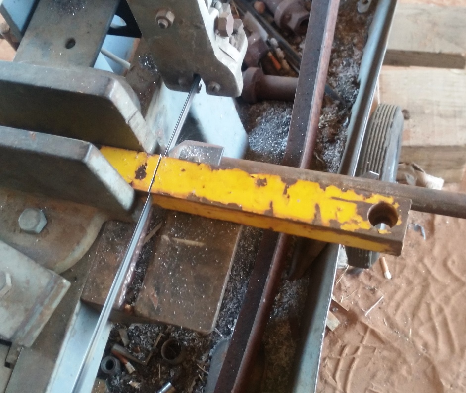

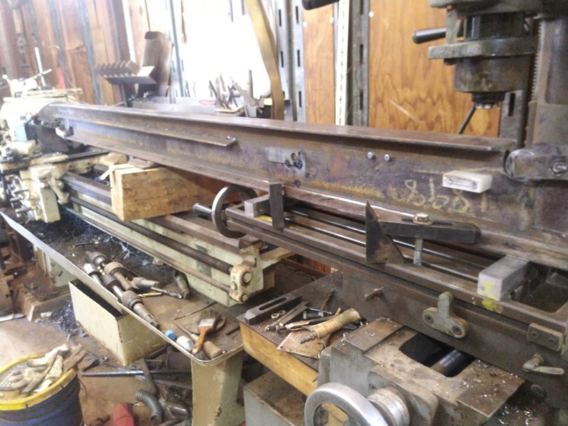

    In getting ready to mill the edge of an 8ft I beam I needed to raise it enough to clear the hand wheels of the bed and at the same time be able to maintain a reasonable tram while having to shift it along its length.

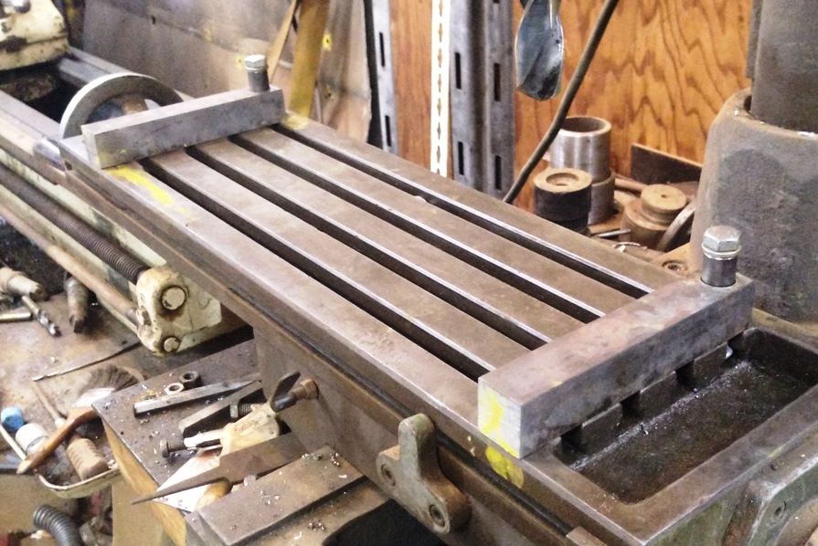

    I have a couple of 1 1/2" square bars that are key-stock quality in squareness but had been painted. First I cut a couple 7" long pieces removed the paint then cut 2 pieces of 3/4 cold roll round stock and drilled them to 1/2" on the lathe then loosely bolted these to thew mill table
    After placing the I beam on the blocks I trammed it to the table by tapping on it until it was against both pins then tightened the bolts to keep the tramming pins and the riser blocks in place

    Thes riser blocks with tramming pins worked exceptionally well since I had a pair of 8 ft long beams, I needed to mill about 1/4" off the entire length of 1 flange Nothing critical dimension wise, as long as they were somewhere within .010" to .020" over the length was fine with me. I didn't want to torch or plasma the flanges off since the heat would have caused warpage and that much grinding is one of those "I ain't the one" tasks.
