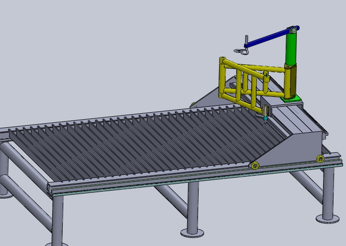

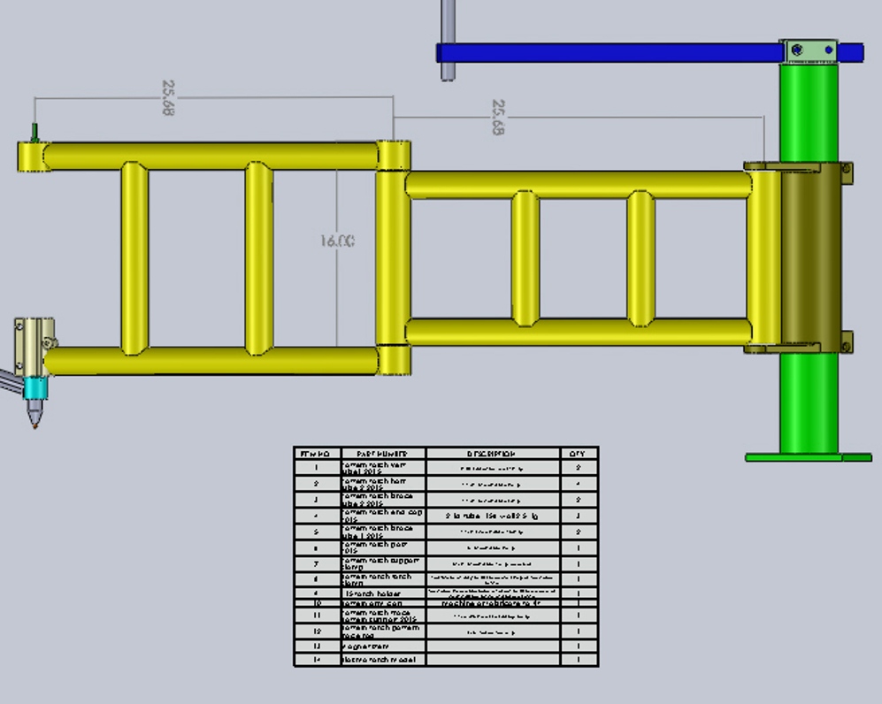

    This project is a pretty much forgotten way to duplicating parts with a cutting torch or a plasma now that CNC has become the in word of the day.
    Never the less I miss my old Victor DC2400 with its magnetic knurled stylus that would cut out any shape I could possibly conceive as long as I made my templets correctly.
    My whole reason for building the tubing/pipe holder for my Craftsman lathe was to make this project.
    This is the cad rendering of what I am building.

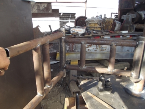

    Starting off with a plate laid on top of 1 of my handy work stands I began placing the pipes into position
    One of the tools I frequently use for projects like this is my bander. I find that using a steel band to hold things together is 10 times faster than tacking a lot of scraps to a plate to make a jig if I am only making a one-off When fabricating multiples then a fit up fixture if the only way to go.
    The steel banding also makes it easier to pull something square when you have half a dozen or so loose parts to contend with.

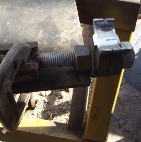

    And we hardly ever think of the simple innocuous jack screw as a real homemade tool since we mostly just grab a nut and a bolt with a short length of pipe to force the final piece to where we need it
    No matter how close parts are cut it always seams to me at least that one corner needs a bit of prodding to get it just right. in my 150 odd years of doing this kind of stuff (well 50 odd at least) I bet I have used a million of these simple little tools. I actually saw some for sale at a machinist supply once and my question was WHY?

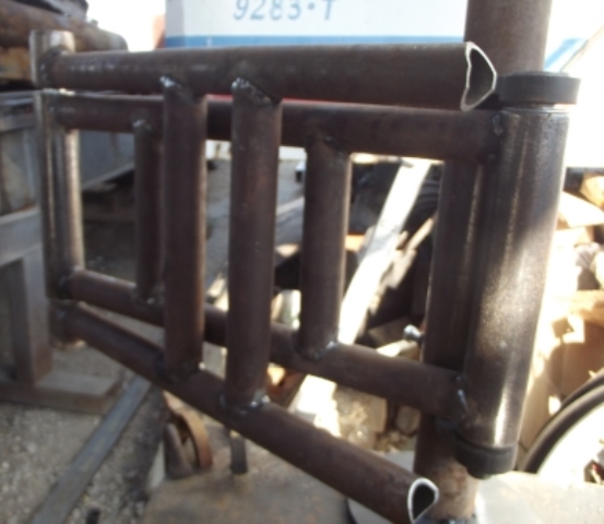

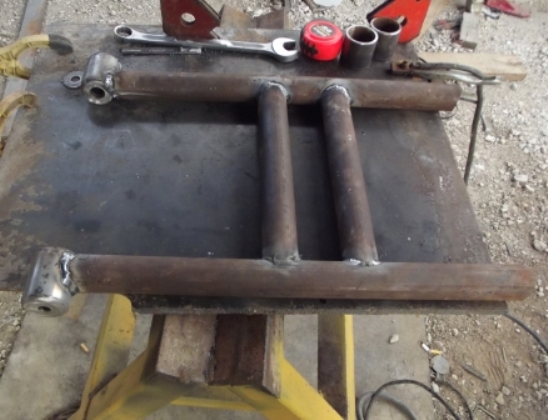

    First arm fabricated ready for clean up

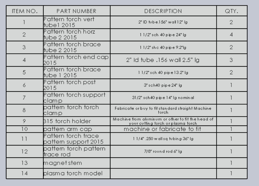

    Hello Frank S,
    It would be nice to have some dimensions posted.
    I am thinking of all the things I need/want to use this for!
    D.King
    Nice and simple often makes the most useful tools.
    Don't believe me? Just look at a hammer sometime.........
    11,723
    2,234
    Thanked 9,226 Times in 4,403 Posts
    d.king ordinarily I just think up a probable size that I want then start hacking out what I want. In this case though I want to be able to burn 36" diameter circles and or parts up to 60" long since my old Victor DC2400 was very limited in the size department I am making this unit quite a bit larger. the arms will be about 25+" long at the bearing centers their separation distance is not at all critical but I decided on the primary arm to be 12" tall the torch arm or secondary arm will have to be sized to pivot around the primary
    I am making my main post out of 3" oilfield pipe because that is what I had on hand also it will be much more stable than the factory torch was with its little 1 1/2" OD stem
    these may help you out
    Pantogragh style tracing torch project-pattern-torch-main-swing-arm-2015-text.jpg
    Pantogragh style tracing torch project-pattern-torch-main-swing-arm-2015-text2.jpg
    just click on the pictures for a full size view
    Eventually after I get it built I will be making a burn table for it and most probably do like I did on the one I took to Kuwait and left there. I will mount the torch on a gantry that travels the length of the burn table. Doing that even allows for converting to a CNC burn table later on if I desired
    this is what I have in mind with the burn table I will be able to place a 4x8 sheet on it and move the torch anywhere over the sheet I found on my old one that it really made things easy to make multiples of the same parts or change out the templets andcut up a whole sheet without moving it

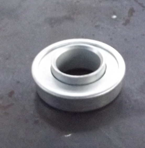

    For the bearings temporarily I will be using 2" OD 1" ID stamped flanged ball bearings the same ones I used in my rough terrain welding cart and my torch cart mod. these are not the best quality for the job but I have an abundant supply of them, they are also less than $2.00 each on Ebay. Later I will change them out for true angular contact bearings.

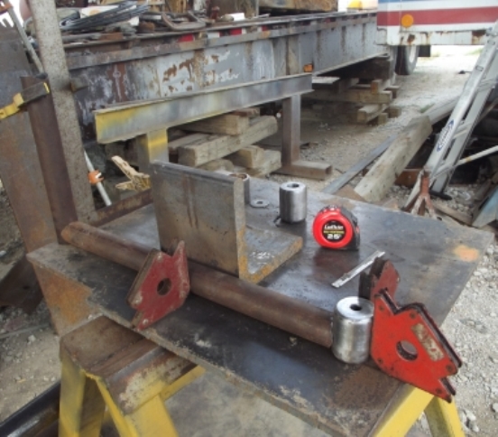

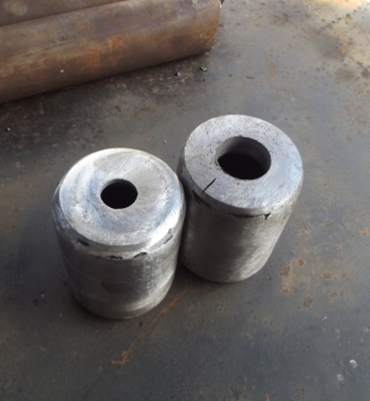

    A little time today to make some progress on my pattern torch

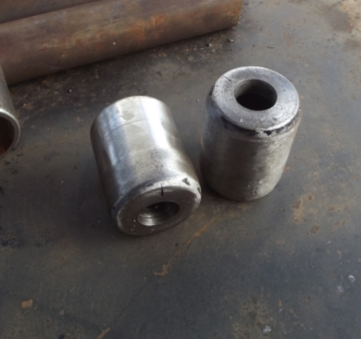

    I had welded 1/2" thick ends to teh short pipe pieces then chucked them in the lathe and did a minimum clean up on them then with a 5/8 bit in the tail stock I drilled all the way through
    then I used a " drill I drilled all the way through 1 part then on the second part I stopped about 1/8" short of going all the way through the reason for this will be explained latter
    A few items for helping hands to hold the parts square to each other
    the completed arm except for the ends that will eventually hold a drive motor and what ever torch I use

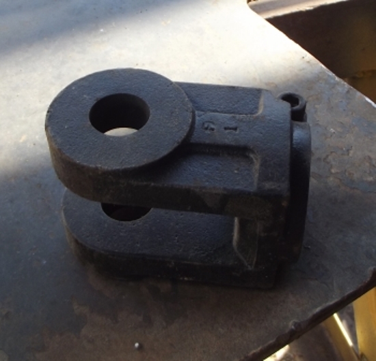

    I found this cylinder rod clevis lurking in one of my parts bins that looked like it was begging to be used. Ok I kne wit was made of malleable iron but the stuff takes to a cutting torch well enough and welds just fine besides it meant I didn't have to cut out and drill a couple of parts just cut it up and grind the ends to fit my mounting post collar.

    these are the bearings I am using they will be more than adequate for this machine and they only cost about a buck each

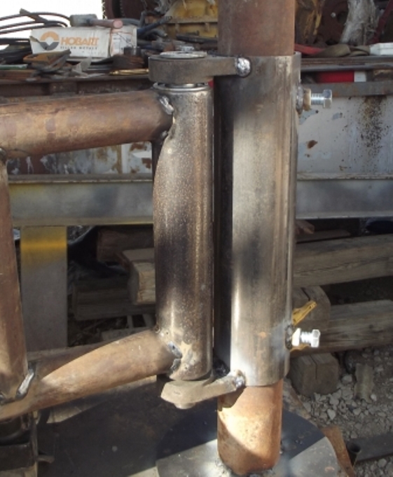

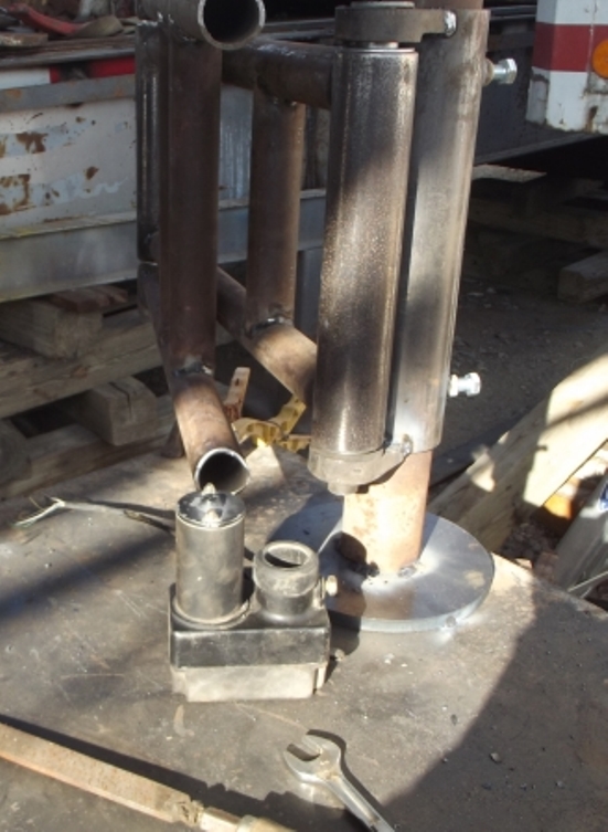

    2 7/8" OD oilfield tubing and 3" ID pipe for the post and collar the set bolts are 1/2" gr 5 with flanged nuts welded to the collar the picture doesn't show but there are 4 of these welded to the collar
