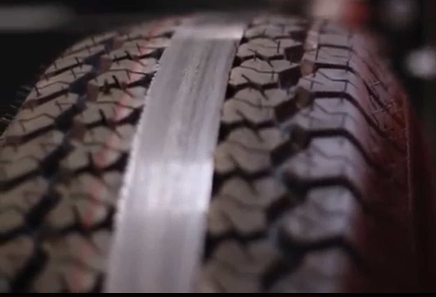

    Interesting; a search suggests that this is a Woodmizer PD200 pallet-hawg. Says they’re made in USA and start around $11,000.
    Here’s a pic of the blade drive:

    OSHA doesn't approve machinery, they give guidelines for safety, it's up to the manufacturer and the end user to assure safe equipment and safety when working with equipment. Proper guarding on this machine would be the "tube" the blade runs through on the top and the "reach" from the operator position - edge of table to the blade, every inch reduces the risk of a cut injury. Two man operation to eliminate the need for reaching near the blade is one of the measures also. Procedure and oversight for following the procedure assure safety. Many of the higher speed band saw type cutters have blade brakes so if the blade does go, it doesn't shoot out of the cut area. My biggest problem with this one is that they're creating cellulose and metal dust with no dust masks. They're probably just tired of wearing them when they're not at work!

    As a 30 year employee at an OSHA Sharp certified facility I know very well what OSHA will take issue with.
    The blade is within reach and the operators are placing their hands very close to it while in operation.
    I don't see an way that machine would pass muster without some sort of mechanical feed to push the pallets through.
    I'll guarantee the company in the video has never had their insurer drop by for a visit, and I'll bet the manufacturers lawyers have no idea of it's existence.

    The infeed guy does, the outfeed guy should.
    Imagine someone who's got Personal Issues ie broken heart or hungover etc
    There is nothing that would pull them into the blade; They'd have to force themselves into the blade and keep pushing all the way through.
    Quote Originally Posted by Unkle Fuzzy View Post
    I feel like having something pulling material into the blade would be more dangerous than the way this is designed. The only thing that looks off about this is the exit feed guy reaching to the blade to grab the little chunks of 4x4. He should have used a stick for that, and the designer could have intrinsically required that if the outfeed table was about a foot longer.
