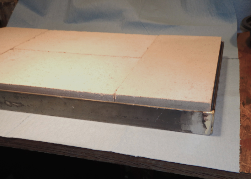

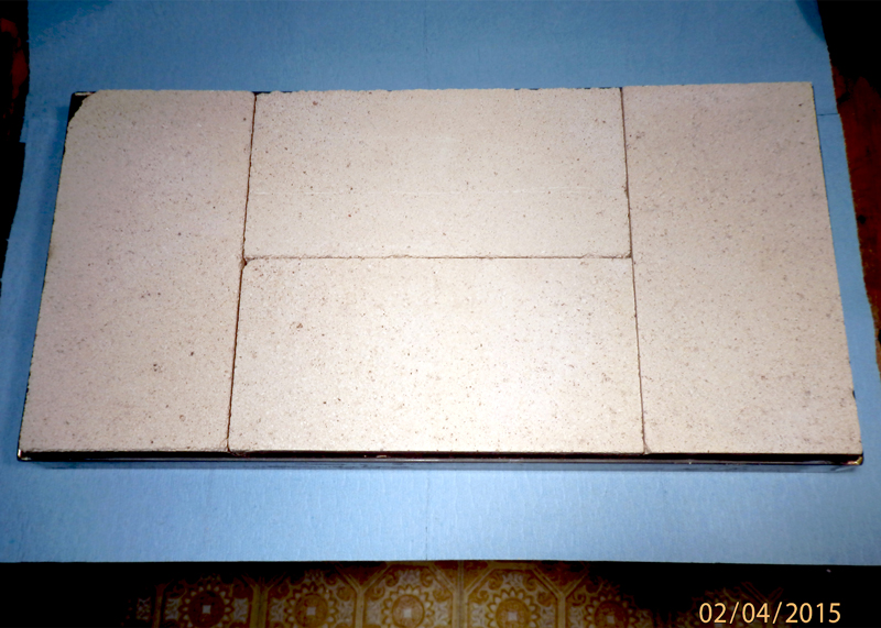

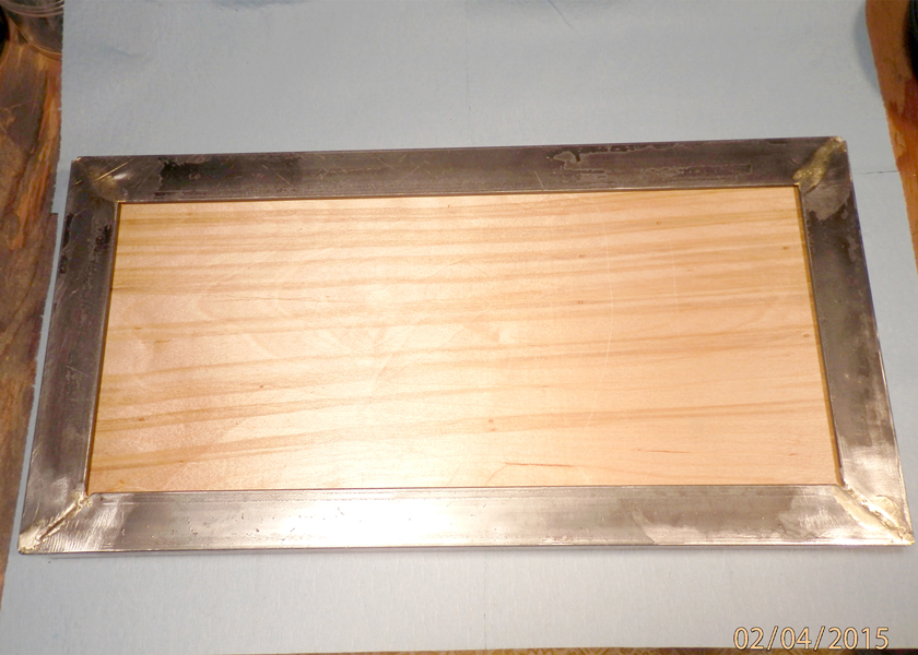

    While building it I decided that I wanted a small fire brick table that was (semi) portable and had some fireplace bricks I picked up for $2 apiece a while back. So with some scrap 3/4" Angle Iron, a piece of 1/4" ply and a little construction glue I put this together. I've thought since to put some folding legs on it but don't use it often, so it hasn't been a priority. The nice thing is it stands on end up behind the Caddy when it's stored. A bit heavy but works!
    Oxy/Map Tool Caddy & Fire Table-fire-table1web.jpg Oxy/Map Tool Caddy & Fire Table-fire-table2web.jpgOxy/Map Tool Caddy & Fire Table-fire-table3web.jpg
    Over all it fits my need and was a fun useful project. Hope it helps others on this great forum also.
