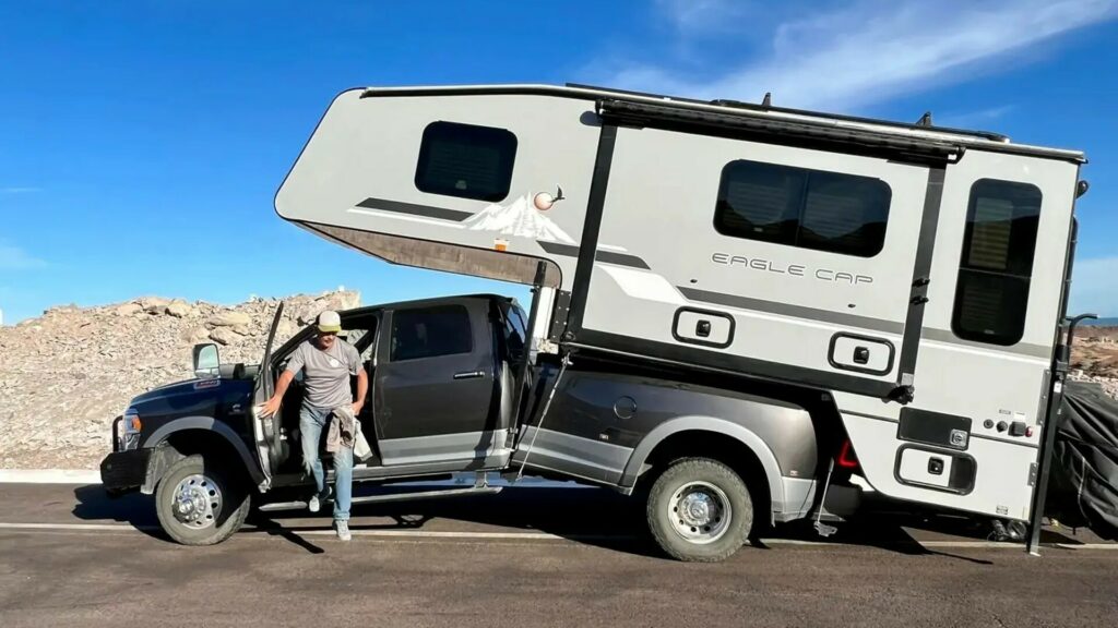

    I know this guy...
    Overloaded flatbed trailer snapped in half - GIF-ram-snapped-1-1-1024x576.jpg
