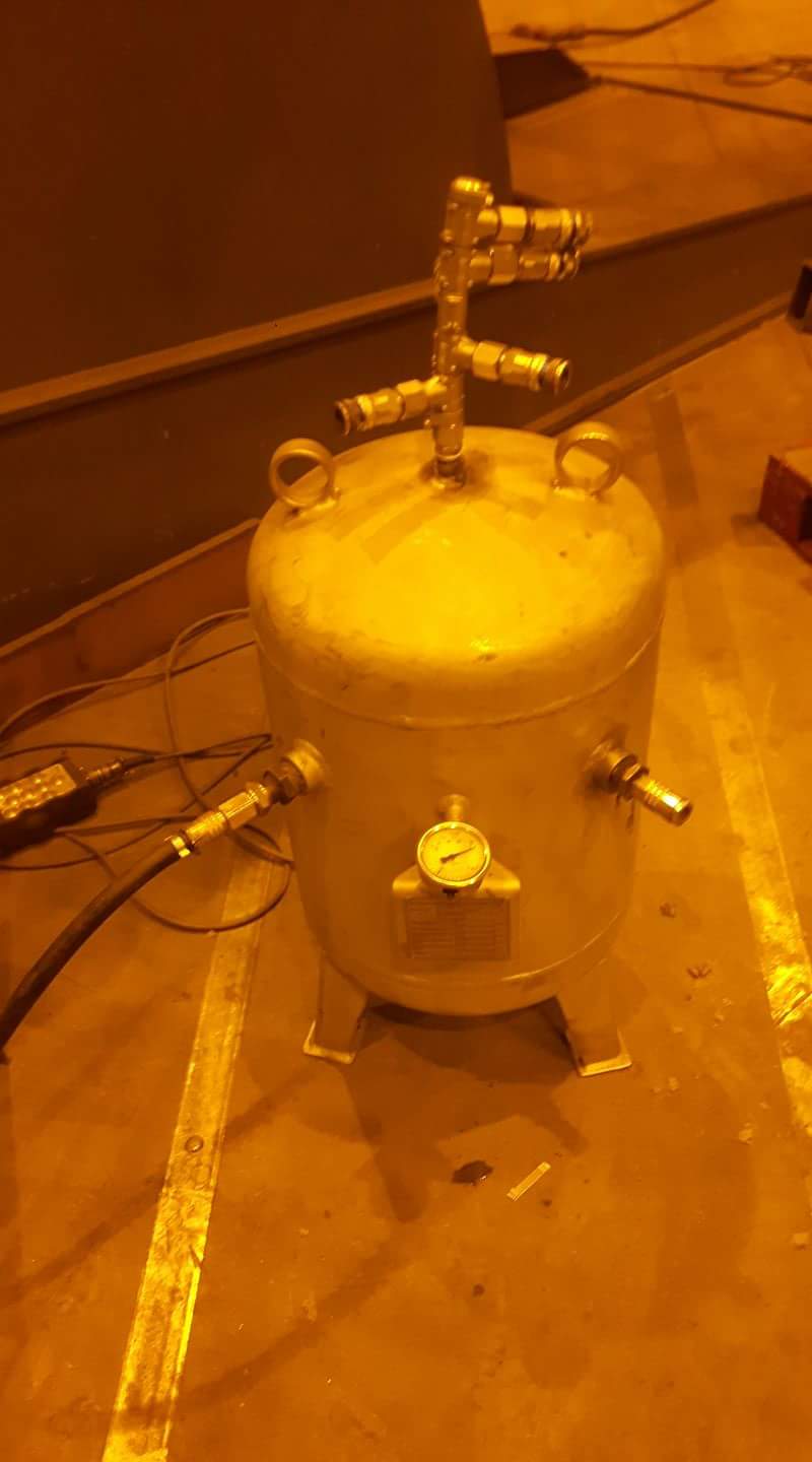

    Jun 2016
    Jyväskylä Finland
    832
    558
    Thanked 1,877 Times in 508 Posts
    Tuomas's Tools
    Tuomas,
    The extra volume in the tube is like having a small buffer tank near to the tool being used. The larger the tube the greater the benefit.
    Yep. We use these containers when there's multiple persons working at the same spot.
    When welding you usually don't need to use very big tools. Pneumatic hammer for removing splatters and slag, small grinder and rotary tool. Those doesn't reguire very big airflow
    5 persons can easily use one wall connection when using that extra container. ( more likely they don't use pneumatic tools at the same time, couple are allways welding)
