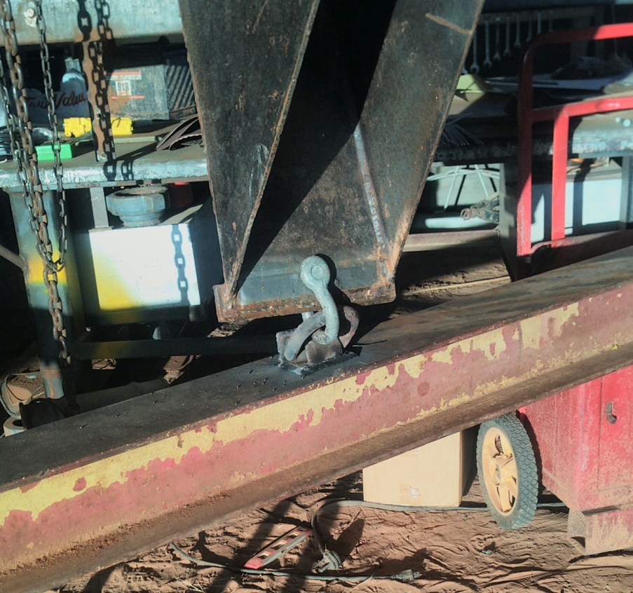

    I used my homemade 12" bucket on my backhoe with a hole cut in it near the cutting edge. I have a cargo D ring welded in the center of the top of the beam with a clevis I attached it to the bucket Set the outriggers of the backhoe to lift it as high as possible and the loader bucket down just enough to stabilize it Raised the beam as high as the backhoe could go then sitting in the backhoe with the end of a rope I had hooked on 1 end I rotated the beam enough so the rollers would align with the rails then curled the bucked in until the beam was resting in place and the shackles were freed disconnected and removed the backhoe. About half an hour to hang it but 2 days to build it
    I hung the pipe rails much the same way with the back hoe then up the ladders to clamp them in place A string line stretched end for end used 12" C clamp to pull the pipe rails straight 1 mounting tab at a time A hose clamp around the pipes to hold 1 end of a tape measure using a ladder at both pipes a lot of climbing up and down until I had the ends parallel used maybe 6 clamps on each pipe . Welded 1 end of both of them then using the F150 with scaffolding I could work 3 mounting tabs then move to the next About 3 days to get the rails made and welded in place I wouldn't know what to do with a helper except for have them fetch things for me. Would have come in handy though when measuring the distance between the beams LOL.

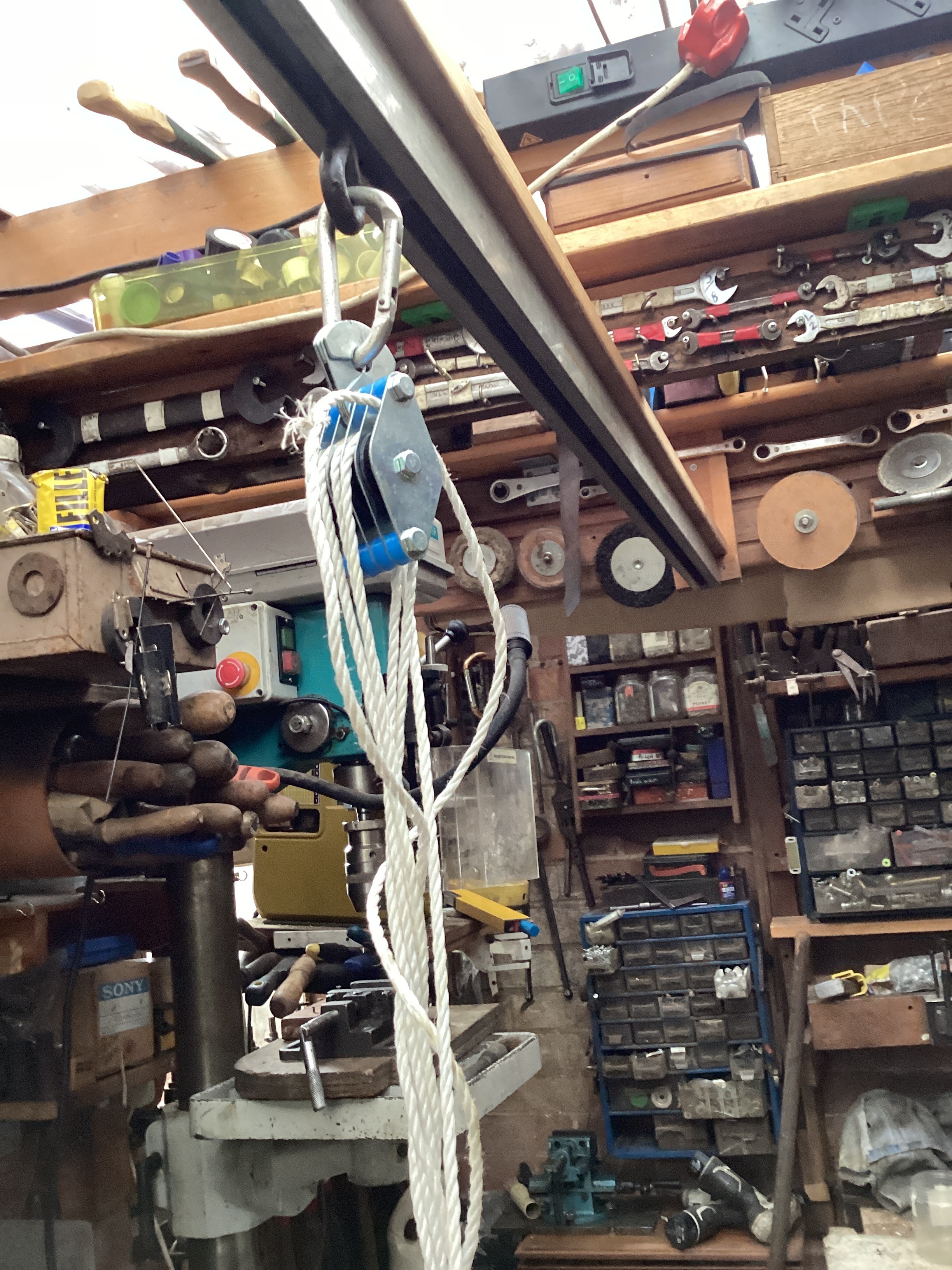

    As it happens, Frank, I have just made up a workshop crane, for my 8’ x 6’ shed! I have a question for forum members. The new block & tackle is just to raise my compound table from its shelf onto the bench drill. The line supplied is 3-ply nylon and I don’t see how it can be used, since it twists, of course. Can I expect to remedy the twist by stretching the line against the twist, or have I sufficient grounds for a refund, doyouthink?overhead bridge crane-image.jpg
