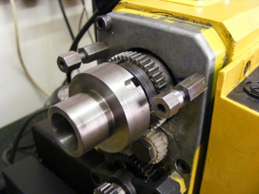

    1) Application of "Pure torque" at the spindle thru a (ex-plumbing brass adapter) spider,
    something like this one, but with a hex end outwards:
    Outboard motor for lathe threading? Really? Ideas welcome!-spindle-spider.jpg

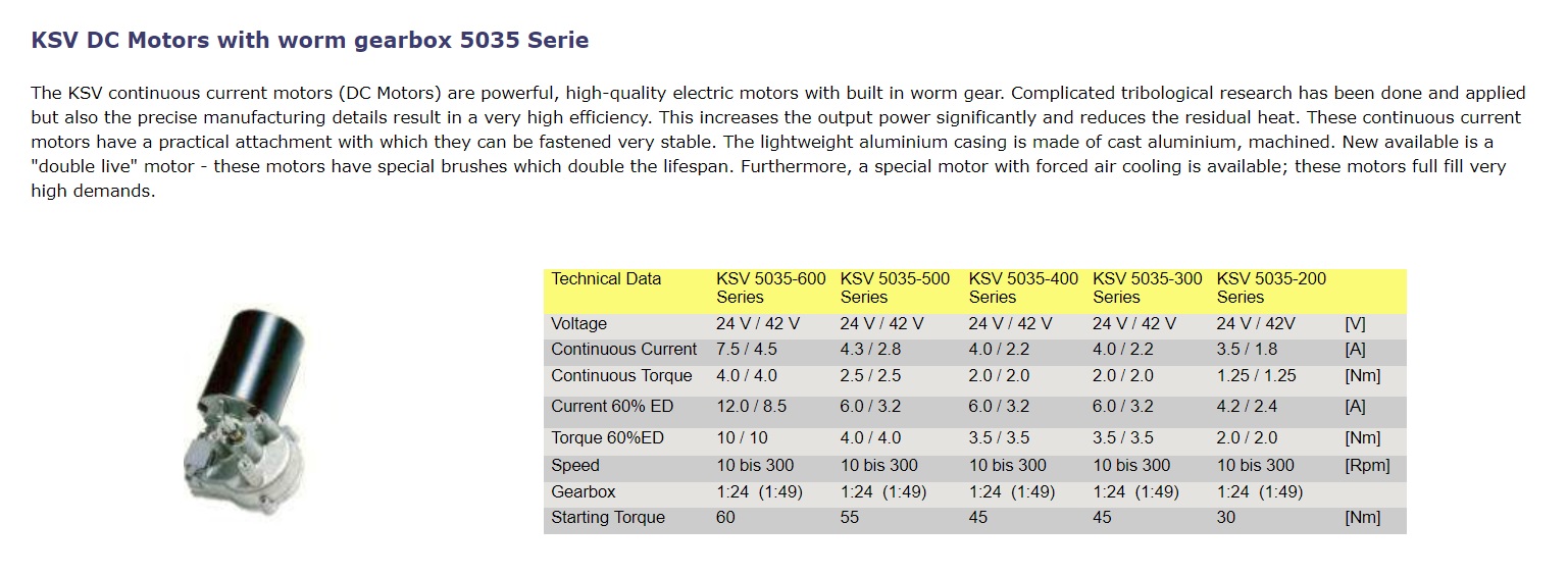

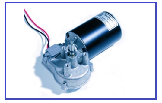

    2) Simple spacer (like the above hex spacers) attachment of KSV 5035, 600 series 48 VDC worm motor
    Outboard motor for lathe threading? Really? Ideas welcome!-ksv-5035.jpg (black motor can dia 90 mm by 100 mm length)
    attached via a plate and torque arm to the headstock end, with a simple hex socket attached to the output axle.
    Outboard motor for lathe threading? Really? Ideas welcome!-ankarsrum-ksv-5035-datasheet.jpg

    My first comment is that you seem to indicate that the motor assembly would be mounted on studs occupying the threaded holes used by the gearbox cover screws. In fact your second picture is I think taken from my website (mikesworkshop.weebly.com).
    Bearing in mind that the motor will have to project further back to proposed hexagonal drive coupling then I doubt whether the studs would be sufficiently strong and rigid to cope with the high torque that would be generated by the motor. I think you would have to bolt the motor onto a substantial bracket that was itself firmly attached to the headstock casting. This should not be too difficult to arrange.

    Thanks, Mike and Olderdan for pitching in - and you're absolutely right, Mike - I "borrowed" (w/o asking - pls forgive me)
    the pic from you (and also the very good idea for a lathe ammeter, which I made simpler and cheaper in this post:

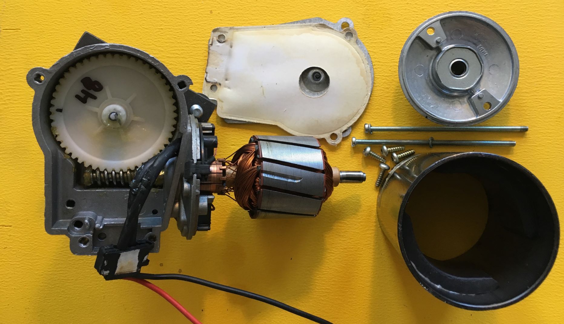

    Intermediate plate attachment: In my middle pic of the worm drive, you clearly see the three M6 threaded studs 120 deg apart around the output axle.
    I'm thinking the drive bolted to an 12 mm Al plate with the M6 SHCS recessed in it, and from the other side:
    the 12 mm (gear cover screw) hex studs coming into these plate holes, thus fixing it axially (and laterally).
    Then some longer arm to this Al plate will in its other end be fixed to "a convenient, rigid place for torque relief", so that the studs won't bend or twist.
    This is my "working hypothesis" as of now - recovering in the hotel room from a day out in +32 deg C and the scorching sun in Split, Croatia.
    @Olderdan: You're right regarding the 49:1 plastic wheel. It's the weakest point, especially as the drive also have to work in reverse,
    thus forcing the wheel up against the wimpy tin lid, instead of down against the output end ball bearing.
    This will eventually be taken care of thru some serious axial bearing.
    Now - I know I'm privileged enuff to be having at least half a dozen of these KSV 5035 mothers,
    (salvaged from heavy duty office table pillars, a 150 kg load at 2 ips lift verified for a 13 mm 3-start screw in a Delrin block)
    so I've already tried them out in different applications, and have yet to break one:
    Worst case scenario: braked until locked output with 39ish VDC from 3 series coupled SLA batteries.
    No shearing, fraying or other damage noted of the 10 mm thick Delrin gear/key/ axle combo noticed,
    just the ammeter maxing out at >20 A. So I doubt my threading/ worm- & hobcutting in my 7 x 14 will tax the drive harder than that...

    Not sure how you intend to fix the hexagonal end to the spindle. If it is screwed on the then there would be potential problems running the motor in reverse. Reversing the motor is often used when threading metric thred on an imperial machine and vice versa. Possibly some sort of locking pin to prevent the hex end unscrewing would solve this.

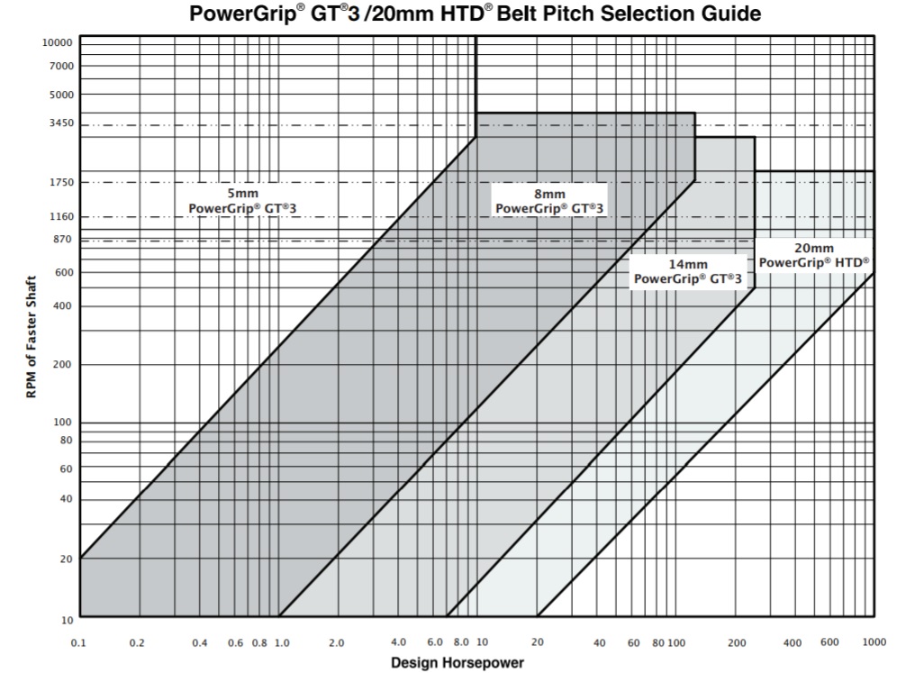

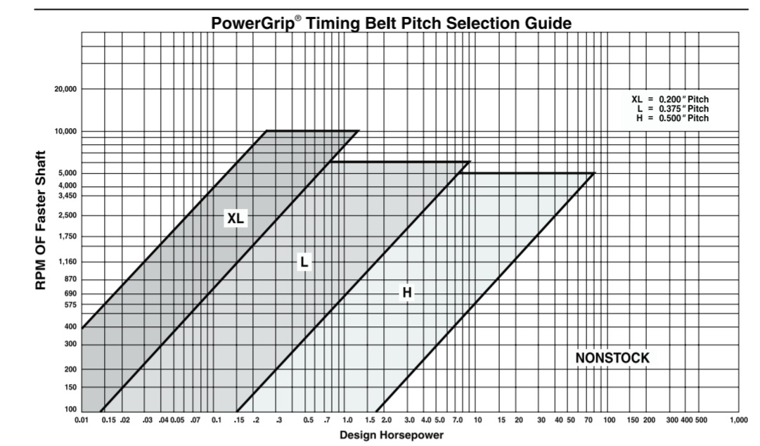

    Thanks for your suggestion - IMHO, toothed belts (discount or not ) are great for high power at pretty high revs,
    but as the revs go down problems with transfered force in conventional mini lathe belts arises:
    Outboard motor for lathe threading? Really? Ideas welcome!-powergrip-timing-belt-power.jpg
    Then, this method (though probably sturdy enough) would have to use a 14 or 20 mm HTD belt to take the pull.
    This goes against my design dogmas of being simple to make and attach, but worse:
    It would be absolutely "Uncheap" at least for me.
    My path will still be "kludging and winging" together what free stuff I've already got - and see what'll happen.
