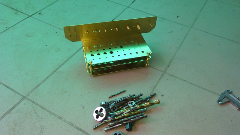

it's almost not worth the time to build unless you have a lot of specialty taps.
Having the tap and clearance drill right there next to the tap has saved me immense amounts of time over the years.
Regards, Marv

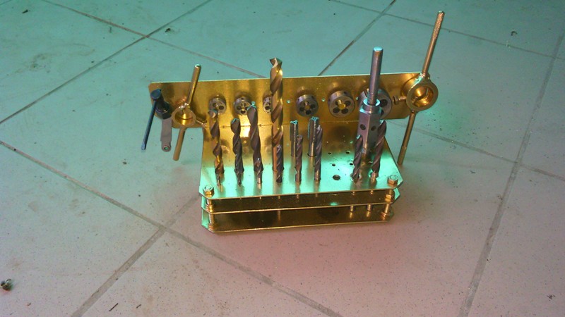

Marv,
I don't see that in the pic they show for the stand. is the tap right next to the "thread" drill? and then beside the thread drill, a clearance drill too? It looks in the picture as though the taps are on the outside, and the drills on the inside...... I do have a TON of taps and drills for them I use a lot that be GREAT to have a rack for the ones I use the most.....
I'm not certain about the one pictured in the URL; I only used that to demonstrate what I was talking about.
Mine, and all the others I've seen first hand, are arranged as follows, reading left to right...
NC tap
NC tap drill
NC/NF clearance drill
NF tap drill
NF tap
Mine accommodates taps in the range between #2 and 1/2". Taps smaller than #2 are so delicate that I made a small dedicated holder for them and their tap/clearance drills.
