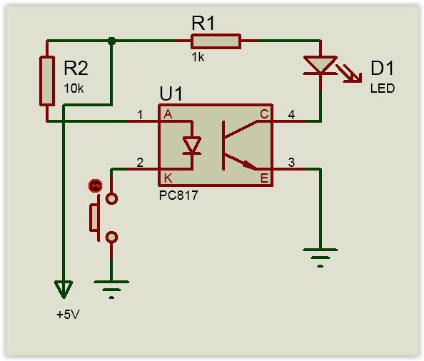

    Would you be so kind to provide schematics which is suitable to test both of the failure states you mentioned of an optocoupler?
    Thank you.
  3. #13
    May 2019
    Stockholm, Sweden...
    634
    417
    Thanked 806 Times in 319 Posts
    DIYSwede's Tools
    No big deal, hegefer:
    -Just hook the (normally open) push-button between the opto-couplers Pin 2 to ground (instead of as per the schematic).
    Then the +voltage will feed the opto-transistor at all times, or rather as long as the +supply is on,
    but the button will draw current through the coupler's LED only when pushed.
    Thus you check that:
    1) The transistor won't lead when the internal LED is off (No push: External LED OFF),
    2) That it'll lead when, and only when PB is pushed (Push and hold: LED lights up), and
    3) That the transistor also shuts off when PB is released (Release PB: LED goes off,
    thus eliminating that no stray, internal current keeps it ON,
    an indeed very rare, but still possible fault mode)
    2 cents

    Circuit with ground switch:

    Quote Originally Posted by darkoford View Post
Name:	Screen Shot 09-05-19 at 01.16 PM.PNG
    Thank you! I am just about to make one. Very useful tester.

    It would be easier if it could be tested directly on PCB.
