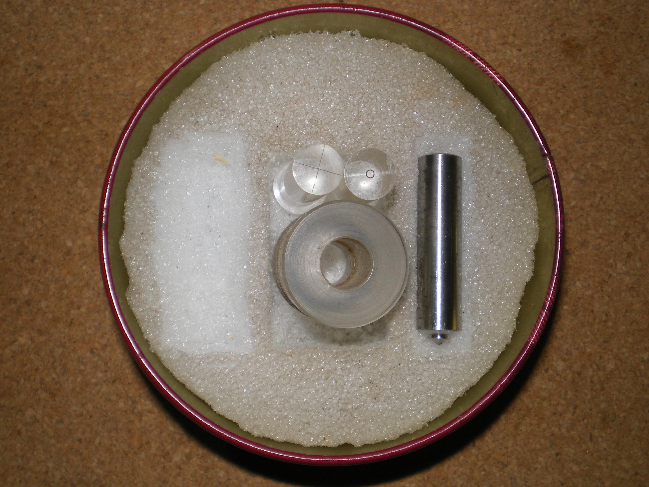

    Hi knoba
    I found your optical punch design on your website before joining HMT. I copied it right away and it has been my go to marking punch ever since. I have used a HSS punch and all acrylic for the rest and made two optics, one with crosshairs and one with a bullseye (this is my favourite) I even copied the storage tin. Many thanks for the idea and everyone should make one, it never misses the mark.
    Well deserved award
    Regards
    Olderdan

    Agree with olderdan, but can somone explain how to polish the acrylic lens ?

    Acrylic is one of the easiest materials to polish, after removing any machining marks with 1200 grit wet & dry any metal polish (or jewellers rouge if you have any) hand worked will quickly do the job.

    OK thanks, I think I had bad experience in the past, maybe I was too fast on the polishing disk, will try by hand next time.

    In the trade, these are known as bombsights.
    My optical center punch is commercially made, it's a long time 'friend'. I have no clue about the optic radius, actual magnification or focal length, but it must be relatively high.
    I'm near-sighted yet cannot use it without eyeglasses, that would make the focal length at least 18". It's not crosshairs but a .003 dot, slightly wider than a fine scribe line. It will locate centers within .002 all day.
    There is no reason to suspect knoba's is any less accurate, therefore a worthwhile project.

    Hi Christophe,
    You can found polishing paste for watch synthetic glasses which goes for cleaning and polishing all optical sights or protecting glasses in the workshop, the result is spectacular only with a clean cloth and some human oil… ;-)
