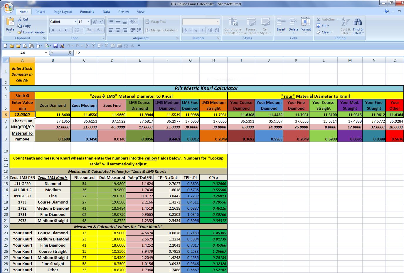

I agree. Spreadsheets are a powerful computer "language". If equations exist, spreadsheets can make them easy to use. Another way to use spreadsheets is to format numbers and text that can be simply printed out. I have a drill bit table that I like to use that was created this way.
I sometimes build spreadsheets on my PC and put them on my iPhone. Then I have a custom calculator in my pocket to run these prize spreadsheet in my shop or on the go.

Great Job. This is a very productive idea for using a spreadsheet program. Most spreadsheet programs have formula creation capability for producing numerical results, however some require a great deal of experience using the various programs.
Your idea is a good model of what can be achieved.
Again Good Job.
Thank you Kindly KD7IIA! This is not much more than a lookup table but works well, for something I had a hard time with. I build them all the time for all kinds of things, sometimes using VBA to clean them up...but simple, easy to use is good in my book.
Thanks again for your kind comment! ~PJ

The "knurling pages" are on my website were I explain in painful detail how I arrived at these formulas. I used to have the calculator "On Line" for free on the site but Google changed the rules again, so I donated it to HMT to collect a small fee ($5) to support the forum and for all the great work and people here. Here is the link to the Knurl Calculator files and instructions.
I created the Calculator in MS EXCEL but it will open in most spreadsheet programs I believe. Yes, you can input data and it will automatically calculate the diameter needed to get "Good Knurls" with Little Machine Shops knurl tool and wheels and a few others I have measured including a "Metric Wheel Sheet". You can also measure your wheels and count the teeth and enter that data to get automatic values for you.
Hope this helps. ~PJ
