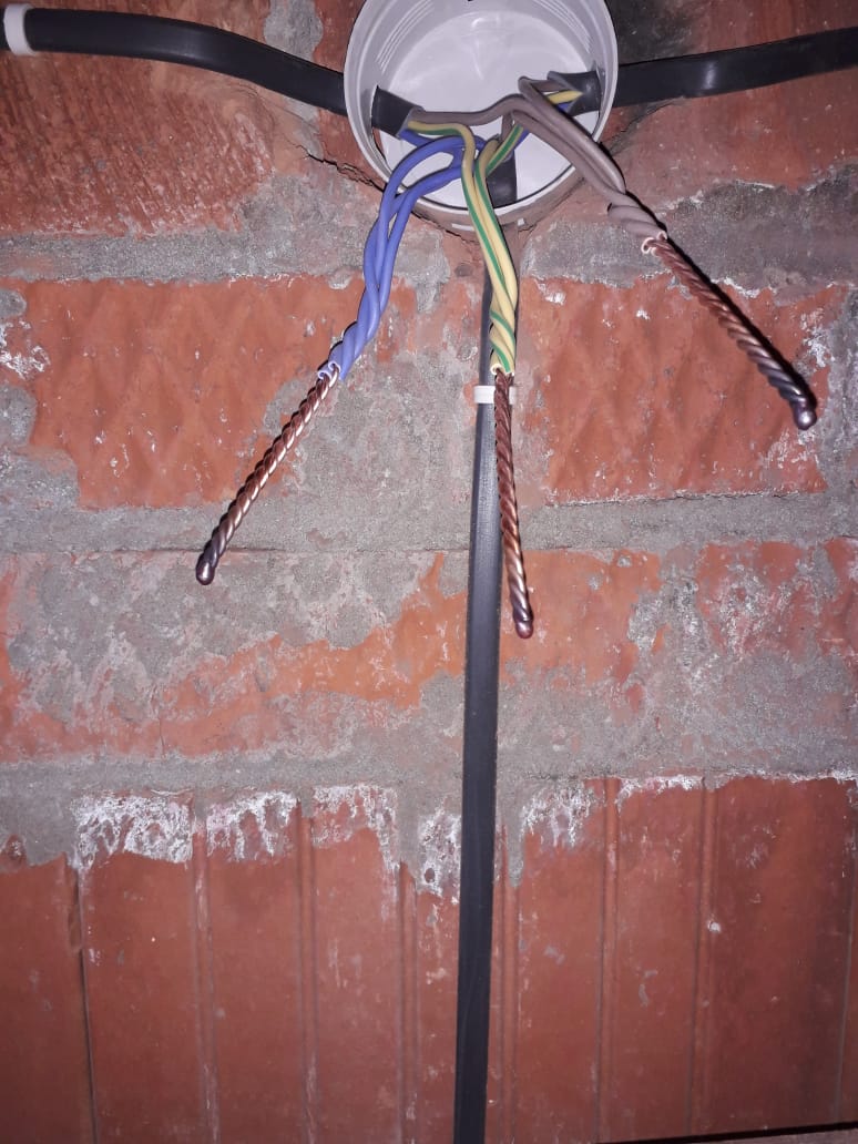

    In our new house I was surprised the electrician could bury junction boxes behind the plaster in the walls. Then he showed a closeup of how the wires were connected...
    After brazing they're wrapped with two independent layers of insulation, the lid is put on the junction box and it's covered with "plaster" (more like stucco).
    I am surprised as well. Your area must have a different codes that supersedes NEC regarding hidden junction boxes.
