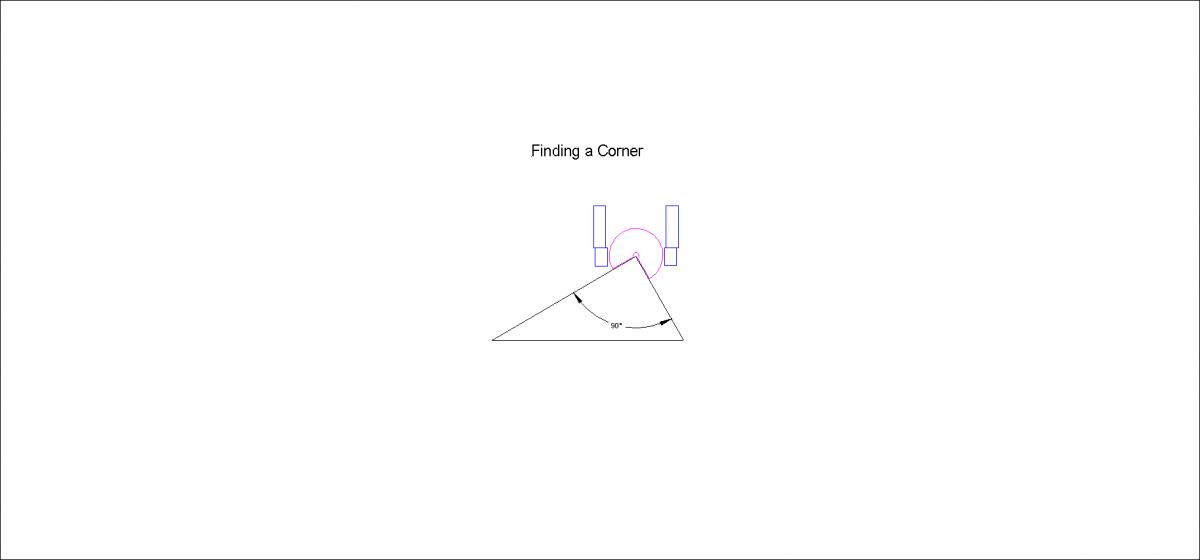

    To make something as critical as you would like it to be would require gage tolerances to be held because of all the accumulated errors, the easiest way to find the corner of that block would be to use the tool like the one Marv made and edge find from both sides of the tool and split the difference, I made a little drawing.
    Cheers
