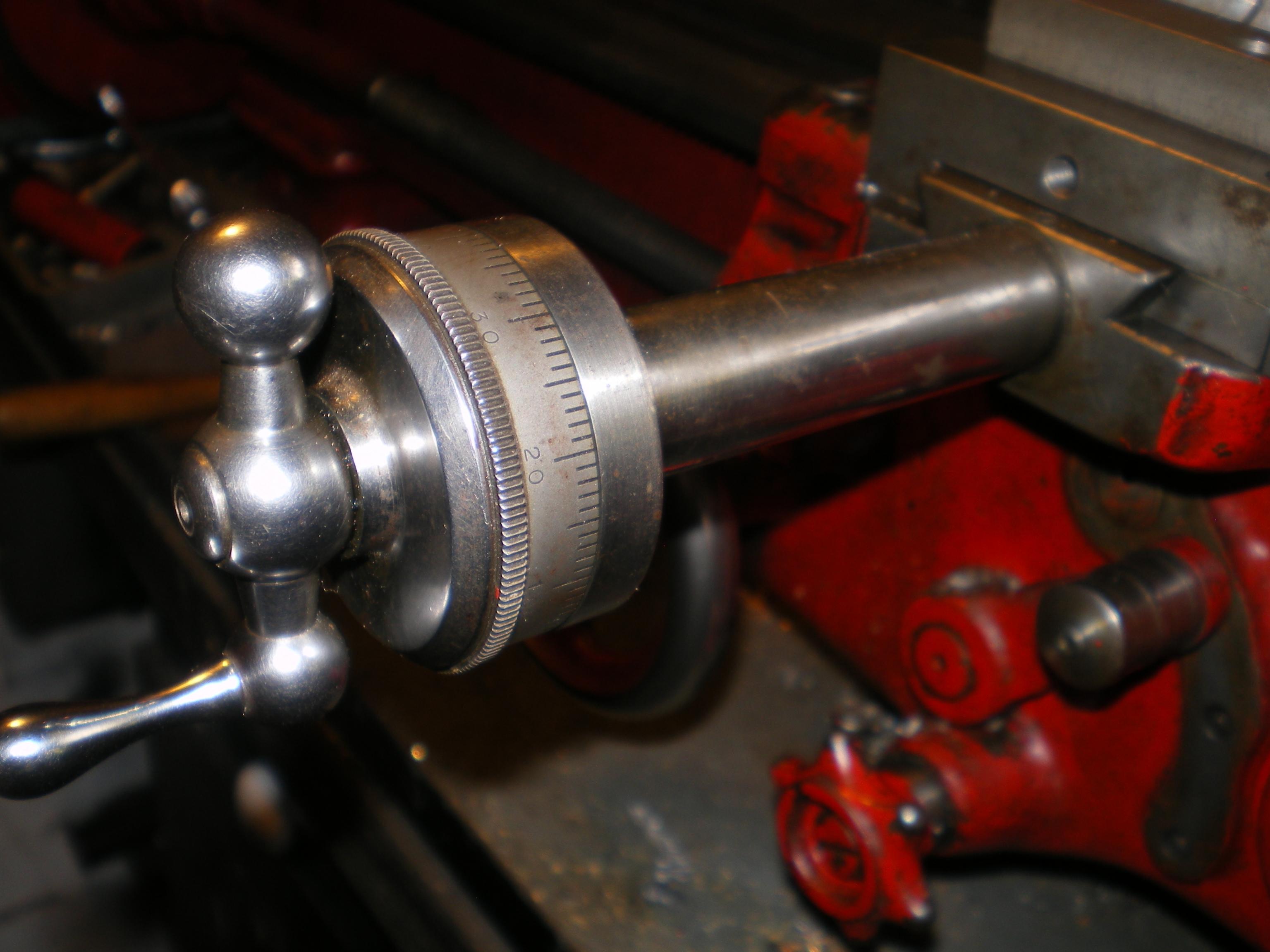

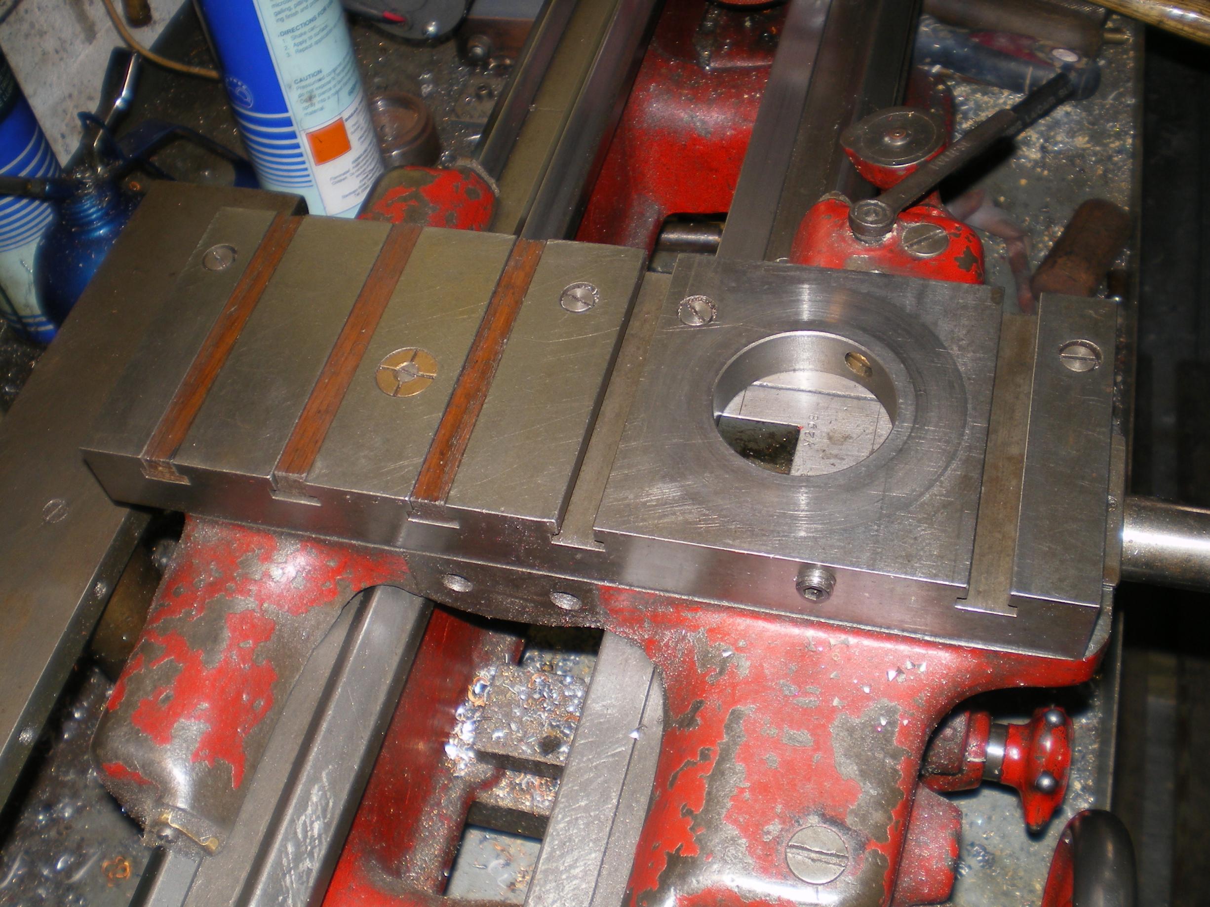

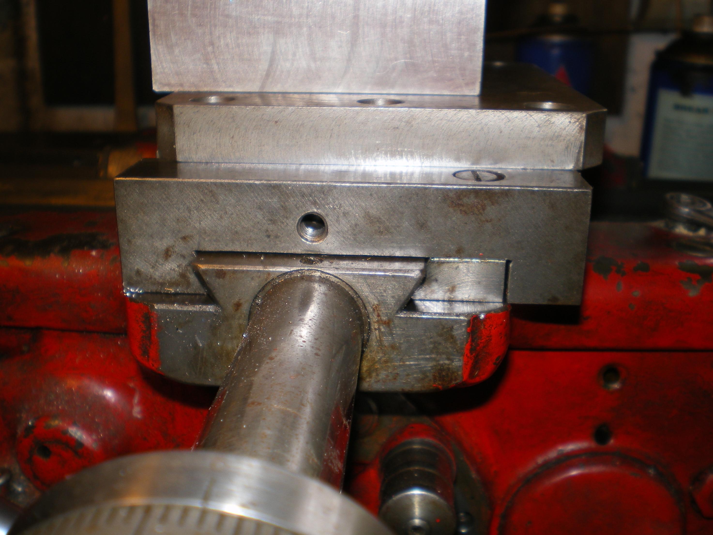

    Boring table for a South Bend lathe.
    A Myford Super 7 cross slide modified by making a new gib strip and extended feed screw and hand wheel, this gives 8 inches of
    travel which is great for milling but does need a new top slide base to fit. In use for forty years now and good as new.Olderdan-imgp0149.jpgOlderdan-imgp0145.jpgOlderdan-imgp0146.jpg
