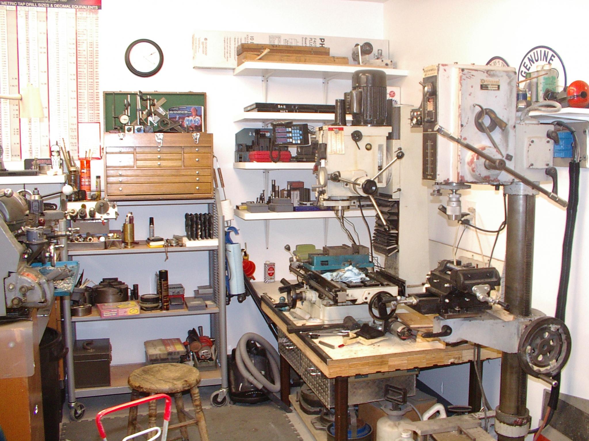

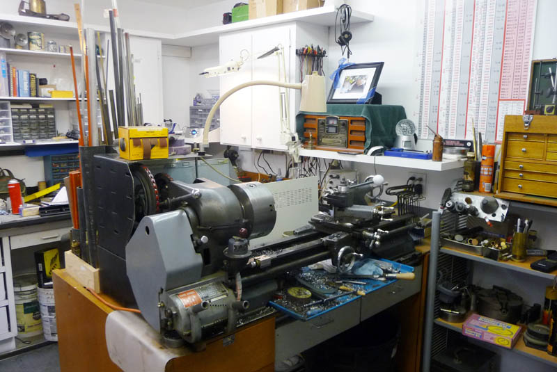

    I need to get a more current pic of the lathe with the variable speed motor setup on it...
