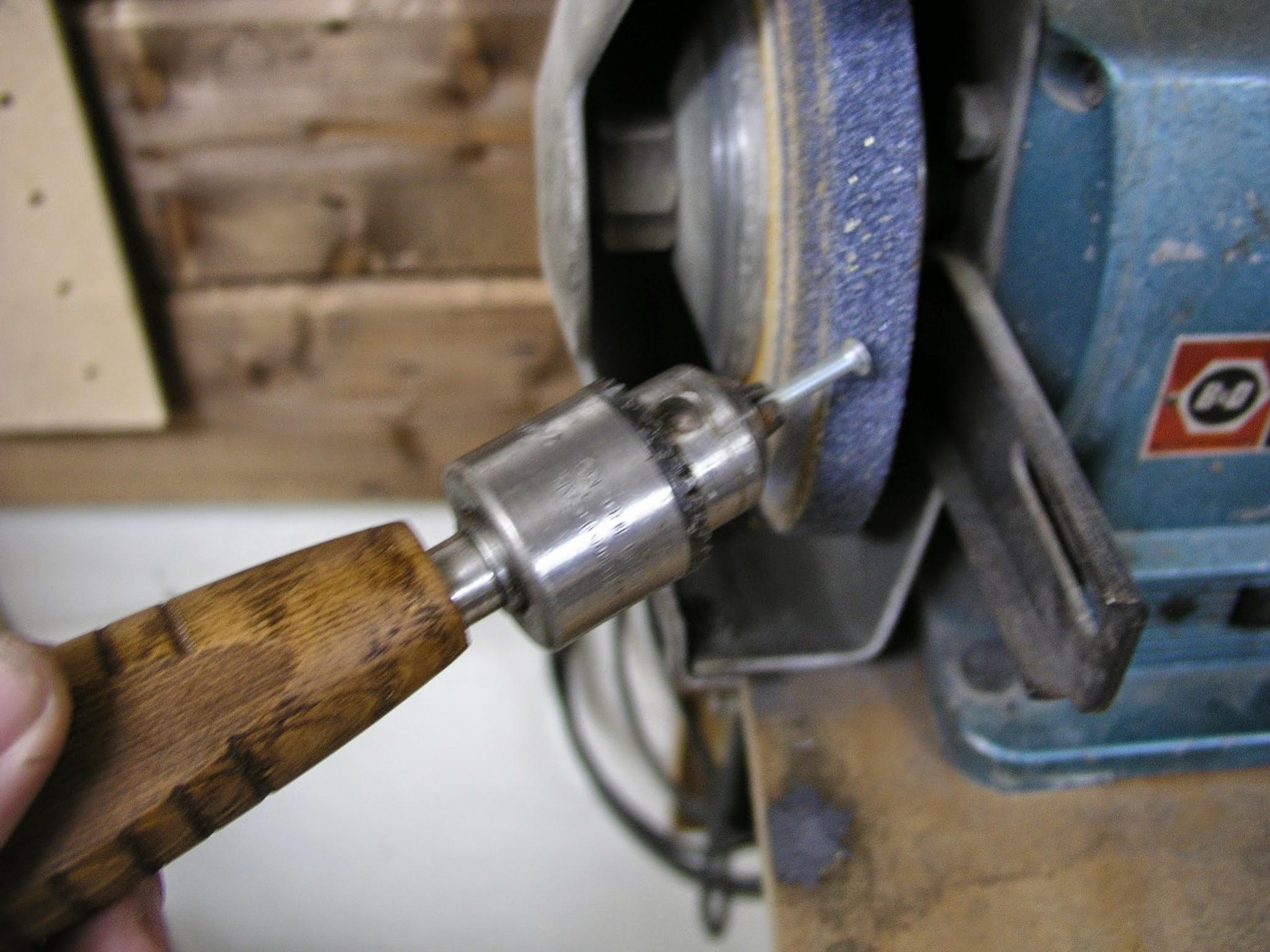

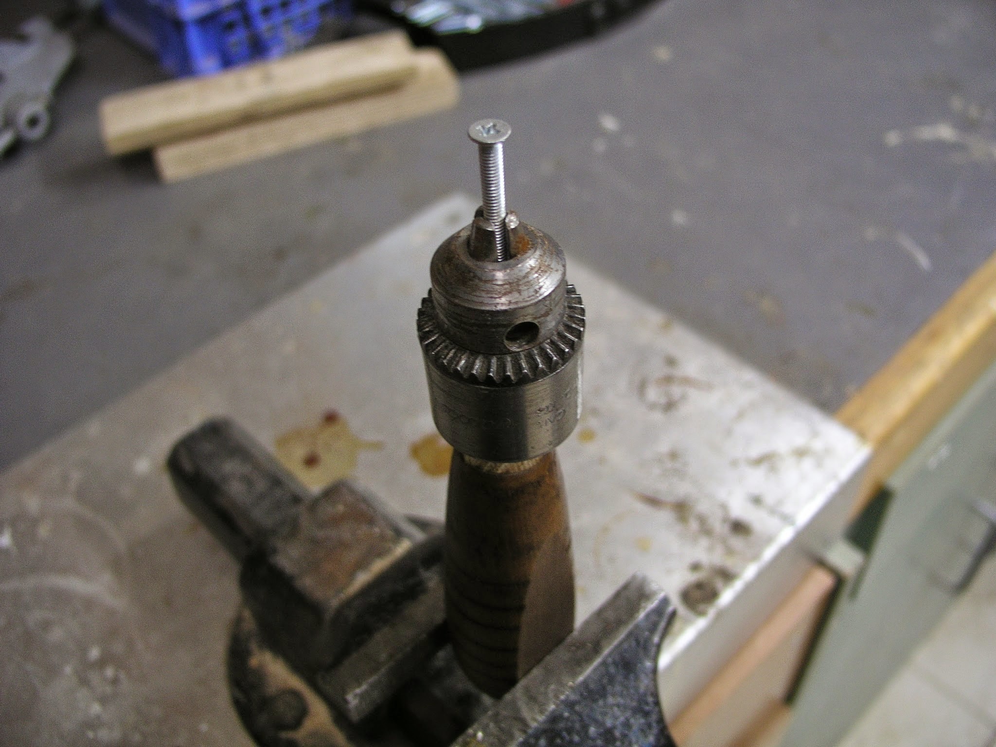

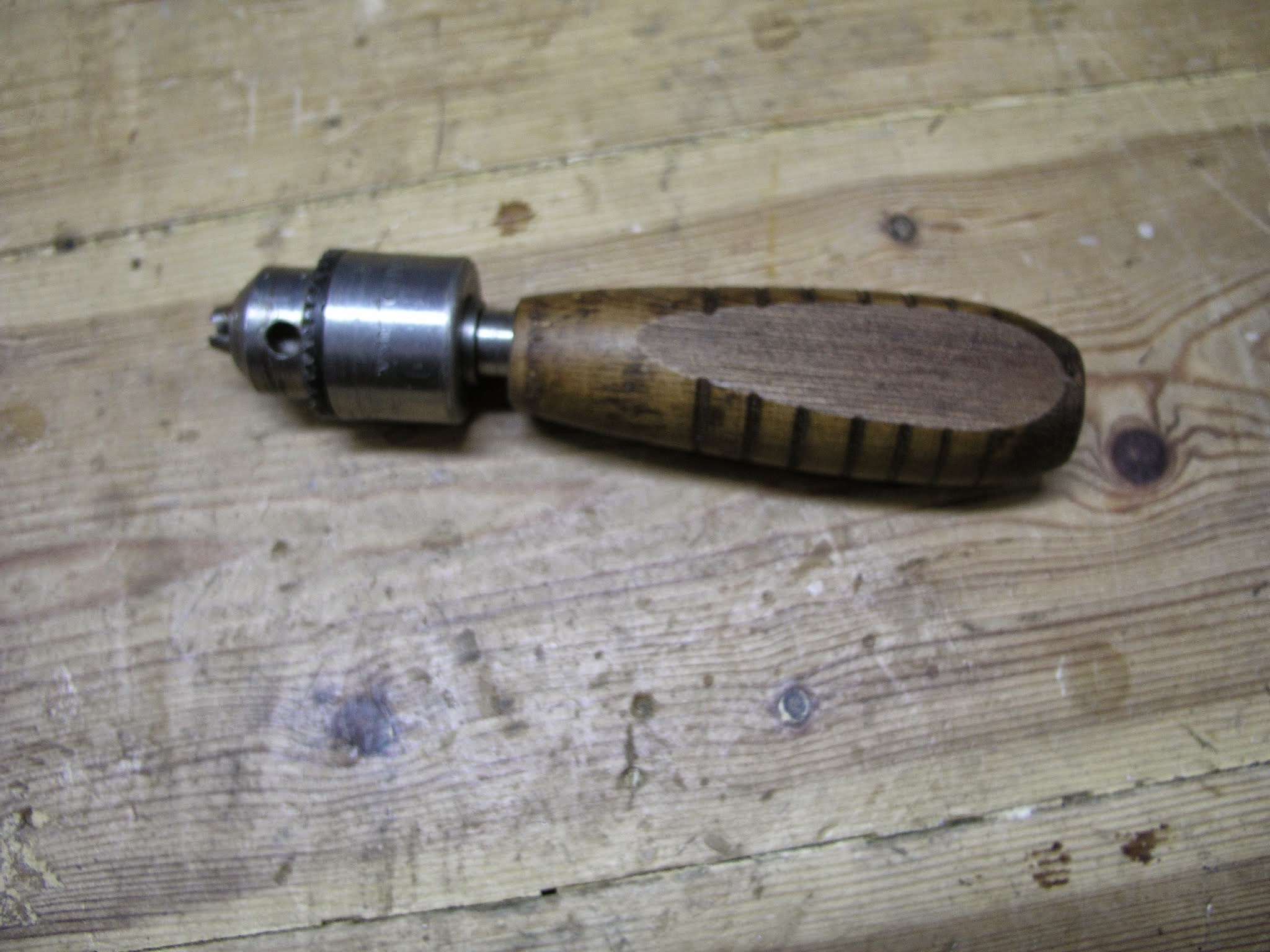

    tranform the old drill chuck to a usefull tool
    hold on a vise
    grinding small parts

    Cool idea, using a chuck as a holding tool. In the absence of a spare chuck, one could just buy a cheap one and replicate this tool.

    Brilliant, and well-timed for me. I just replaced the keyless chuck on my drill press this week with a keyed chuck and was wondering what to do with the keyless one.

    Thank you. Tighting by hand i think is ok

    Excellent idea! I have a drawer full of old chucks. Now I know what to do with a few of them.

    Ended the time I burn my fingers
    Thanks for sharing ..
