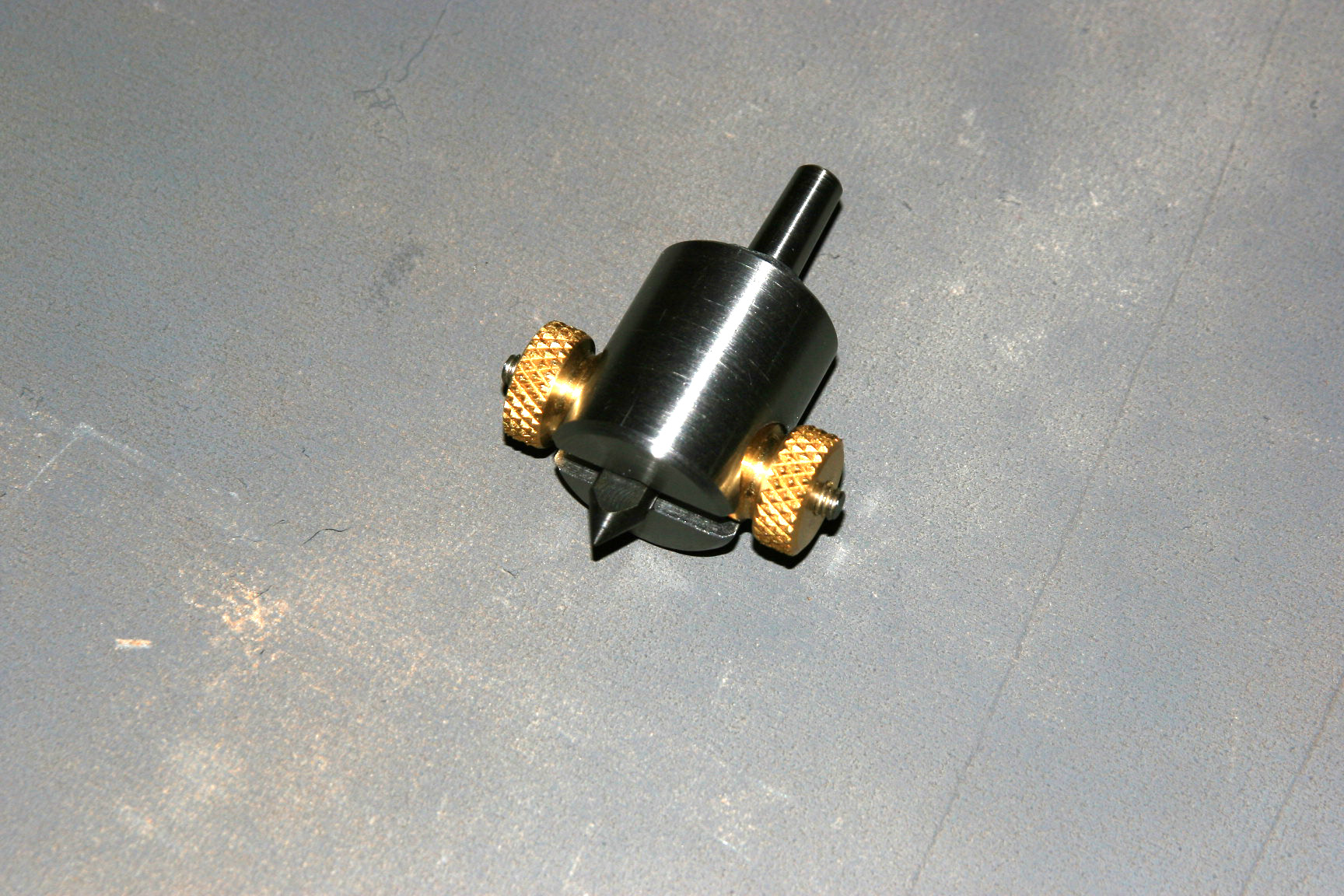

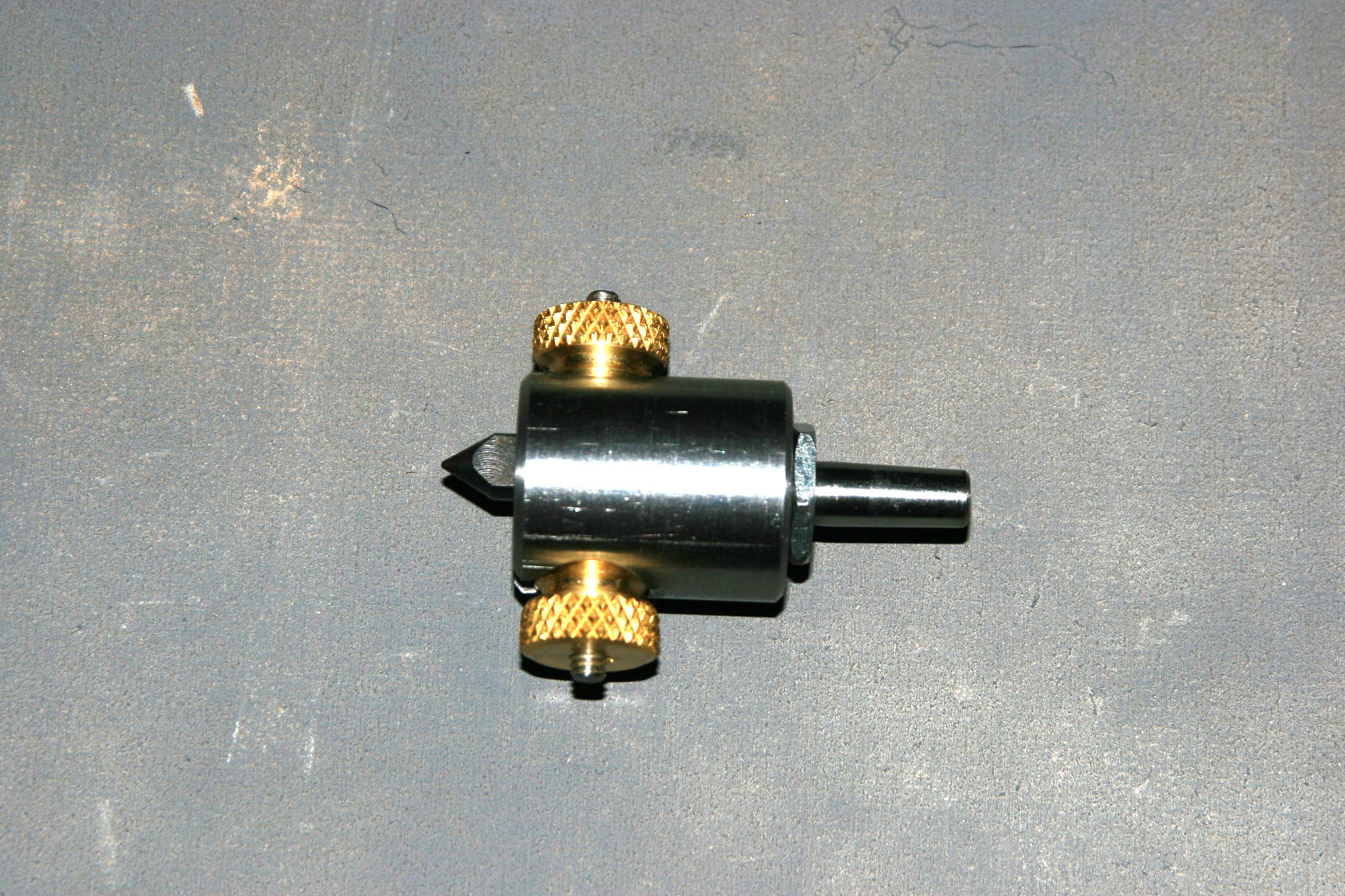

    Shop Made Tail Stock Center for Mini lathe or Sherline or Unimat from plans.
    Nice set of plans and instructions for the offset tail stock center. One of my future projects will be an 8 to 12 inch long cannon.
    This center is just the tool to use for that long taper.
    Build is straight forward and easy to make on home shop equipment.
    Here is the picture of the completed center.
    Thanks for posting the plans.
    Cheers, JR

    jjr2001,
    That is some very nice work! I am sure it will fulfill its intended purpose on the canon barrel. Thanks for posting pictures of your build!
    Dick
