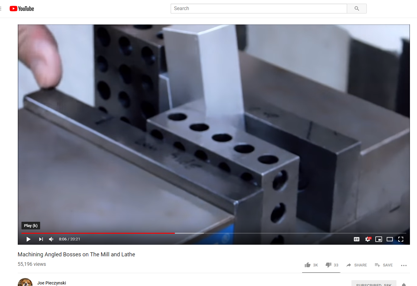

  11. #7
    Dec 2018
    6
    5
    Thanked 8 Times in 3 Posts
    SASocal's Tools
    Quote Originally Posted by LMMasterMariner View Post
    Nice tool to have if you don't have 2 machinist's squares. I am using 2 machinist's squares clamped with c clamp.
    Would this work instead of the 2 t squares ?
