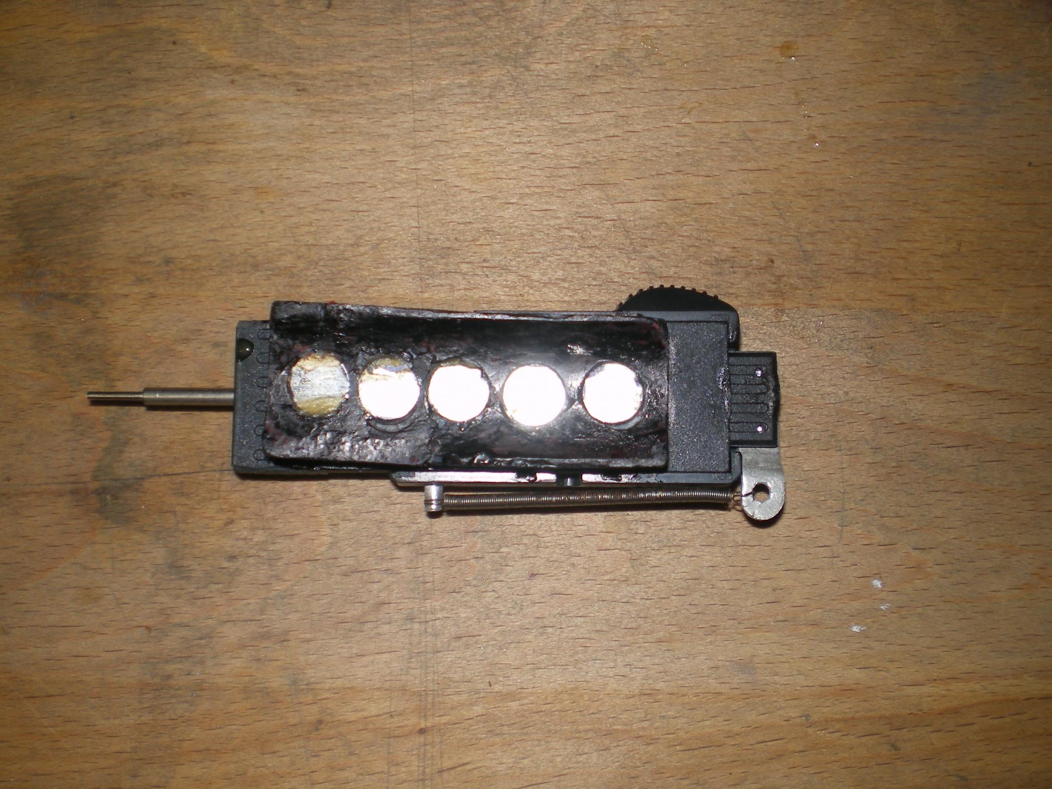

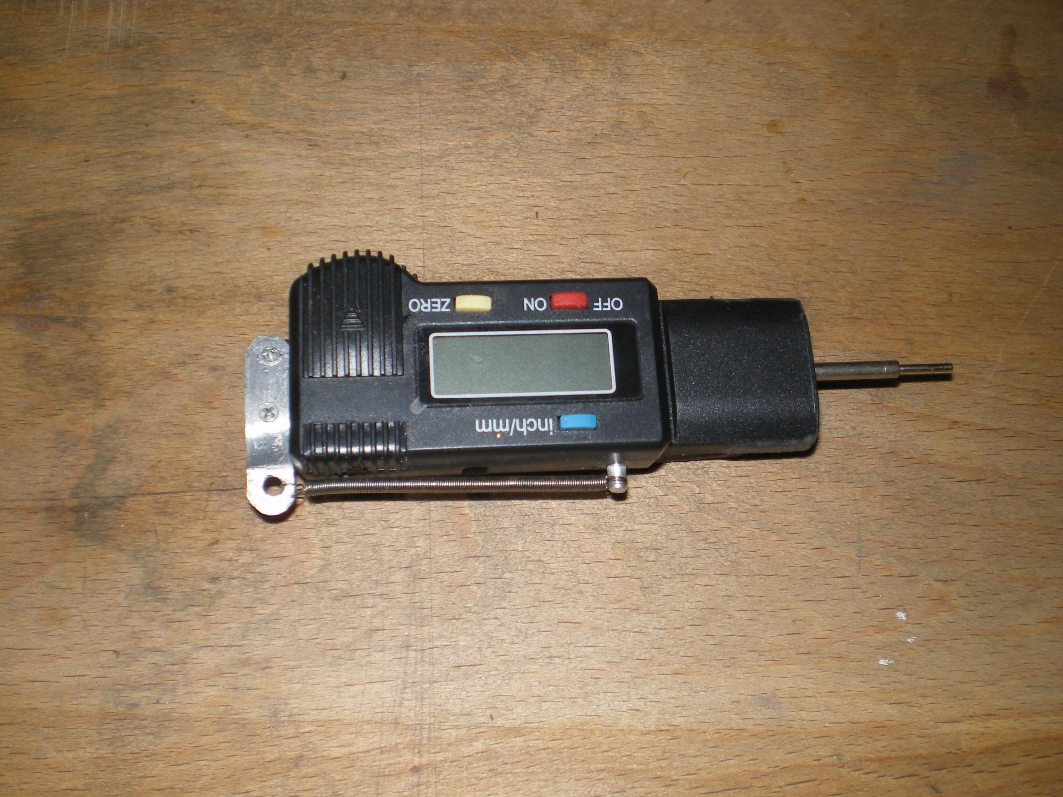

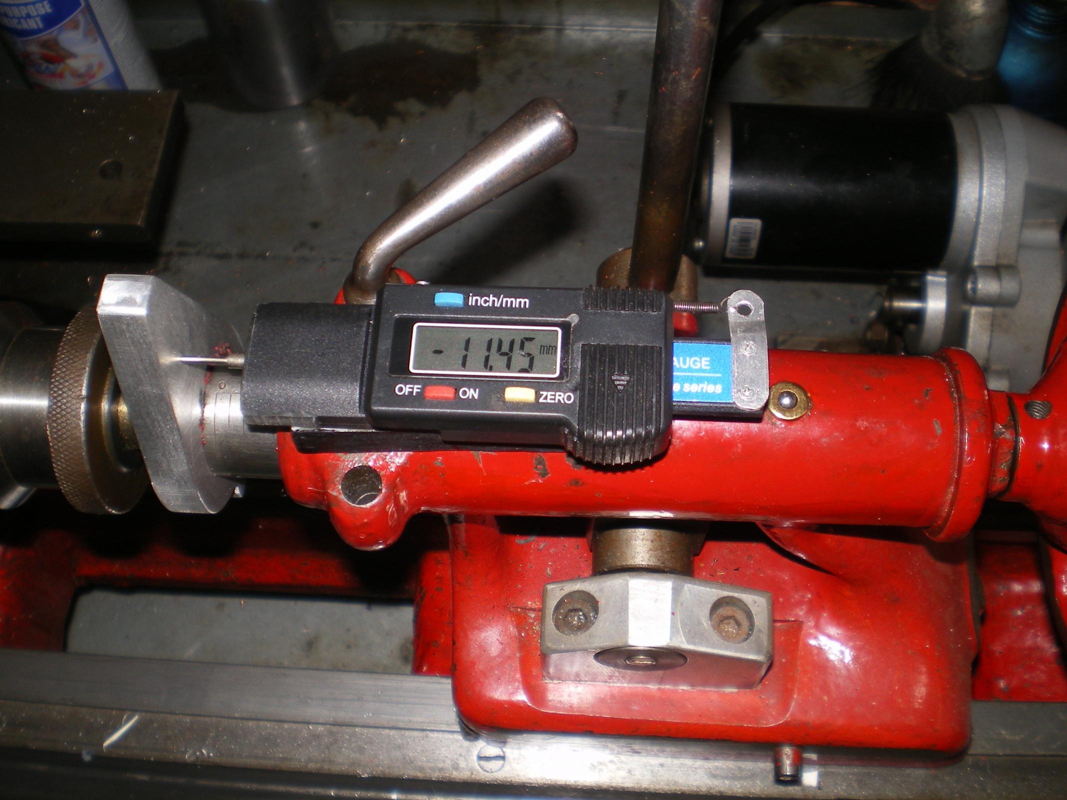

    I felt the need for an accurate depth control for some counter bores so came up with an occasional digital solution namely a cheap tire tread depth gauge with 1 inch travel. My SB lathe tailstock has a round topped casting which is not ideal for this, I am reluctant to machine a flat on this old lathe so another way had to be found. I made a base from epoxy metal putty to fit the top of the casting and epoxied 5 neodymium magnets in the base which hold very well. These gauges are not spring loaded so a bracket and spring were added (I keep every spring I come across of any size) that just left a bracket to make for the barrel which apart from the bore was hand fashioned, good old hacksaw and file was much quicker than machining the whole thing. It only takes a couple of minutes to fit when needed and tooling still ejects with the bracket in place. I should add that the idea is not mine as many variants have been posted on HMT, this is just my take on the application.

    I cheated and threw money at the problem. Bought a magnetic back for a 2" dial indicator, eg...
    https://www.amazon.com/HFS-Magnetic-...s%2C210&sr=8-3
    I'm fortunate in that my tailstock has a nice, flat top so the DI doesn't want to 'roll'.

    Would have been far easier to chew another flat on top of the tailstock, the rats have already been chewing away at it with the lock-down system, so what's the problem with doing another chew at it ?
  11. #7
    Jun 2016
    793
    1,463
    Thanked 1,585 Times in 470 Posts
    olderdan's Tools
    Quote Originally Posted by greenie View Post
    Not enough meat on the casting to take a flat.
