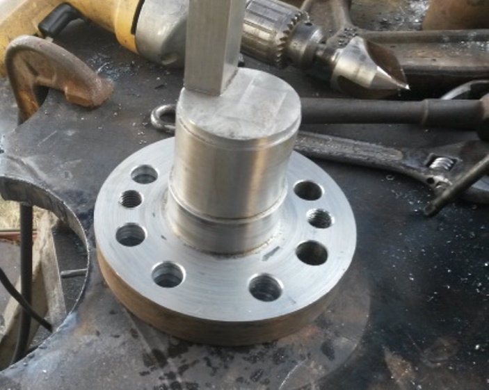

    after welding the pivots shafts the next step was to machine them
    after turning I put them in the mill to form the tang
    after a couple of passes I decided this is going no where fast
    I didn't want to take it to the band saw so I brought my porta band to do the job
    after removing the chunks it only took a single pass down the sides to get to this point
    one more pass to get the size I need

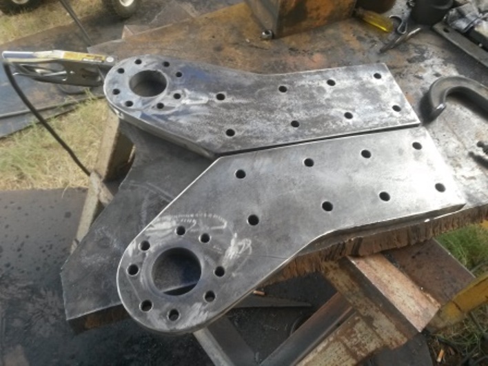

    This project is soon to become a tool in progress I just about have enough parts made
    here is the swing beam pivot shaft after completion.
    After I had fir it in place to determine the locations of the holes I realized this is going to be one of those impossible to remove parts si I decided to drill and tap to jack holes also I have a deep issue with parts that have jack holes that are of a different size than the bolts used to mount them. Hence my jack holes are threaded for 5/8-11 since the part will be mounted with that size

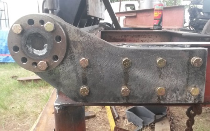

    2,228
    the part that started this thread is finally completely mounted now to finish the other side I'll have to borrow some of the bolts to fit up the other side as I have used up my entire inventory or 5/8 11 by 2" grade 8 bolts and these are actually borrowed from another project. so next time I go to tractor supply I will have to buy another 5 pounds of these
    I have to tell you though drilling and taping in 3/4" thick caterpillar steel is a day's work in it self
    the steel is the same as that which I used to make my fork carriage out of
