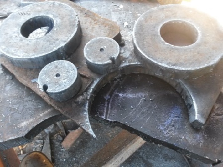

    I am king of bummed at how long it can take to make a pair of what back when I had my fab and machine shop would have taken a couple of hours if that. But back then I would have burned them out with an optic eye torch using only 2 of the 4 heads following a line drawing on paper it would have taken longer to draw the pattern than cut the parts a quick perfunctory grind to remove any slag then tack welded together and clamped in the horizontal and bored clamping them together against the permanently mounted vertical holding fixture would have taken a few minutes then putting the boring bar and end support back on another few minutes the boring process maybe 5 to 10 minutes then over to the radial drill where my wife would have selected a circular hole pattern template and the appropriate centering plug then with a transfer punch marked the number of holes then she would have laid out the 2 rows of holes using another template we had tens of dozens hanging on the wall near the radial drill. then clamped the blanks to the table on riser blocks then swung the little drill head with a center drill chucked in it we had mounted on a double articulating arm suspended on a vertical post mounted on the back of the radial arm raise the drill table up till the drill head was a couple inches above the parts and center drilled each punch mark move that out of her way chuck a bit in the #5 MT quill raised or lowered the table until the quill was fully extended or stopped by the quill stop when the tip of the bit was at least 1/2 an inch above the table. locked it in place release the arm and drill head position over one of the locations lock both head and arm in place set the speed and feed switched on the drill and go check on the band saw then come back and move the drill head doing this as many times as there were holes once the holes were drilled. Blow off the chips move the drill head out of the way grab the small drill head chuck a chamfer bit raise or lower the table for height position then chamfer each of the holes. Then she would have put the 1" gear reduction auto reversing tap head in the quill chucked a tap checked the table height, set the quill stop lock out the down feed so the quill was free to move up and down select the RPM switch on start the tap and just watch as it tapped through the hole once it reached the quill stop the tap head would reverse and back out doing this for as many holes as needed to be taped. Parts done her total time would have been 45 minutes on the outside and the parts would be ready to be separated finish ground on a 6" belt 12 inch disk sander combo ready to be painted, installed or what ever.

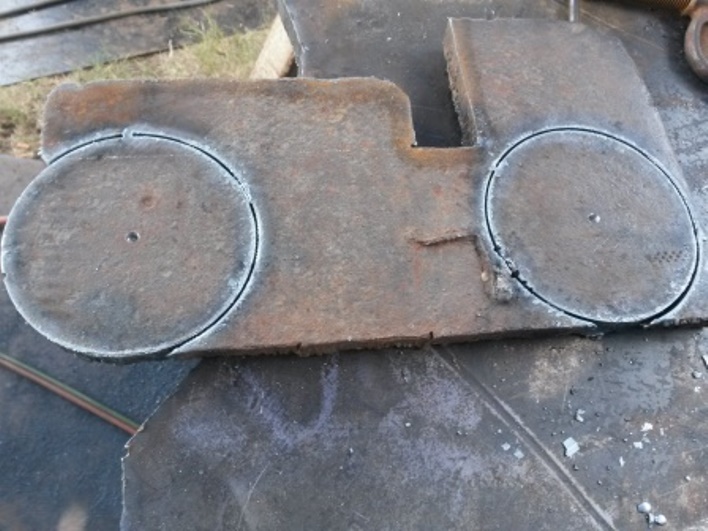

    just to make these 2 parts of a machine I am building
    Hand cut

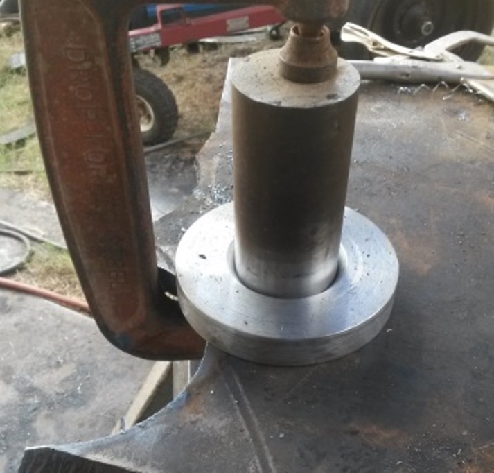

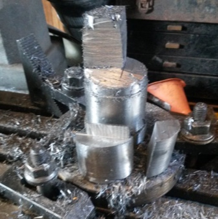

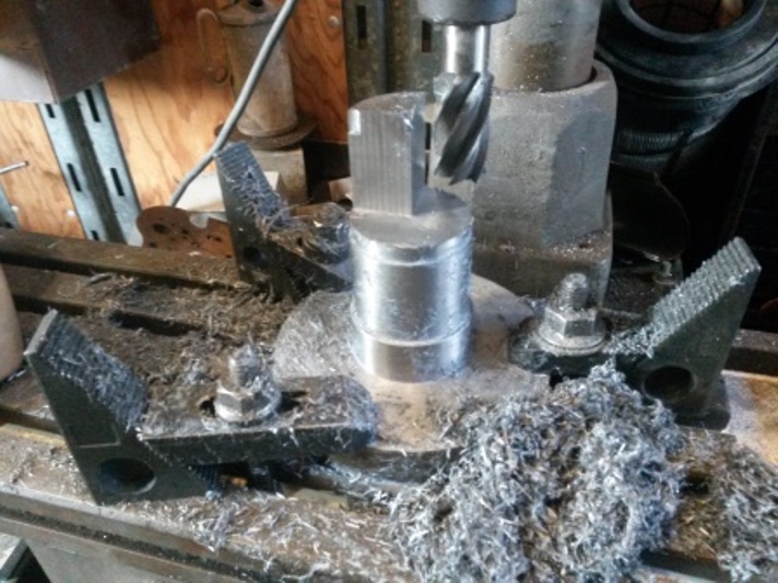

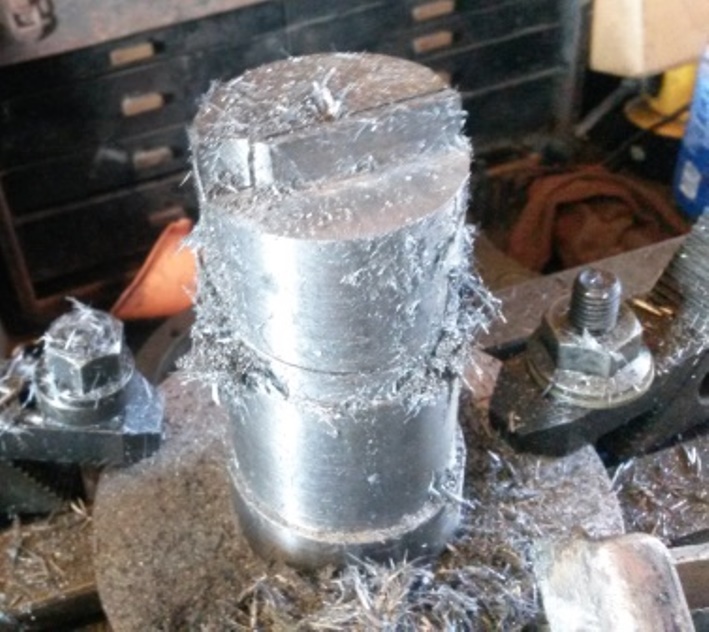

    A couple more parts in process these will be the pivots shafts which will be bolted to the first 2 plates
    Making the first cuts
    t disk ready for rough machining

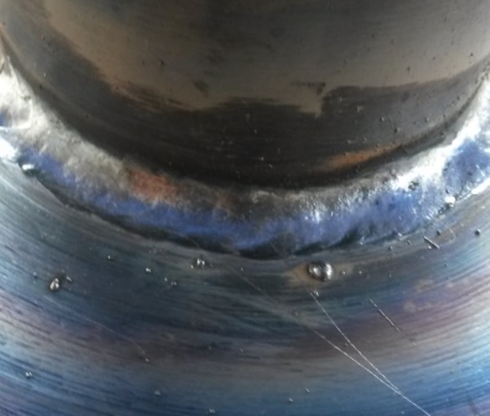

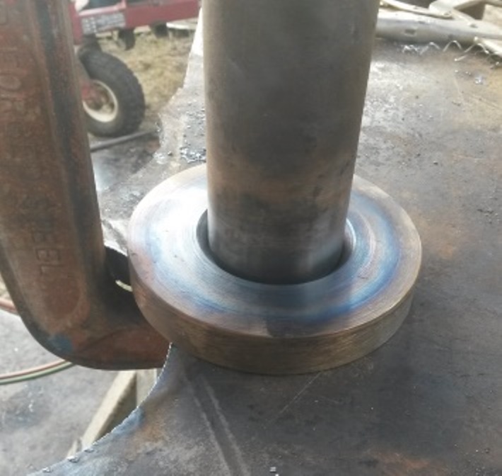

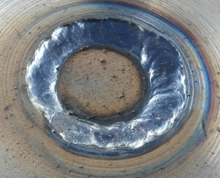

    1018 stub shaft press fit in the A36 disk

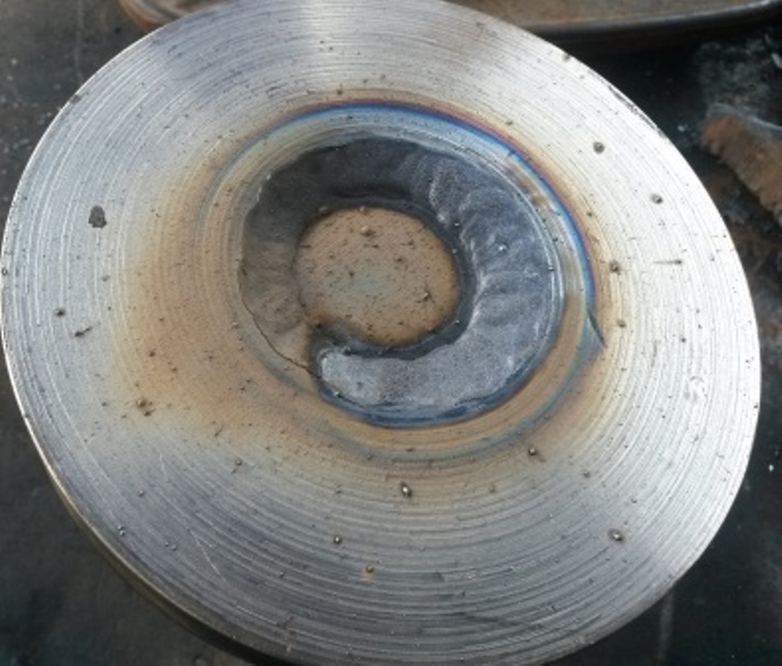

    Normally when welding A36 to 1018 you wouldn't think about needing to preheat
    but due to the thickness of materials and not being able to full pin the weld it is better to preheat before welding that way you don't get what I call weld shock in the metal My term weld shock is nothing more than a cold weld start where all of the heat from the arc is trying to flow into the metal so instead of being able to start out with a nice fluid puddle you have a glob of weld just sitting on the surface of the metal with little more than zero penetration when you can fully bevel the parts down to a 1/16" or so then the heat does not have to flow as far and penetration starts almost imeadiatly as in the case of a solid cylinder though it takes a while for enough heat to build up to achieve good penetration or bond to the weld.
    after welding the front side
    now the back before the flux is removed
    this part need only to cool then it will be ready for final machining

    Beautiful welds Frank. How do you know you've got A36 or 1018, or is this store bought, not "repurposed"? Do you just eyeball seat of the pants that's about right the heat with the rosebud or? You are probably like an old cook, you just know from decades of experience what it takes....

    I can usually tell by the feel of the steel. I know everyone will say that all steel feels the same but to me some steel just feels harder by the touch and I don't have much feelings in my fingers or hands because the skin is about as thick as the souls of the feet on a barefoot beach comber
    other ways by the way a torch cuts it or a grinder makes sparks failing that there is always my trusty pocket knife I make a scratch with it on metal that I have already removed any paint of mill scale the ease and depth of the cut tells me volumes about the metal smaller thinner pieces I might try bending them by hand or even breaking them in some cases a 1/8 by 1/2" piece of any soft to hard metal will give up it's heritage rather quickly when you try to bend it mild steel from A36 through ASTM Gr70 are going to have certain bending properties successfully harder to bend with each increasing grade. ASTM 514 (T1) will still bend but will have a much larger bend radius the armaloy metals like AR 350 through AR 500 are going to have larger bend radiuses than T1 and will eventually break Spring steel is funny as it can be carbon or stainless there are grades of spring brass and aluminum it is all about the alloy's and heat treating
    but carbon spring steel will slap you in the face Much the same as above applies to the various grades of bar stock like 1018 1020 1035 and so forth it is after heat treating stock like 1045 by making it white hot and quenching in ice water that you find out real quick you have messed up it will shatter like glass I made a bunch of cable guide thimbles out of 1045 then just heated them to medium cherry and oil quenched them since they were being pressed into another assembly we didn't bother annealing them but I got 1 too hot almost white so I just tossed in outside in a bucket of water that was just barely thawed out from the night before's freeze Clanance the Blacksmith went out and brought it back in to show me what happens when you over heat metal and super quench it he dropped it on a piece of steel on the floor pieces of it went everywhere He said the higher the grades go the more attention you have to pay to the metal and the color sometimes you quench it then re heat it to around 400° then let it cool naturally keeping out of a cold breeze

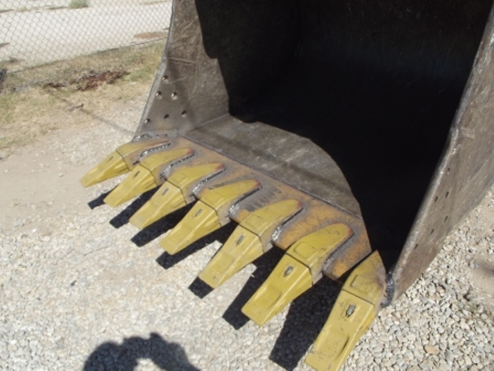

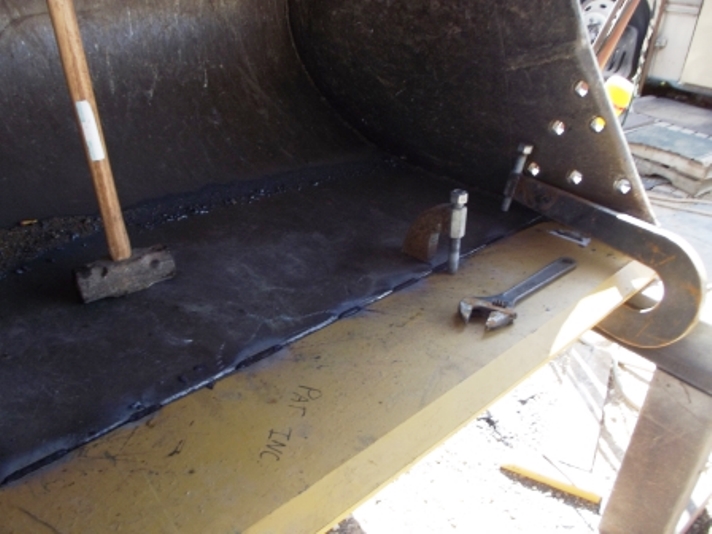

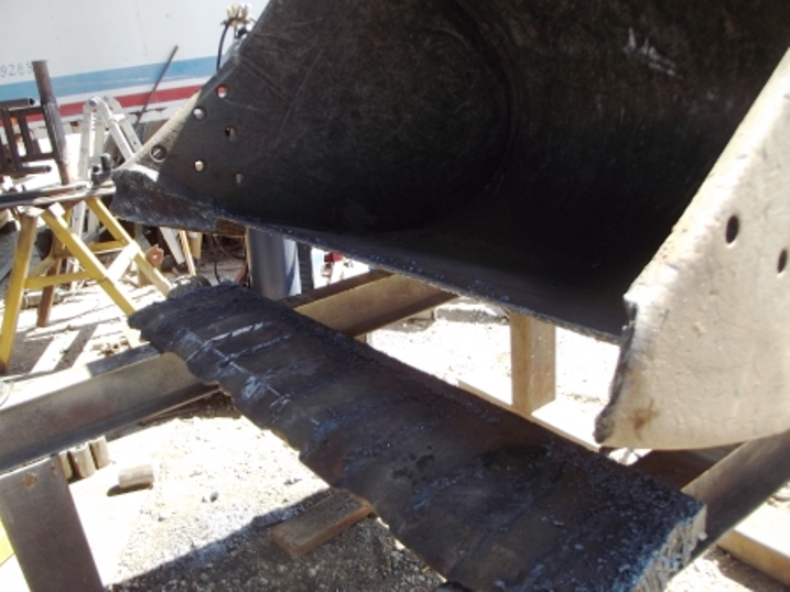

    Thanks for the post. Those are some nice welds Frank. Is that dual shield or stick? After you make a weld like that is it hard to machine? We weld flanges for excavator bucket pins with dual shield but I still have problems with out of position welds. Thanks again.
  12. #10
    11,714
    2,226
    the weld is made with Esab 71 .045 gas shielded flux core wire run on a Millermatic 210 #7 setting and 37 for the wire speed not sure of the amps or voltage as my machine doesn't have gauges I use it for welding teeth on buckets as well
    not a tool yet only a part-dscf6542.jpg not a tool yet only a part-dscf6545.jpg not a tool yet only a part-dscf6546x.jpg
    I have 3 favorite wires that I use all are very similar in weld characteristic Hobart Excell 550 Trimark 777 and the Esab above
    I find that they have better wetting of the puddle more even penetration low splatter and free'r flux release than many other wires particularly Lincoln weld and Alloy rods of the same grade as the above.also all have a tensile nearing the 90K range when propperly applied the sharpie is down around -30° elongation and reduction of area will beat out 7018 or 8018 hands down and in many cases hold as well as 11018
    For machine-ability when preheating to the base metals is done prior to welding you will notice no difference between the weld or the base metal but that holds true even when someone welds with bare wire and an argon Co2 mix straight CO2 with bare wire needs to be post heated or annealed before machining because the surface freezes a little too quickly
