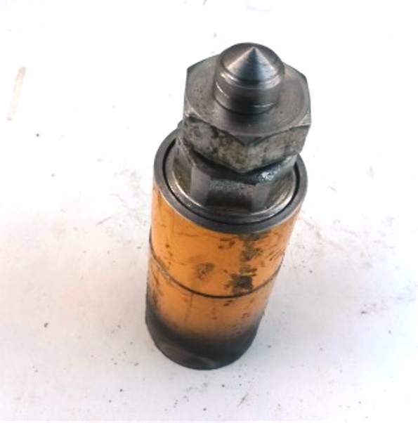

    I really didn't have a need for another machinist jack but I did need something that I could use to mark a hole location
    the hole is 41/64 ths and a 5/8 grade 8 bolt must be used so alignment is paramount
    For this I really needed a transfer punch to mark the center but due to the location of the hole this was going to be next to impossible for all of the holes

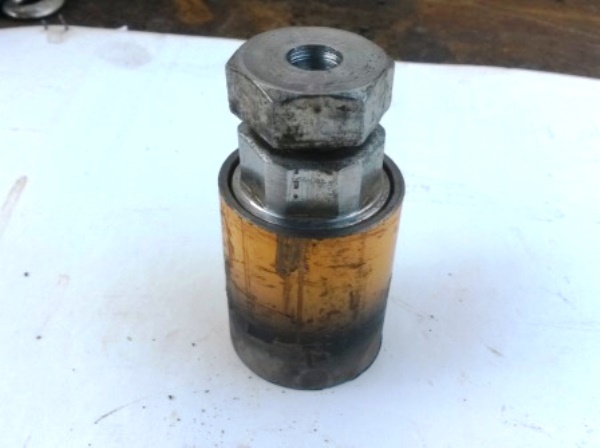

    SO this gave me the idea of using a machinist jack with a point like that of a transfer punch the only jacks I had are 2 small factory made and are hardened and I didn't want to modify them either so this is what I came up with
    A jack made out of a piece of DOM tubing a 16MM 10.9 bolt and flange nut plus a piece of mystery metal shafting.
    The jack in normal configuration also has a washer welded inside the bottom so it can be mounted via "T" slot to a mill using a short bolt and a "T" nut

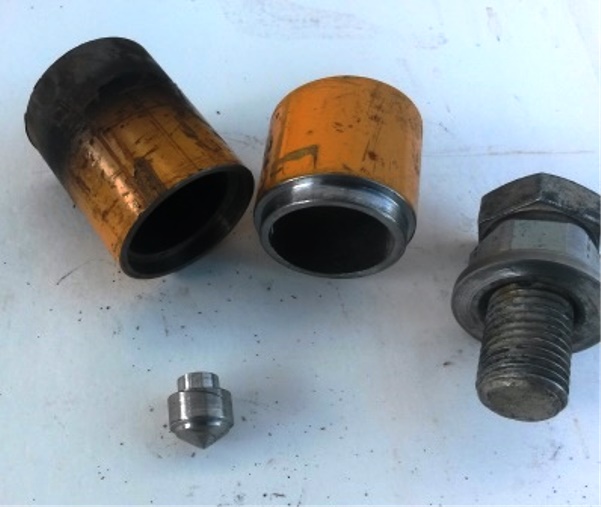

    Shown here are the jack base an extension the jack bolt and nut which are removable and the doweled transfer punch which can double duty as a locating dowel when multiple holes of the same spacing might need to be drilled by simply locating the previous hole on the locator dowel portion of the punch
    Shown here is the machinist jack with the extension I have a thin jam nut not shown in the pics for locking the jack to height

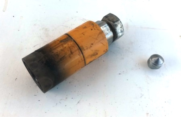

    Shown here as assembled with the extension and the doweled punch

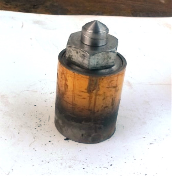

    Shown here with the jack nut inverted for reduced height

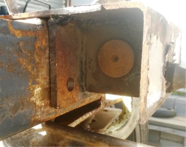

    This is the location of 1 of 20 holes which must be located and drilled this one is one of the ones that I can actually see many of the others can only be touched or viewed by a mirror

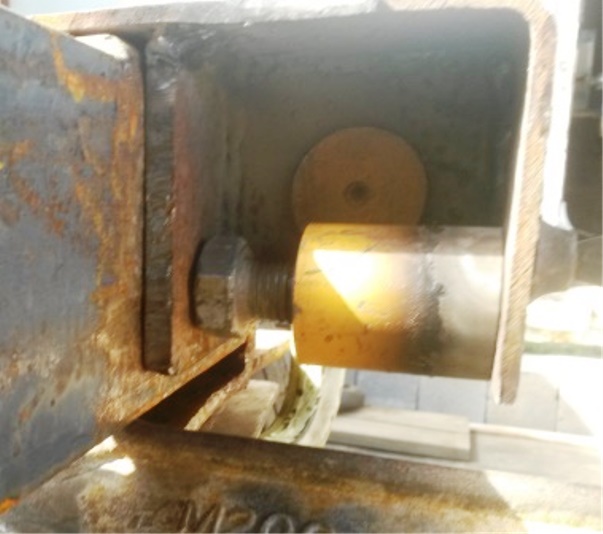

    Shown here is the jack in place with the punch in the hole a simple turn of a wrench will make a center mark

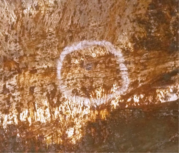

    Inside of the chalk circle you can see the punch mark
    The nice thing about this set up is I can machine any size dowel or punch needed

    Hi Frank,
    A good idea to give us your pictures, I've make a 6mm. hole in many of my small jacks and use broken mill grind at 60° for this use, with a perfect precision.

    Almost a year later, a great idea, and still collecting views no doubt.
    Anybody can layout material before it's fabb'ed up; rework and repairs, [not to mention in place] are a complete different beast, no?

    Absolutely Toolmaker51, It is almost always easier to layout on new materials then fab from there. but when you have to locate and match up to existing holes particularly when they are obscured or difficult to get a straight line measurement little work arounds like this jack with a piloted punch point make life so much more pleasant
