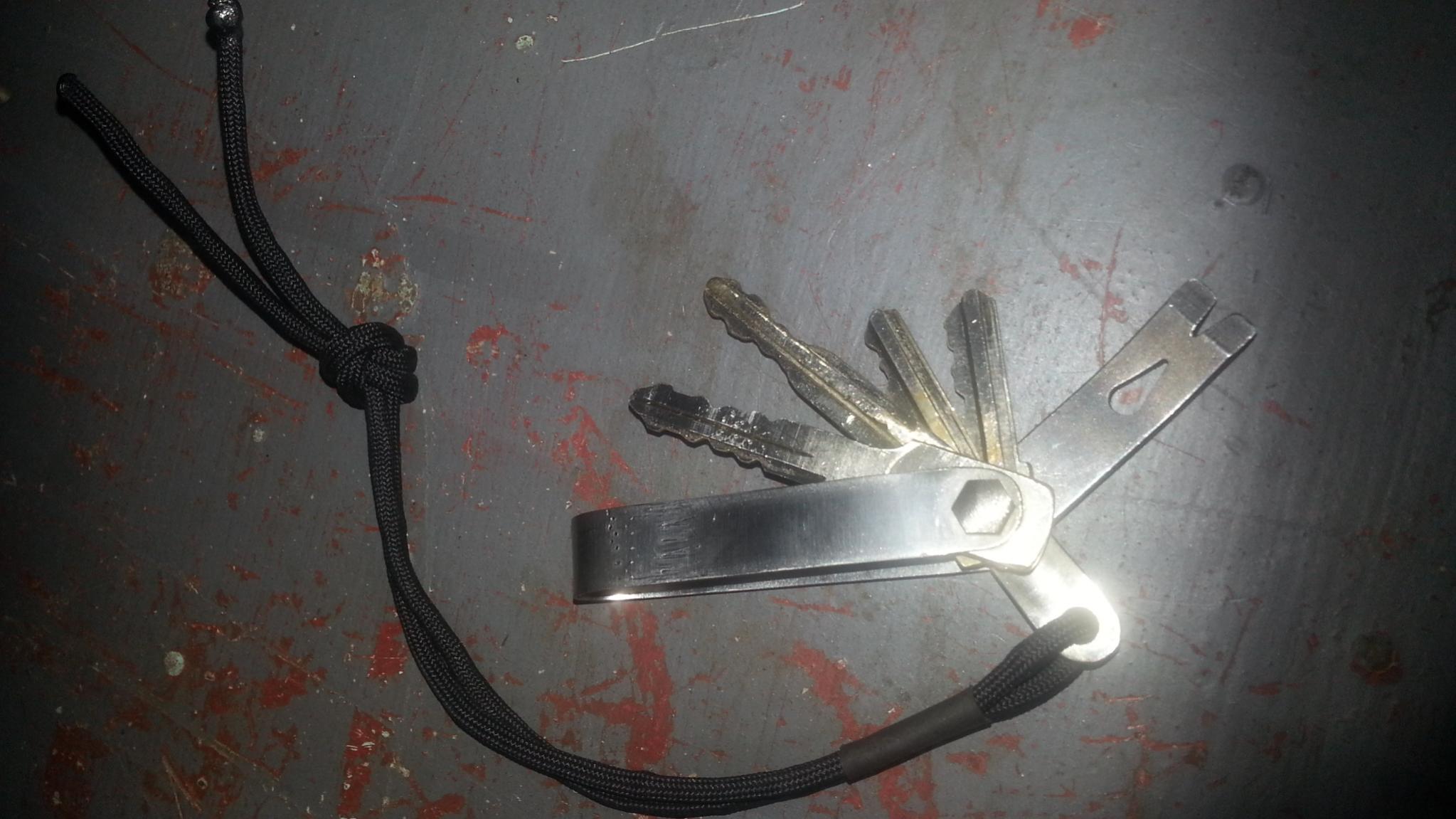

    Non jingling non stabbing key holder
    I am always tinkering with the stuff in my pockets to add useage or minimize annoyance. my car keys and house keys have been through the most changes(part of the reason they are not all uniform). today I used an old hose clamp to make a new key index. my keys were already ground down from previous meddling. so today I just put two holes in a hose clamp bolted the key between with a small pry bar and a spacer to loop a lanyard through. the spacer is just two holes in a smaller piece of hose clamp with all the sharp edges ground down. hopefully self explanatory otherwise

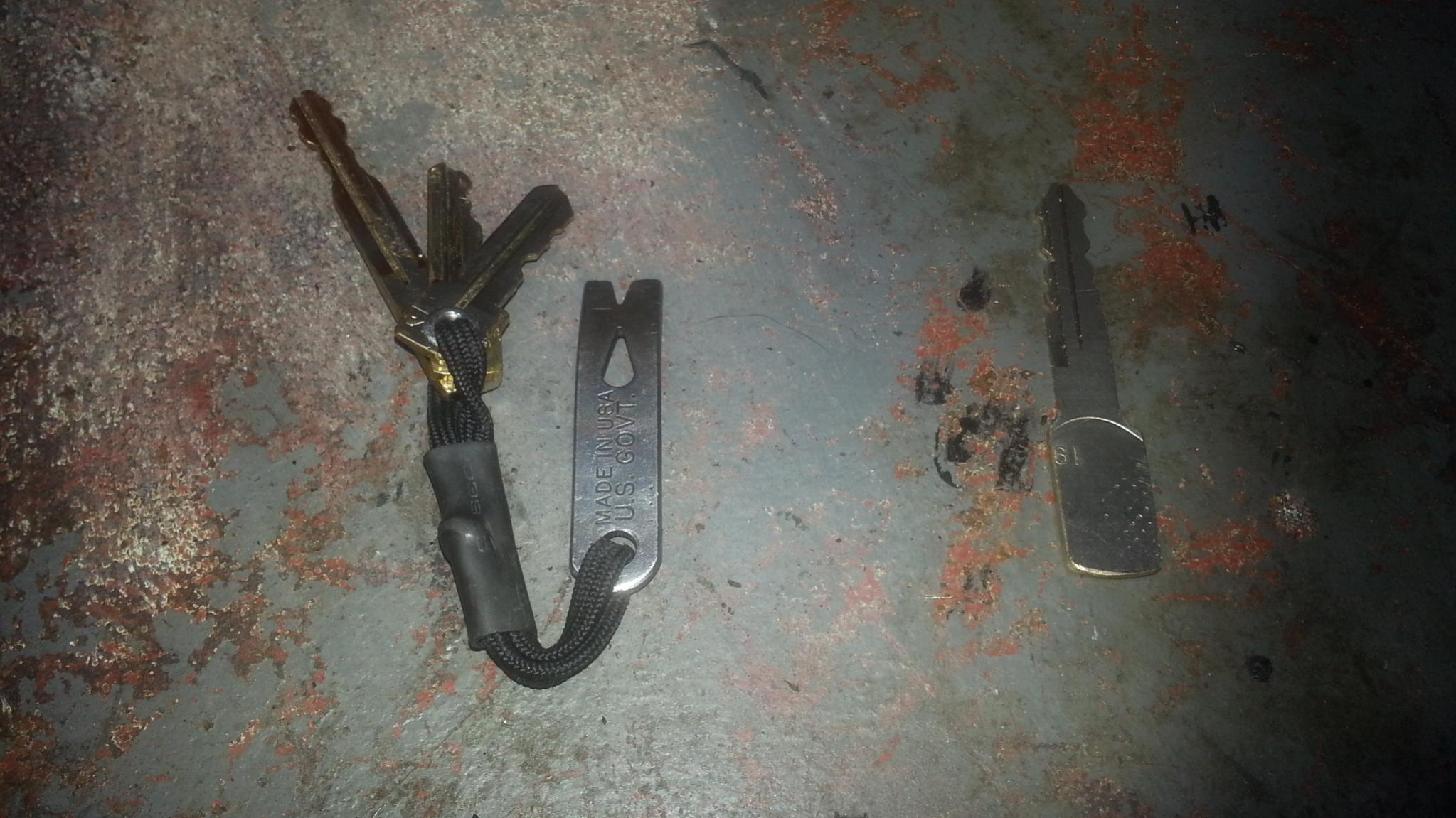

    below is the previous iteration, using brake tubing as a rivet, heat shrink tubing, and some paracord string. this one was axed because the keys would loosen in time and jab holes in my pockets.

    Cool post, jere. I'm an EDC fan and this is one of the more practical ways I've seen of building a key holder. Although the multitool-based ones are nice, I find that taking one apart just to put your keys in is a waste of money and resources.

    Nice build jere, with simple stuff, and really admire the mini pry bar. Carried a P38 for a Long Time now on mine...multiple uses. I'm with DIYer though about quick add/removal and have used the old cable locks for years because of it...and primarily because the fat bob keys with electronics don't have a simple solution. Good (EDC) thread start here...Thanks for sharing! ~PJ

    I have known a few people to carry those can openers really a great design and come in handy when you need them. You are right about the big electronic keys now too. With one of the car keys I carry I had to find a work around with a transponder in the key. Ended up destroying the only factory key I had but now I can use simple blank keys. It saved $80 for a copy of the key for the wife.
