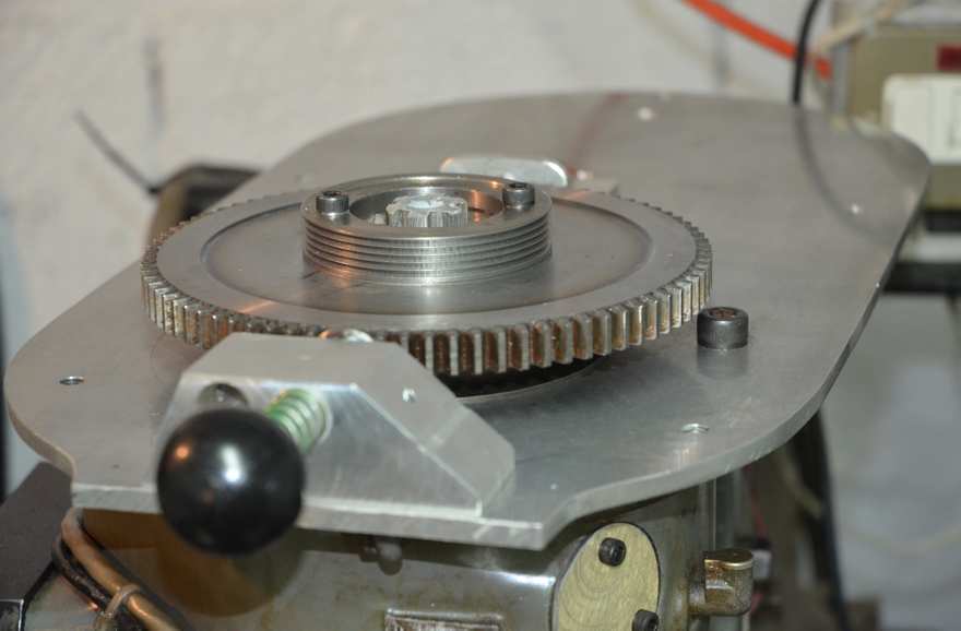

    I used a some gear tooth sensors and a gear for the encoder.. It is only around 38 teeth so 152 counts per rev.. (which was fine for most threading/rigid tapping) I just added twist functionality to the comp. You send it the Deg/Rev
  6. #16
    Nov 2016
    Spain
    1,626
    734
    Thanked 2,737 Times in 733 Posts
    tonyfoale's Tools

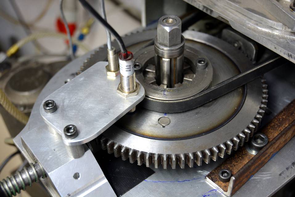

    Quote Originally Posted by skunkworks View Post
    So for the twist you tell it that you have 355° (or appropriate number) per revolution?
    I have close to 100 teeth so I would have a resolution of around 1°.
    Currently I have two pickups for a single pulse. One for a cheap tacho and the other for an index pulse. My intention is to add a couple more to pick up on the teeth.
    As the spindle speed is close to constant, for a task like this I think that one could get away with some pulse frequency multiplication to fake better resolution.

    If I want the polygon to twist 60 deg in .5 inches (the photo) I send it 60/.5=120. Gear tooth sensor are not that expensive - Although I don't t now the availability in france.. \
    I used allegro ATS667LSGTN-T
