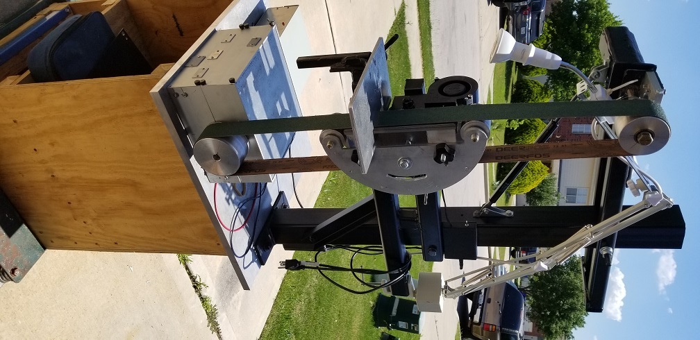

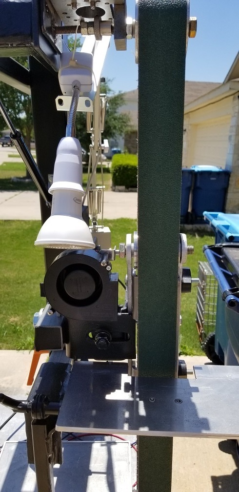

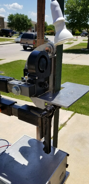

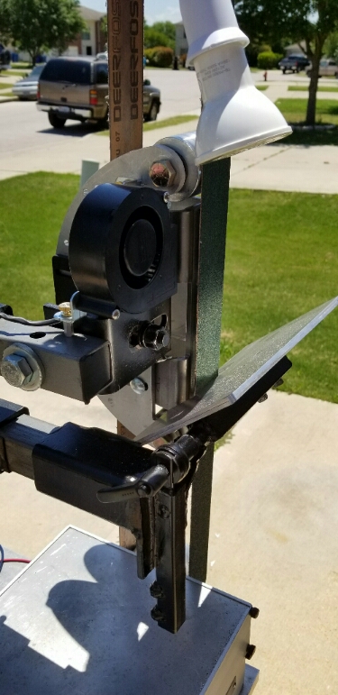

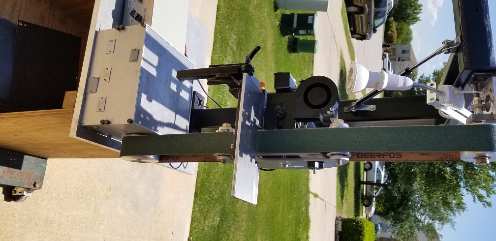

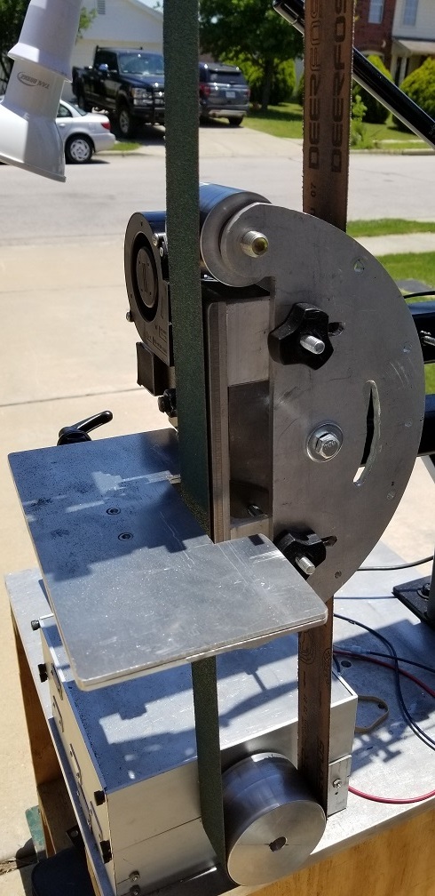

    First post newbie. I just finished top part my 2" x 72" belt grinder. It not pretty but it runs smooth and grinds even better. I built it out of a treadmill motor and a motor control I got yers ago for a pitching machine build but ended up getting a good deal on one I found on CL.
    I made everything except the wheels and platen and the build is all repurposed materials.

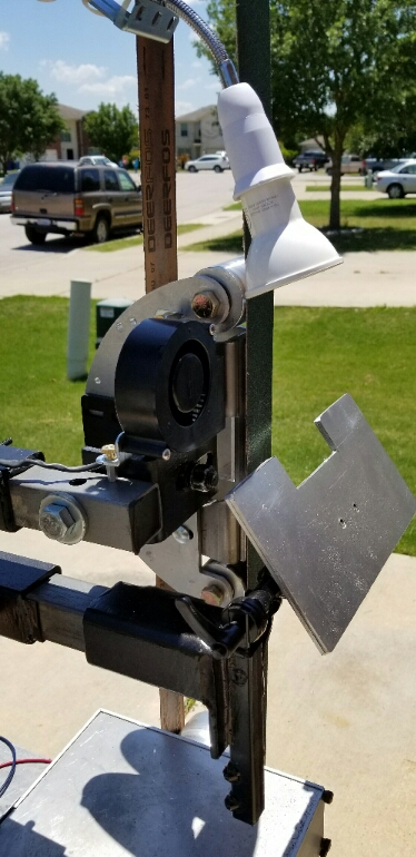

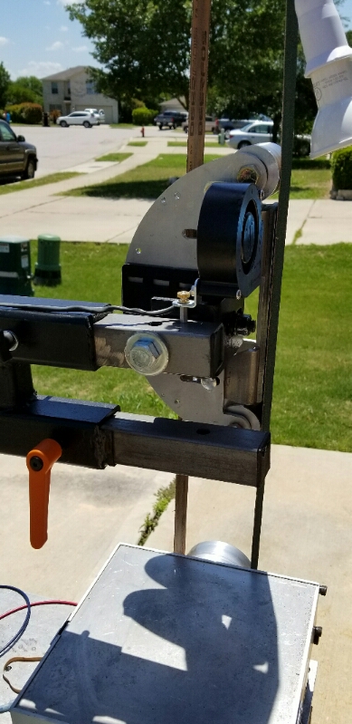

    A) The Steel is all 1/4" or 3/8" structure steel to keep from flex and vibrating
    B) The Adjustment Idler wheel is mounting bracket to mount computer monitor to the desk and worked perfect(salvaged)
    C) The D plates are 1/4" aluminum(salvaged)
    D) The Plate rest is 2 x 3/16" aluminum(salvaged)
    E) The Adjustment arm for the plate came of a gun shooting plexi-glass platform I built for my sons wheelchair. I wanted to incorporate something that reminds me of him since he passed away a few years ago.

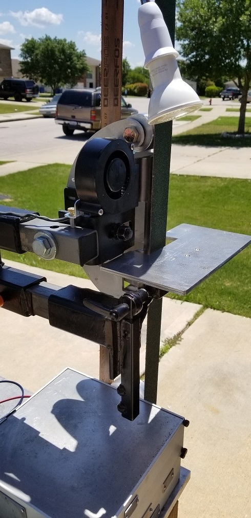

    F) The plate is designed to angle in both directions since I can run the grinder forwards and backwards, then I use a digital angle meter to set the angle. The plate is also designed to slide off for flat grinding as well.
    G) It uses a gas spring to maintain tension and it designed to simply pull down and slide the belt off.
    H) The motor is controled speed by a potentiometer mounted on the control box.

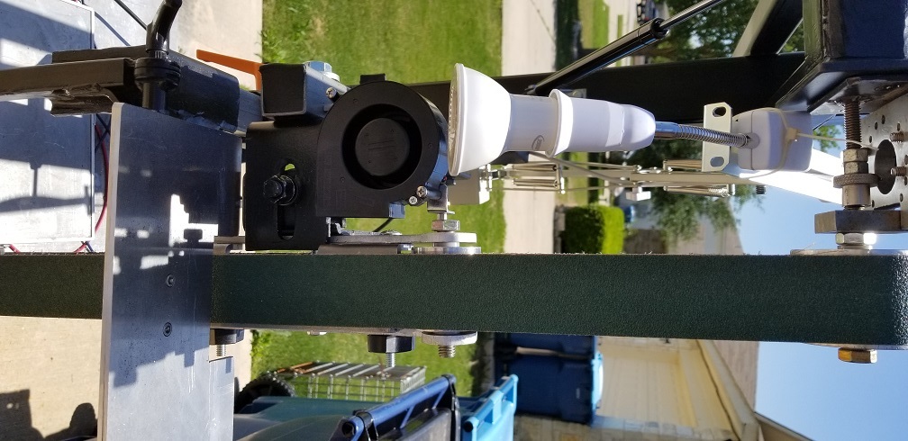

    I) I mounted a blower to help keep platen cool powered by an old 24 volt laptop power supply.

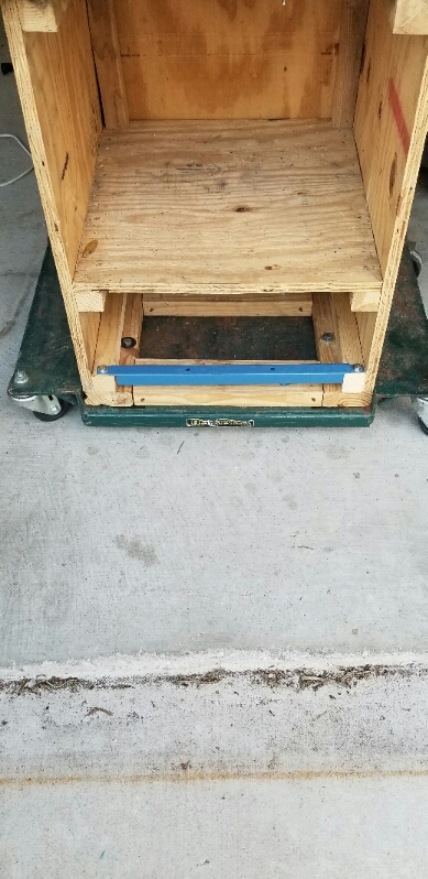

    J) The Cabinet is salved pallet from work and the cabinet dolly someone threw away when they moved down the street.
    K) Total cost $275

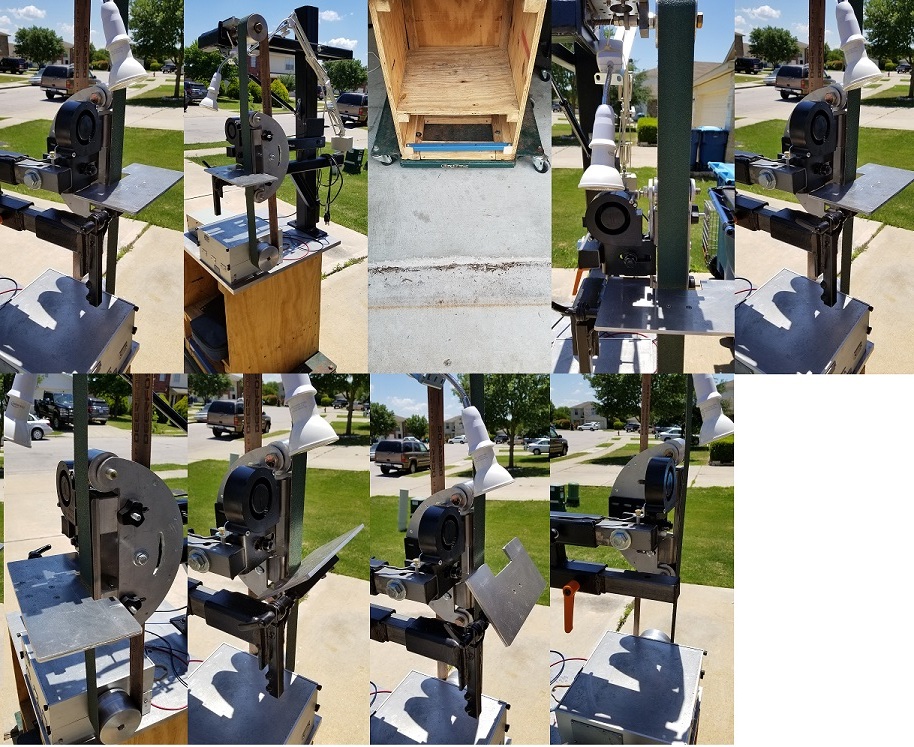

    THought you had made a whole herd of grinders
    Would love to see you post individual photos. Can't get a good grasp with the smaller images. Nicely done.

    Reposted Grinder pics

    Reposted pics Toller

    It is certainly different from the normal square wheel. Was the idea here to be able to do slack grinding and square wheel grinding with out changing the setup? Or possibly a space savings measure?
    Also it is kinda hard to tell from the pics but it looks like you have a cooler blowing on the back side of the platen? I think this is the first I've seen something like this.
  15. #10
    May 2018
    Elgin, Tx
    9
    Thanked 32 Times in 8 Posts
    Bevoblood's Tools
    Wiz I just kind of took ideas from several types of grinders 2,3 and 4 wheel types and put them in mine,I took little things I liked about each design and incorporated them into something I liked. I wanted to be able to have it for multiple uses. I can take the front attachment plate off just by sliding it off easily and it makes it easier to square/flat grind sometimes. I can easily slide the D plate back to slack grind. I can easily slide attachment plate back on throw a quick digital angle meter on it and get the exact angle I want to put on a work piece. I can also quickly change the direction of the motor on the back of the control box since the power goes in via banana plug so just flip the cables in 5 seconds and I can put an angle on the plate in the other direction. This way I am not looking down into the workspace area. I can now easily see it since the work piece since it is out front now and not looking down into the workspace.
    Yes that is a 24 volt computer blower fan, the switch is small black box mounted with velcro on the side of the upright that is plugged into a 24 volt wall supply mounted with velcro on the back of the upright. It does a good job keeping the platen cool since it is a blower type fan and not a regular type fan and keeps the dust out of the way.
