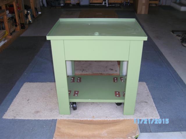

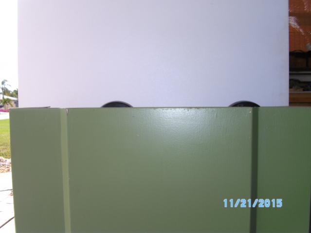

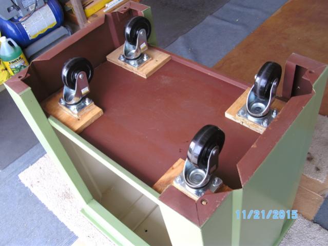

    Benchmaster mill stand restoration (Reseda green and almond on 5" casters)
    Hi Listmates
    In response to overwhelming demand (2), here are three pics of the Benchmaster stand restoration. Color is RAL 6011, "Reseda green", oil-based and supplied OTC by S-W, inside is painted "almond" also supplied by S-W.
    The casters are 5" diameter from HF, bolted to a couple of layers of scrap builder's ply. For reasons of stability, I should probably have made the larger pieces out of one solid sheet covering the entire undersurface of the shelf, but I didn't have any to hand and it isn't really necessary. The thinking behind this is that the mill will only be on its casters when I move it from A to B in the garage/shop. When the mill (on its stand) is where I want it, I will raise it 3/4" using a small, wheeled jack and slip a couple of 4"-wide strips of 1/2"-thick ply under both sides and then lower it and roll out the jack. The mill will never stand or be stored on the casters for any length of time.
    The casters protrude about 1/4" below the lower edge of the stand, which seems to handle any minor floor imperfections.
    I intend to line the top surface of the inner shelf with a sheet of mdf glued onto thin battens to raise it above the bolt hex. heads.
