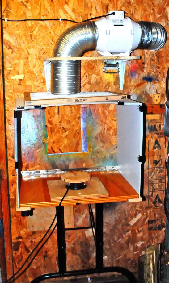

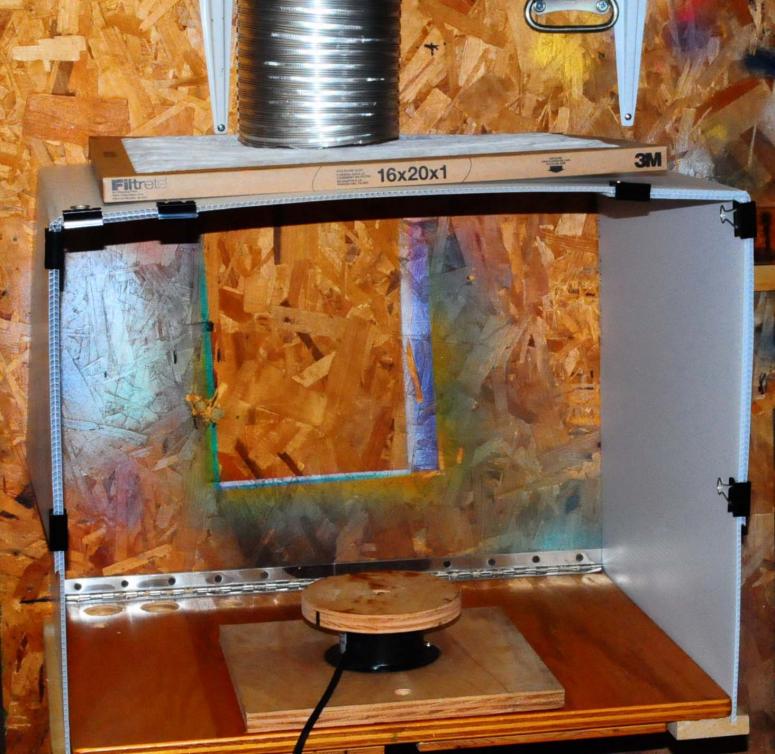

    Jon Been working on Pens lately. Have a A&C Show coming up a week from tomorrow and need inventory. My latest tool/equipment build was a exhaust fan/workstation for airbrushing and powdercoating. I have, since the photo, made the booth higher. This is mounted on a shop door with a fold down/fold up table. The hole in the table allows a plastic bag to be placed for collection of the overflow powder, when powder coating. I have also incorporated a furnace filter to catch the mist when I'm airbrushing. For safety I am going to have to remove the ends of the shelf so I don't walk into them. Don't ask me how I know!

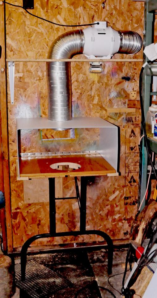

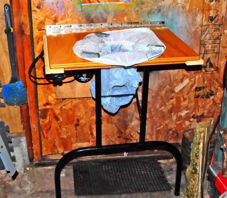

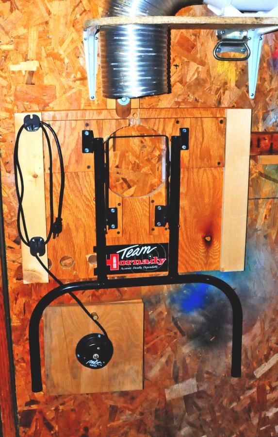

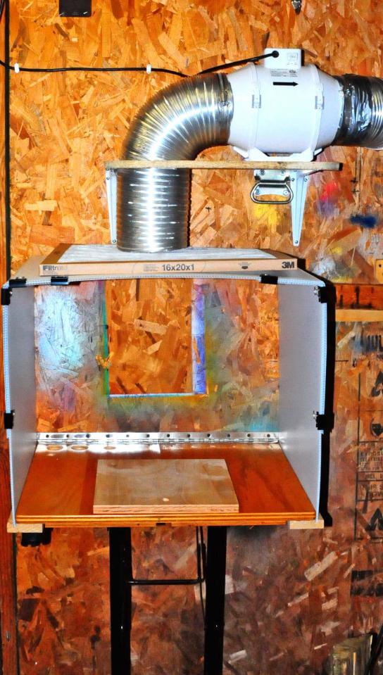

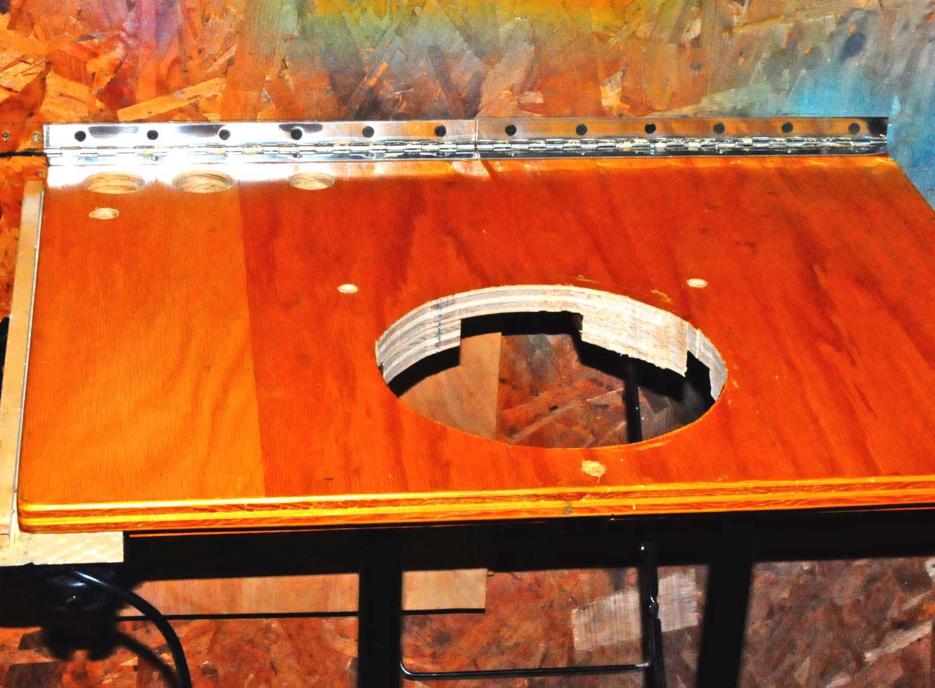

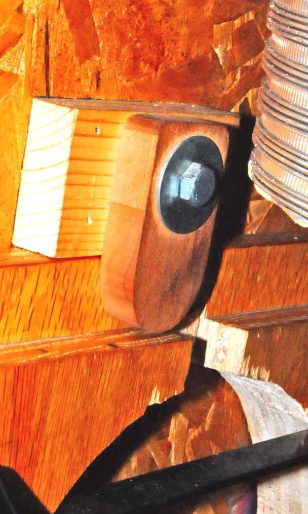

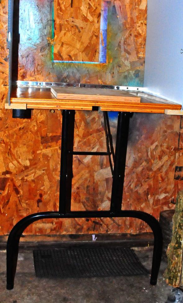

    Following my initial post, I received this inquiry. This was a resourced rifle shooting bench. I probably bought the leg assemblies ( don't remember for sure ) at a home supply store. I cut it in two and with flat hinges (see photos) attached it to the shop door. It could be fastened to any outside wall, etc. I cut a hole through it to hang a plastic bag for powder coating as the powder is heavy enough to mostly go down in the bag. I have an exhaust fan to take excess outside. I have placed a furnace filter inline to separate powder and Airbrush mist, when airbrushing. As you can see the filter just lays on top of the spray booth in front of the exhaust fan. I wasn't concerned with PURTY, just wanted it to work. File name on the pics should make it pretty simple to see what they are. To cover the Powder Hole, I designed one cover with a ball motor for a turntable when airbrushing vases and bowls. and one stationary for whatever. If this helps anyone, have at it. I am also open to suggested improvements. Maybe I'll get this figured out. Computers is my weak suit. File names didn't upload with pics so, I guess if you have questions, you'll just have to ask !
    Attached Thumbnails Attached Thumbnails Newbee!-folded-table-bottom.jpg   Newbee!-wall-latch.jpg   Newbee!-folding-legs.jpg   Newbee!-hole-powder-coat-powder-bag.jpg   Newbee!-powder-bag-installed.jpg
    Newbee!-setup-stationary-base-no-turntable.jpg   Newbee!-spray-booth-ball-motor-turntable-filtered-duct.jpg   Newbee!-turntable-setup-2.jpg
