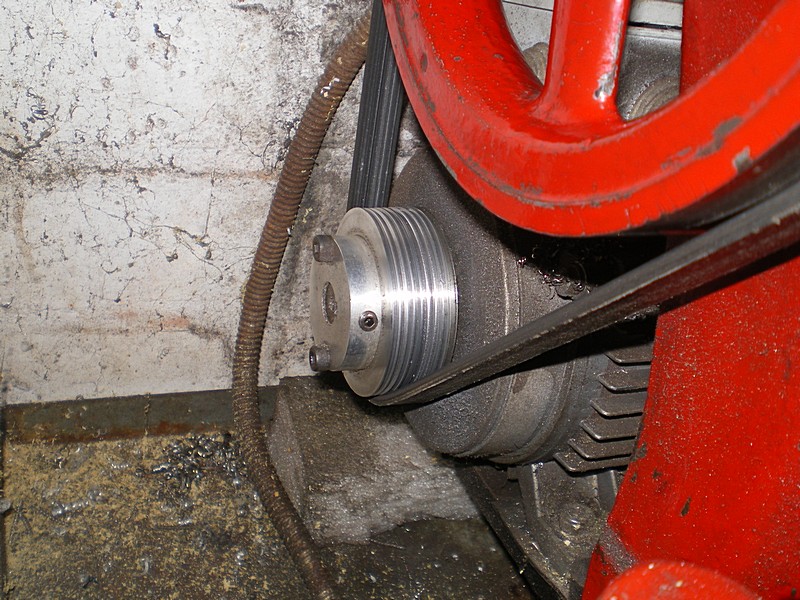

    Hi JR
    Great work on your new drive arrangement, you mention using V belts, have you considered Poly v belts. I have used one on my countershaft drive for some years now and they run really smoothly and the pulleys are easy to machine, never had a problem with slip either.

    Hi JR

    I was thinking the same thing last night Olderdan or even a toothed belt. SDP/SI has a full line of toothed, grooved, O'ring, flats and V belts and pulleys for fractional hp use and are even better for torque. Although making the pulleys for a Groove belt would be easier and a fun challenge.

    Hello Dan and PJ, The belts are very interesting with so many types out there.
    I did use a Poly segmented v-belt on my CNC spindle and no problems at all.
    Nice small profile. Seems they use these on vacuum cleaners and sewing machines.
    I wanted to try a 3L section Kevlar belt for the lathe and see how that works out.
    The belts are available for a good price and they look tough.
    Both the lathe to jack shaft set and the motor to jack shaft set will be replaced.
    I planning to have them on hand should all the teeth on my timing belts disappear! LOL
    Thanks for all the suggestions and comments
    Cheers, JR
