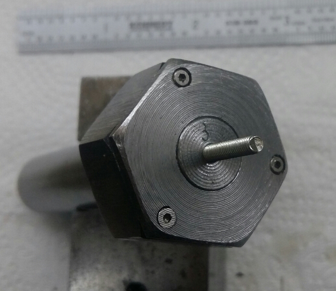

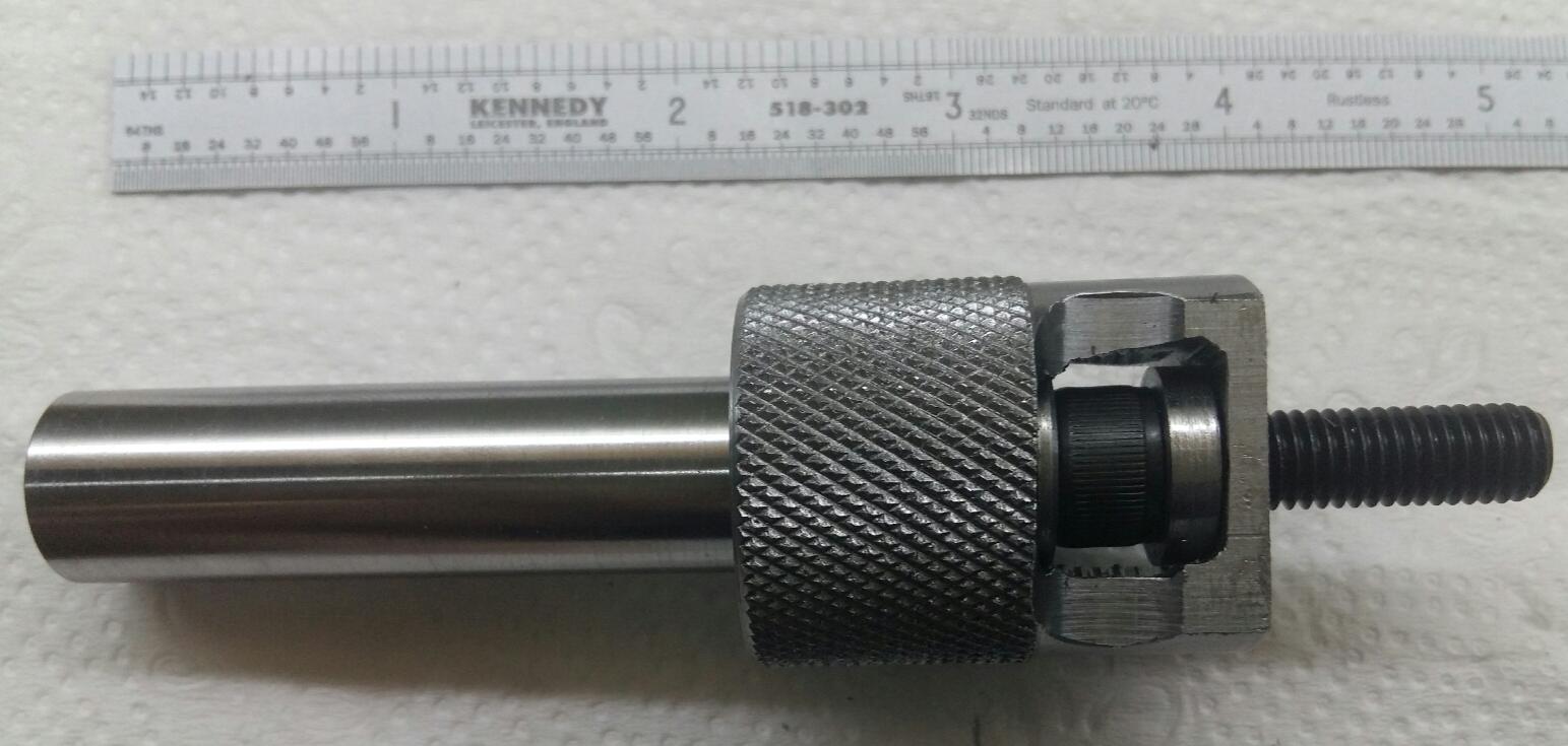

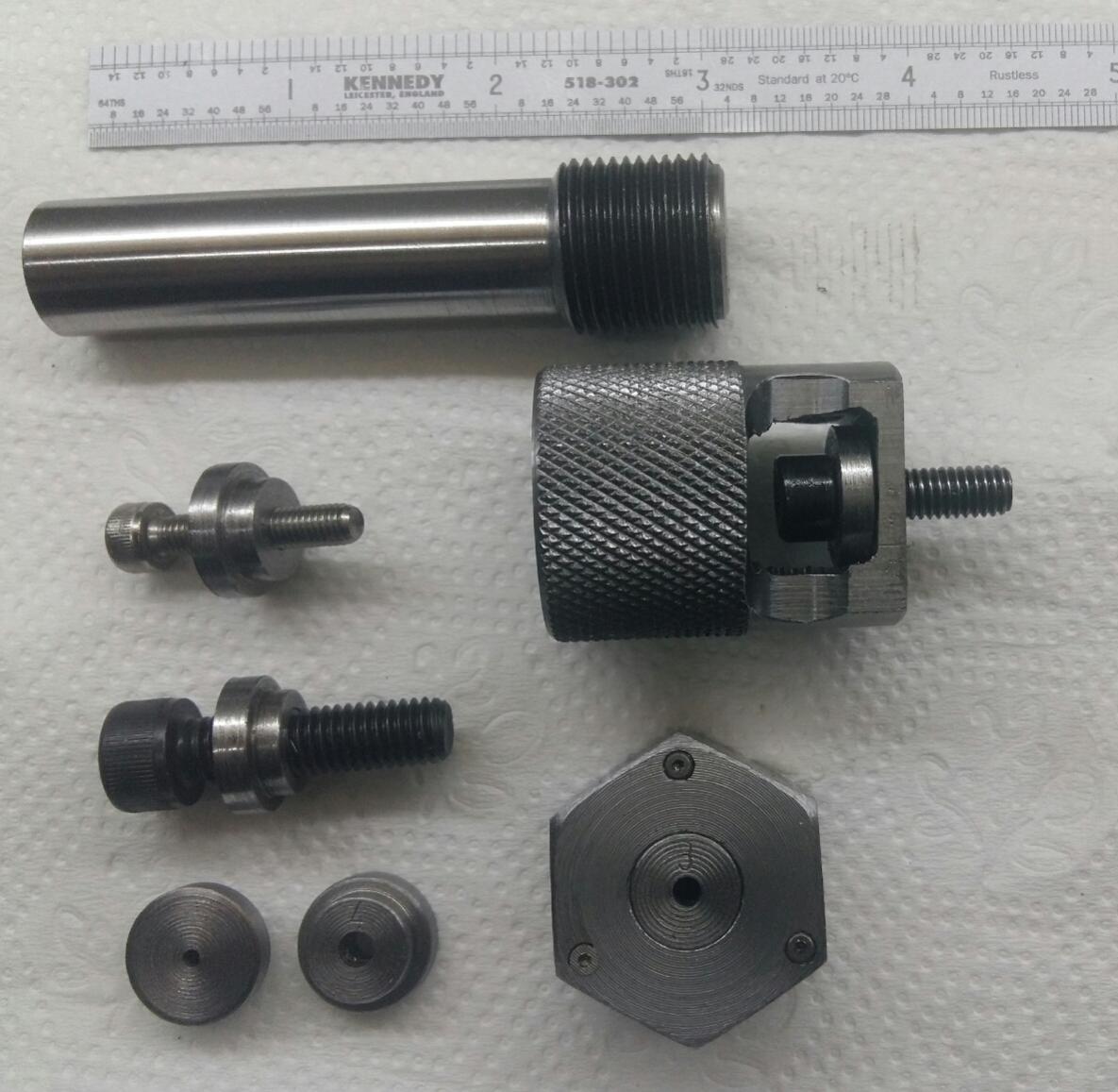

    Lantern chuck
    I have just completed a simple lantern chuck that can hold bolts from 2mm to 12mm. I often have to shorten or change a bolt and always end up damaging the thread.
    I made it from a 20mm x 1.5mm bolt and nut and then made an additional chuck for the bigger bolts and bolts with a bigger/longer head like capscrews. It is certainly not a show piece but a working tool so I did no finishing on it and put it straight to work.
    New member-2018-01-25-21.24.44.jpg New member-2018-01-25-22.01.24.jpgNew member-2018-01-25-21.55.11.jpg
