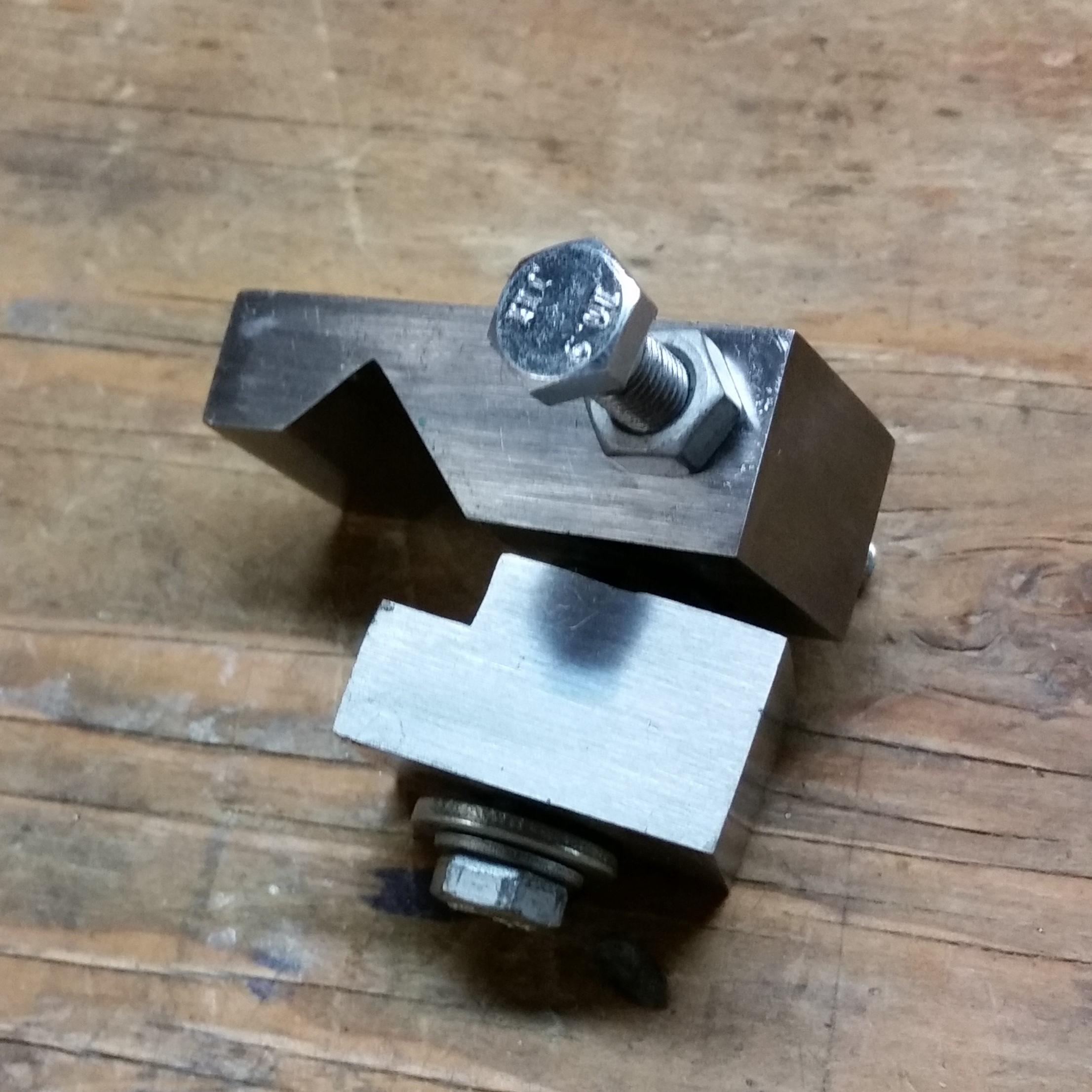

    Hello, Name is Mark, retired field construction Boilermaker. attempting to learn a bit about machining. like to work with my hands and tools. have just finished up my first real project, made a carriage stop for my 10x22 g0602 Grizzly lathe. Basically a copy of one made be xynudo on you tube. Only thing I did different is I used a piece of 1/4" round stock for pivot point instead of ball bearing. machined a grove for the rod and tig welded it to the bottom piece to keep it in place.

    Post a pic of your carriage stop, we'd love to take a look.

    new member-20170221_175249-2-.jpg ok figured out how to reduce pixels. hope this worked

    Nice! We'll get it indexed and added to the encyclopedia, credited to your name.
