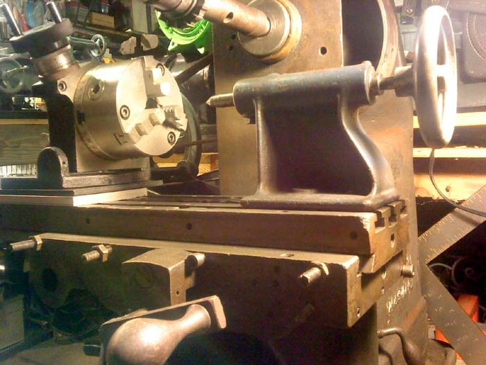

    Well I just finished machining down an old lathe tailstock. I'm going to use it with my rotary table on the horizontal mill. The next thing I'm thinking about doing is cleaning up an old South Bend armature grinding attachment. I've got a spare cross slide that I adapted to hold a Palmgren milling attachment. I'm looking at maybe making a rotating base for the grinding attachment that will fit on it.

    Well I machined off the grooves and the "centering bump" on a Craftsman lathe tailstock and thinned the bottom after discarding the base. I then drilled a second hole in line with the one for the tailstock bed clamp. I also added a base to the rotary table. This got the centers aligned. Haven't used it yet.
