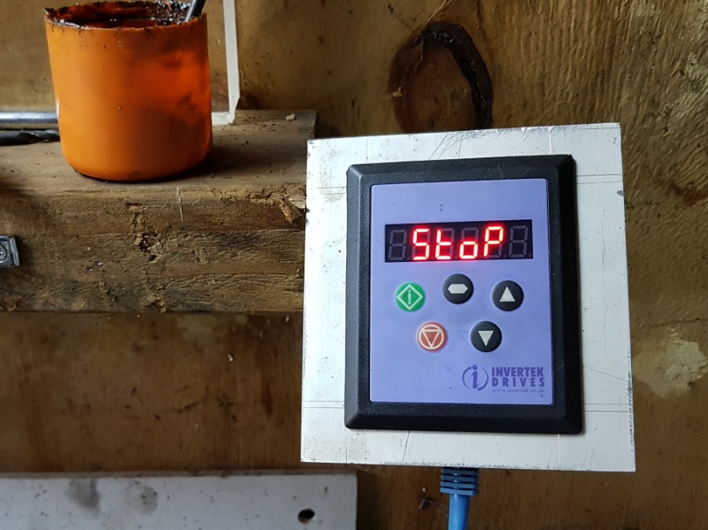

    For now I've set the VFDs parameters to match the specs of the old motor, though I'm going to be playing around with various switches and the manual inputs to find interesting ways of controlling the saddle a little later on.
    After setting up the drive, I made a quick and dirty manual control panel out of a short piece of galvanised right angle, bent it downward a bit to make it more comfortable to use and then installed it next to the MEM starter box that's the safety disconnect between mains power and the drive.

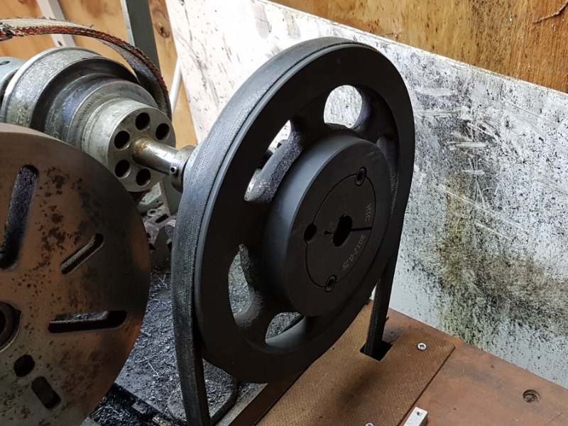

    During a quick tea break, I orderd a pulley for the new motor as the shaft is a lot bigger than the old one. I did consider boring out the old pulley but it was worn so thin it wouldn't have survived a gear puller.
    I also ordered a new drive pulley for the lathe while I was at it. The original iron pulley casting is out of balance and causes a lot of vibration at certain speeds. It's also damaged, two of the support struts are cracked right through so there was no getting round it.

    After much ado trying to sort out some badly machined pulleys, I ended up going for a set of taperlock pulleys, which have made all the difference in eliminating the worst of the vibrations I was getting before with the original drive pulley and as a result I'm getting a much better finish.

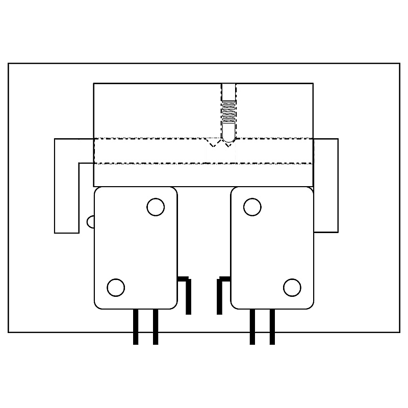

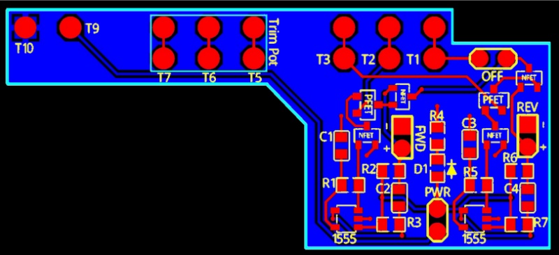

    I'm taking things a step further and I'm going to be adding some switches and a custom PCB I've designed to take advantage of the VFD manual directions and start/stop to control the carriage. The PCB adds a delay to both directions before they resume so I have time to move the cross slide in and out for thread cutting operations and breaks out the common line to both direction switches that I can use as multiple carriage stops for turning operations.
    New lathe electicals and subsequent bench mods, with a hint of restoration.-59e23ea5dfda4.jpg
    Here's my concept drawing of the switch trigger mechanism for the carriage control system:

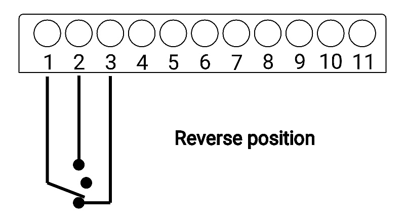

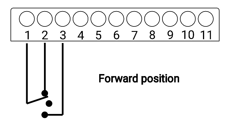

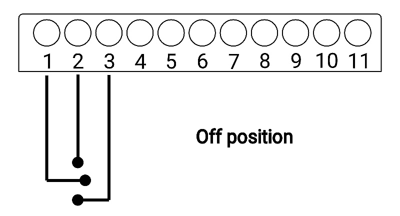

    The following diagrams to show how the main control switch is wired to the VFD terminals:
    New lathe electicals and subsequent bench mods, with a hint of restoration.-59dfeed05301c.jpg
    New lathe electicals and subsequent bench mods, with a hint of restoration.-59dfeed0bbd86.jpg
    New lathe electicals and subsequent bench mods, with a hint of restoration.-59dfeecfed18a.jpg

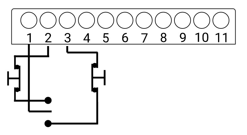

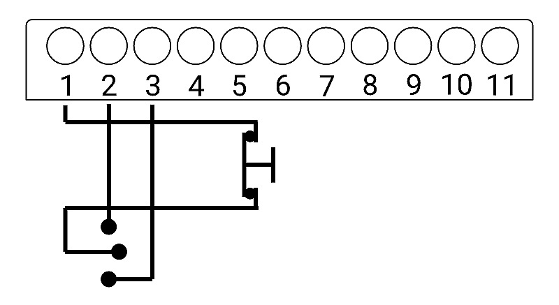

    Placing a button in series with any one of the three lines allows extra control. Using push to break or push to make buttons (latching or momentary) allows one to tailor the system depending on how you want it to work. It's worthy of noting that buttons placed on the common line will effect the both forward and reverse line at the same time, whereas buttons on the forward reverse lines work independently.
    By daisy chaining combinations of both types of switch/button, a complex automated system can be achieve relatively easily without the need for some kind of micro controller or CNC.
    Here are a few diagrams showing single button placement:

    At least I can move forward with prototyping the PCB now, wiring things up is the easy part.

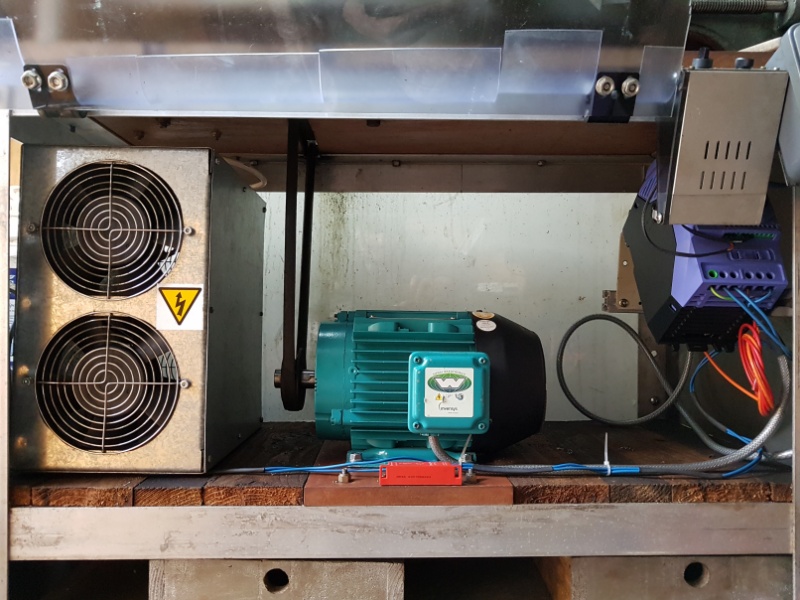

    I bought a new brake resistor of appropriate wattage and value for my motor last month. It arrived in the mail yesterday and was waiting for me when I got home from late shift, which is a good time for a bit of quiate tinkering
    After unhooking the brake box from underneath the bench, I whipped the side off to reveal the current setup:
    I then removed the old resistor and installed the new one. I was able to use the existing mounting holes but the new resistor is a tad longer than the original occupants, so couldn't use oposing pairs to fix it in place. I did consider fixing it on one side only so it could lie parallel to the fans but my bench isn't the most sturdy and would probably cause it to rattle so I made the compromise and used the next hole across:
    It was late and I didn't fancy digging out the soldering iron, so I came up with a bolt together solution for joining the wires using a plastic right angle bracket, three M4 screws and a brass stand off. The essembly was then mounted on the standoff to give clearance for the wires and positioned so the terminals don't come into contact with the housing. Eventual refinements will include making new holes to straighten up the resistor and sleeving the terminals for better protection from short circuits.
    Turns out the resistor doesn't just effect stop times, my lathe can now start scary fast (currently set at 0.8sec), though unfortunately I can't get the lathe to stop quick enough despite the new resistor doing it's thing and the ramp time set to 0.1 sec. As such I'll need to rethink how the carriage control system will work in ordet to comensate but I'm not too bummed, she's already performing so much better than she was not so long ago so I'm happy as Larry right now

    Seems I had a bit of a brain fart as I needed to enable the brake chopper function which was in the extended parameters. They weren't that easy to get to as they're normally hidden and a code has to be entered to access them but she's now stopping about 1.1/2 turns of the chuck, which is quite good considering the amount of iron being moved at speed and I don't have to rethink my carriage control system now either so it's all good
