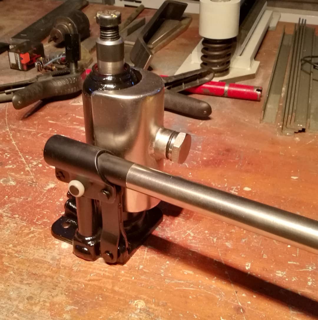

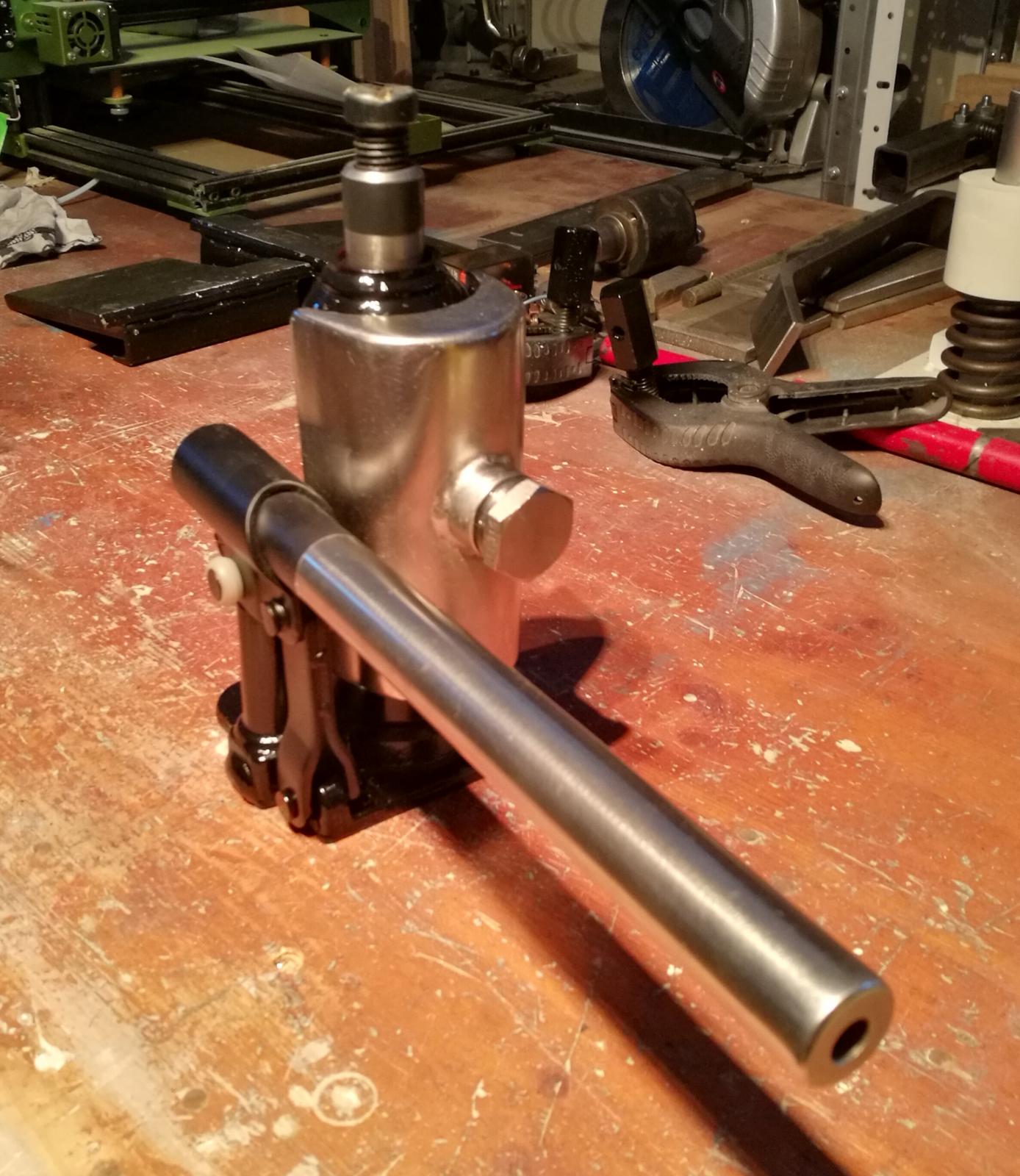

    Last post from this jack. Now its ready.
    Next jack will be motorized.
    Handle is made from a stainless pipe, and weld on its place. Nylon pushings prevents wobling movement in use.

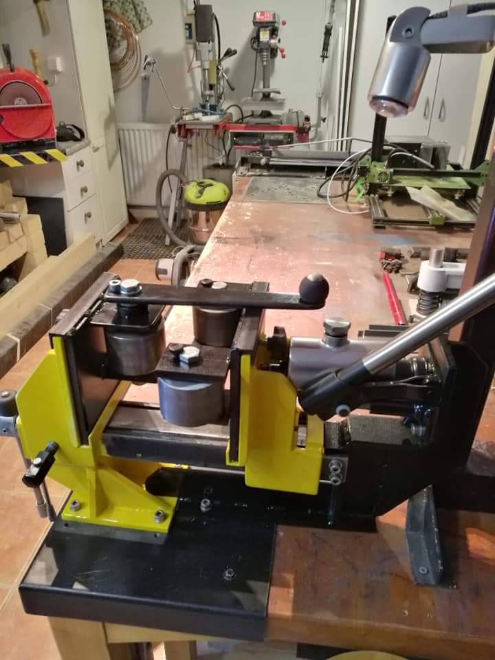

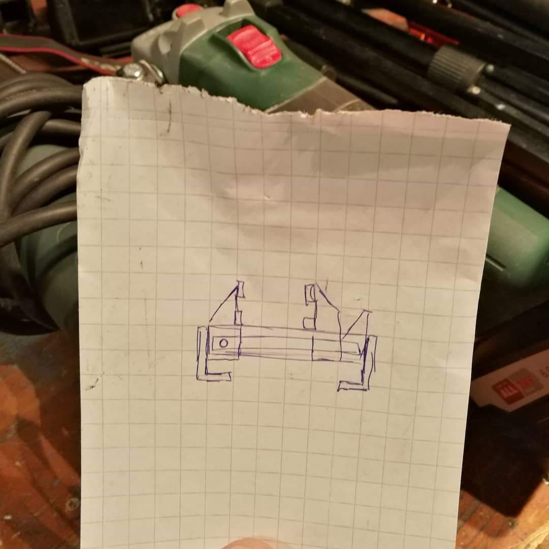

    Here's the finished build with the ring roller dies.
    Plan:
    Result:
