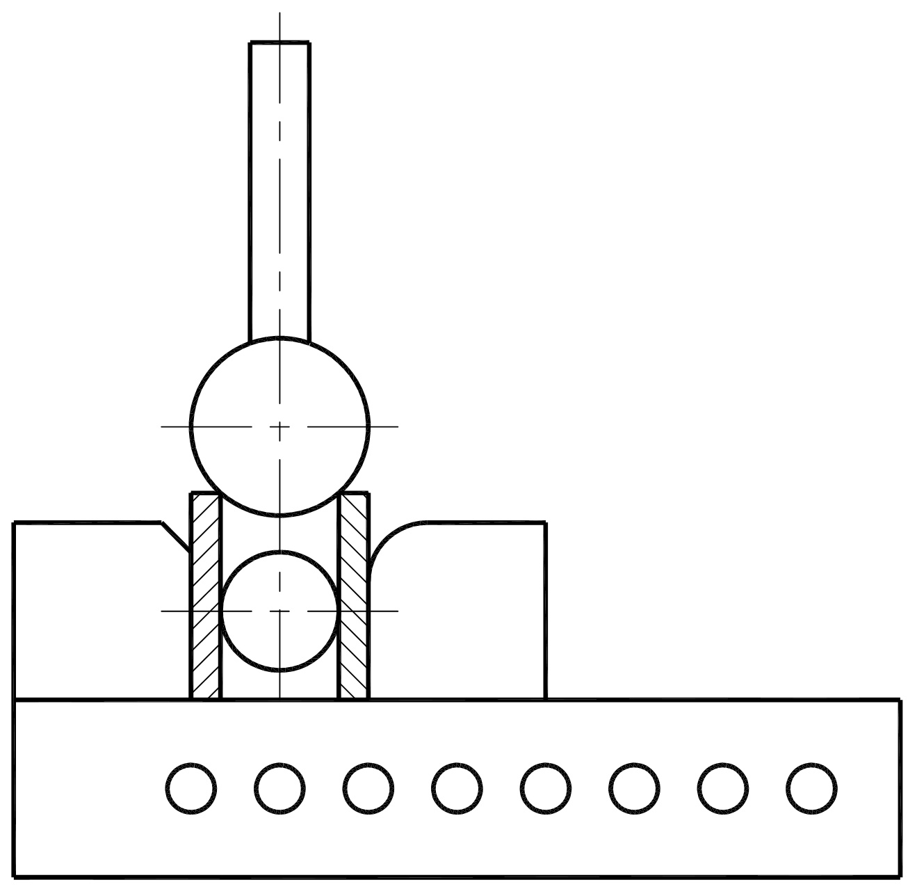

    This very clever tool does depend on the fixed and movable jaws being at the same altitude and having the same bevel. It also cannot bottom out on the part.
    Rick
    Rick

    Thanks for the interest Rick! Yes, old, misaligned and uneven jaws are not for this tool and for no other! See other geometry options at the end of the video, one may be useful. For me it has been very practical when machining keyways or drilling shafts, fixed horizontally and vertically.

    For different bevels, old vises and old jaws provide two equal plates and fix them according to the drawing below. That simple!

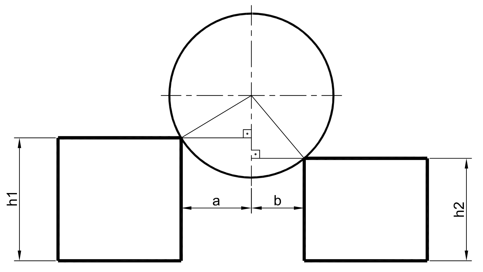

    This was an interesting trig problem. I figured out that the centerline error is a function of the difference in jaw heights, the gap between jaws, and the diameter of the center finder tool.
    For example, say the jaws differ in height by 0.01" and the gap between jaws is 1":
    center finder diameter error in centerline
    1.1" 0.002"
    1.5 0.006"
    3.0 0.014"
    This tells me that for the best accuracy, you want the center finder's diameter to be as close to the gap as possible without falling in.
    Rick

    Rick, thanks for the interest again! Yes, any vise with uneven jaws in height (or with longitudinal clearances) can cause this and other position errors. As this device works with tangency points, it would be interesting to at least ensure that these points are reliable (or work with some type of templet as I have shown). Manufacturing tolerances must also be observed, in this and other cases.
    A simple question, just out of curiosity: how did you check the accuracy of your center finder?
    https://rick.sparber.org/acf.pdf

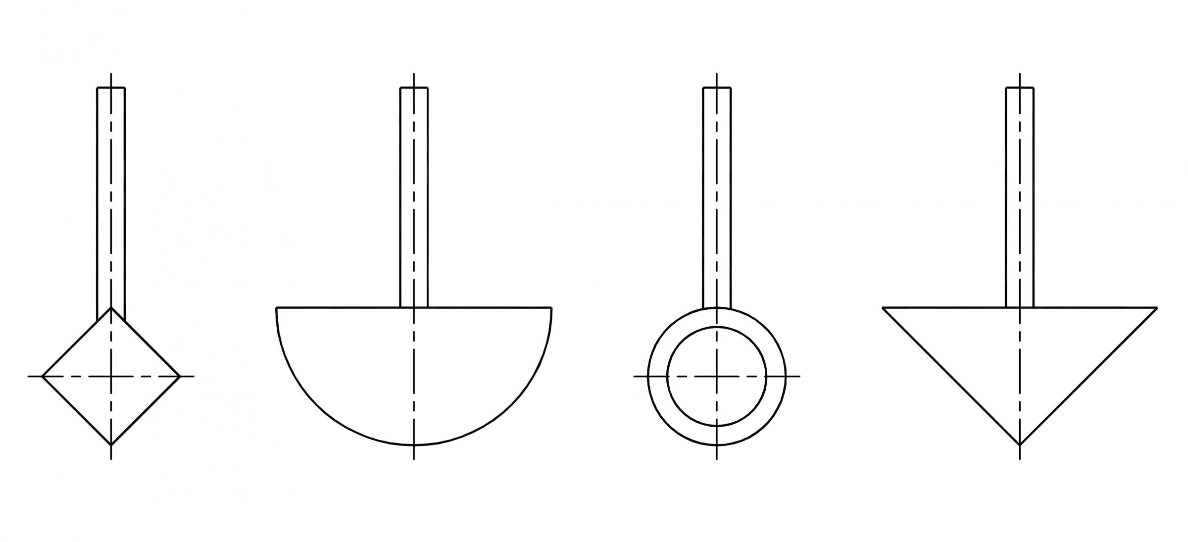

    Other geometric options:
