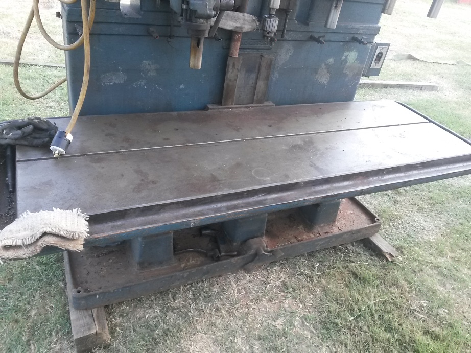

    the 6 head drill press in variable speed as well

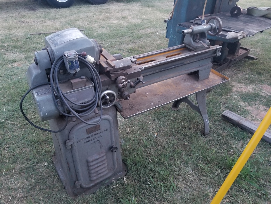

    the little Sheldon lathe looks like a brand new 70 year old machine it is in such good condition. 6 1/2" awing over the cross slide and 36" between centers can swing 13" at the chuck

    The production drill with six heads, running coolant can outrun a CNC with box or plate jigs. I like those machines with hand tight Albrecht chucks, one quick change like a BIG-Daishiwa [formerly Sheppard] or Magic Chucks, and a small tapping head. They look to be #3MT, it would handle 1/2"/ 12-14mm taps in most materials.
    I see they are wired with plugs; my favorite L16-20 twist locks. Fuse them at the wall, twist lock for disconnects!
    And that 3rd picture; what is THAT; some kind of paper weight? Lol, maybe a salesman sample?

    The Leyland Gifford 6 head has MT3 spindles 2 of the heads have power feed and one of them has a reduction gear box on the top of the motor the rest are 3600 RPM motors with a variable speed controller that adjusts to a lower RPM An up grade to a SCR or VFD would probably no be a bad idea. These hollow shaft motors would be as difficult find for replacements 6.6 Fl amps puts them in the 2 HP range the charts on the speed controller shows the recommended ft/min cutting and drill size speed 5/8" being the max size.
    Have a look at the table there is not a single divot in it this tells me that this machine never saw a part drilled that was not held in a fixture it has the single torque and location slot right down the middle it would have been nice to had found the top indexing plate but I did receive 2 of the 8" quick clamp vices

    You say this is a paper weight compared to yours and my way of thinking you are correct however many is the time when I have wanted a smaller machine to do the smaller jobs instead of firing up a 3 to 25 hp machine I can run 10x the parts in a shorter time frame on a small machine like this and runn it all day long on less electricity than it takes just to switch on a larger machine.
