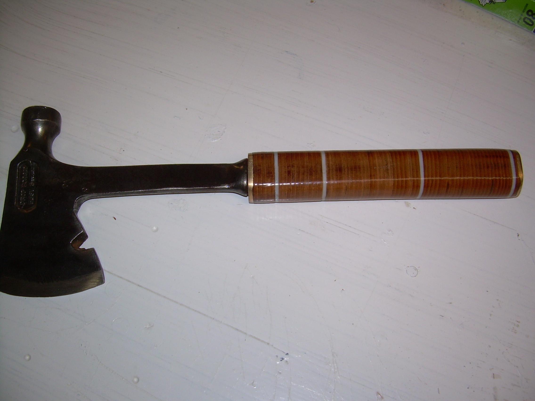

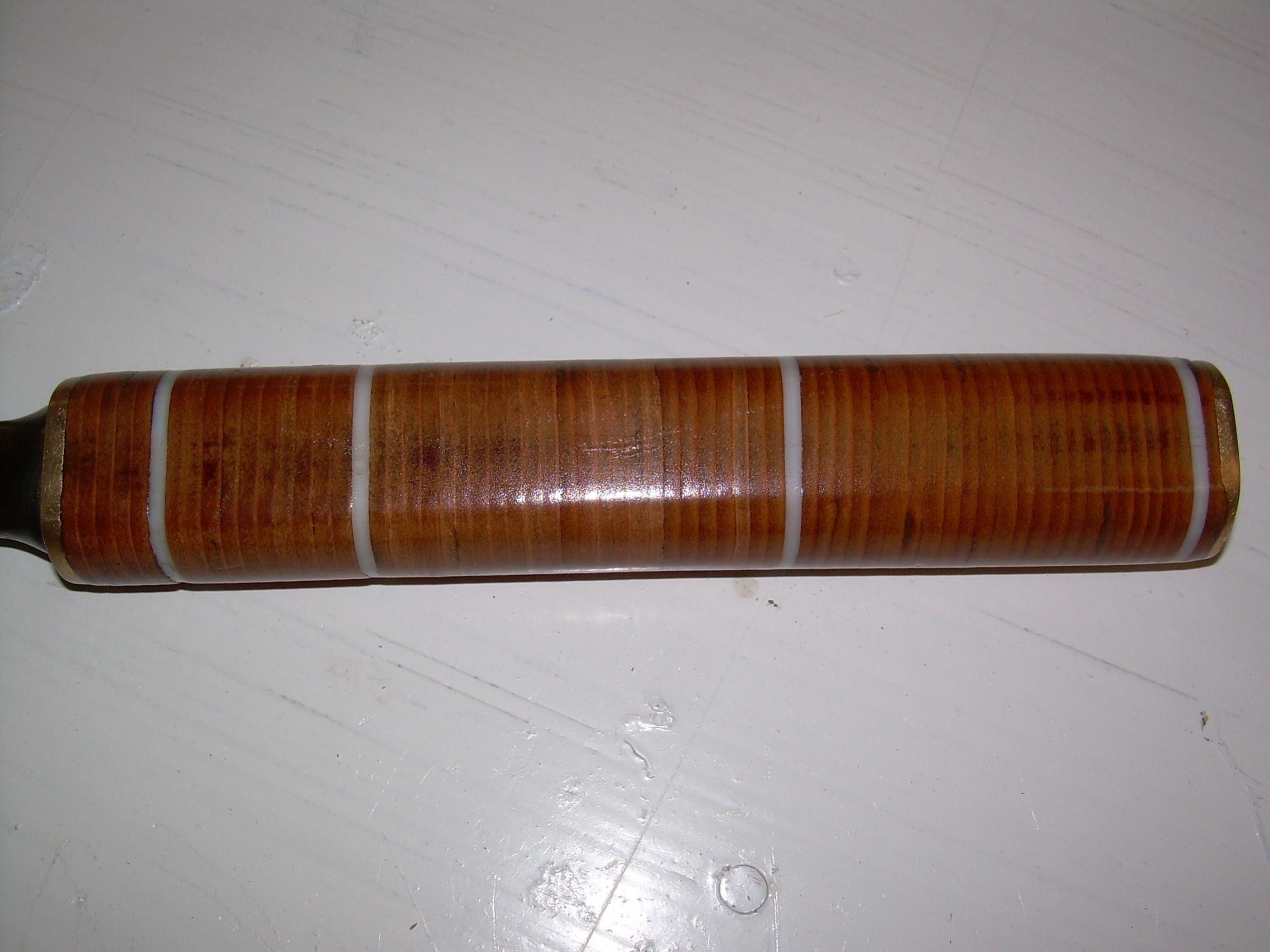

    Had this old hatchet laying around the shop and decided it needed a new handle. The tang on the hatchet was steel so I cut out a few leather washers and also some washers cut from the bottom of a white plastic bucket. Brass washers were used for the ends. Ground off the rough edges and smoothed out and polished the handle and another project finished. More ideas tumbling around in this ole head, gotta get back to work.New handle-037.jpgNew handle-038.jpg

    Love it. I remember those kinds of handles on hatchets when I was a kid. Never see them anymore. I've got a couple of hi end dead blow hammers that plastic handles have started shattering and rather than toss them I've been trying to figure out how to put new handles on them. So what's the final finish? Like polyurethane?

    The best thing I have found for finishing handles of wood or leather and sometimes I will use this even on metal to keep it from tarnishing is rust-oleum crystal clear enamel. Absolutely the best finish I have found. I have tried varnish, polyurethane and just do not have good luck with them. This enamel dries to the touch in just a few minutes and I really like it. Good luck and thanks for the interest.

    Nice Job Frugalolegeezer! I like your mindset and that is a nice old shingler's hatchet I believe. Curious of the brand...couldn't read it from the photo. Most impressed with making your own leather stack with the bucket spacers!! Bravo on that. The knife maker guys have various stacker leathers for fairly cheap and cheerful. Here are a couple of links: KnifeKits, and Twin Leather Co.
    I restored my dads old hunting knife a while back and was able to save the leather with some light sanding and used enamel as you did. It felt like the leather liked it more than a varnish I spot tested with so that's what I used. Still have to build a new sheath for it but kind of hate to because dad had engraved his initials in it...but it's in bad shape on the inside.
