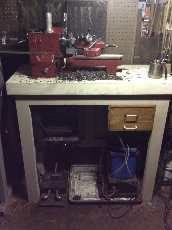

    Thanks, Frank,
    It can be useful having easy, portable machines, too. For this one, though, as small as it is, I wasn’t sure the stand would be heavy enough! Or at least have low enough center of gravity.
    Like Ranald suggested, I can hang something like sandbags on the inside if it’s a problem. I have a bunch of lead weights I can use.
  2. #12
    Mar 2018
    New England, USA
    164
    217
    Thanked 387 Times in 100 Posts
    threesixesinarow's Tools
    Thanks, Bruce,
    I’m sure I looked at the same ones as you.
    I just lift the lighter tailstock end an inch or two to lower the casters to the floor and then move it like a wheelbarrow but for heavier machines like yours you could probably combine it with one of the more elegant solutions.

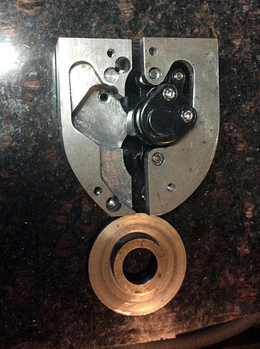

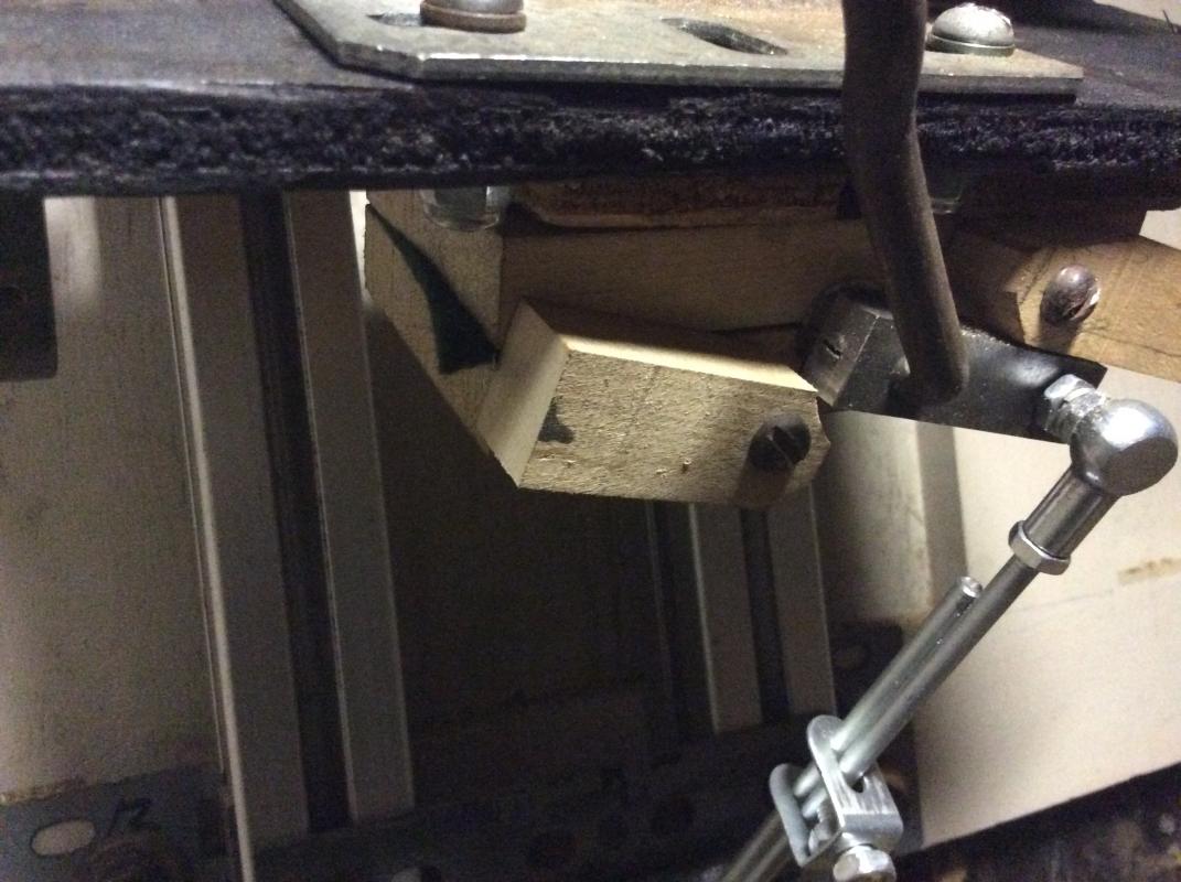

    Brake parts with 1-1/4” thick spacer and 5/16” thick adapter and rotor

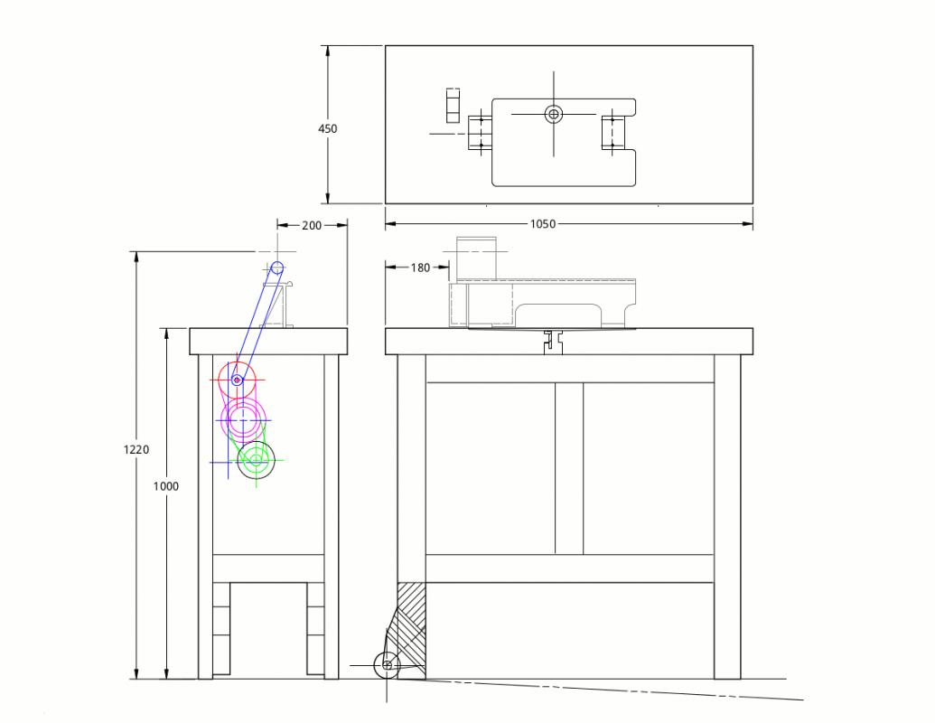

    Bench sketch

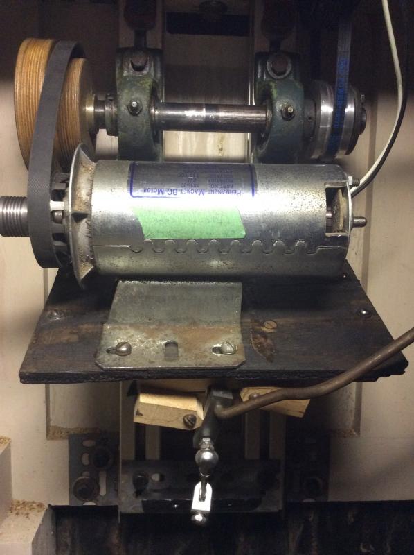

    Debounce
    New bench for an old mini lathe-2b22bdc4-0606-43a1-b564-fc0a275c4555.jpgNew bench for an old mini lathe-55a50f7d-e1cd-4418-ab1e-c3ef04120b0e.jpg
    Piano pedals sometimes use this kind of wooden two piece bearing, with felt lining material:

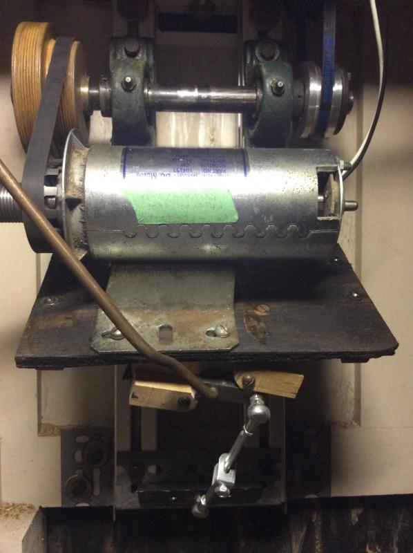

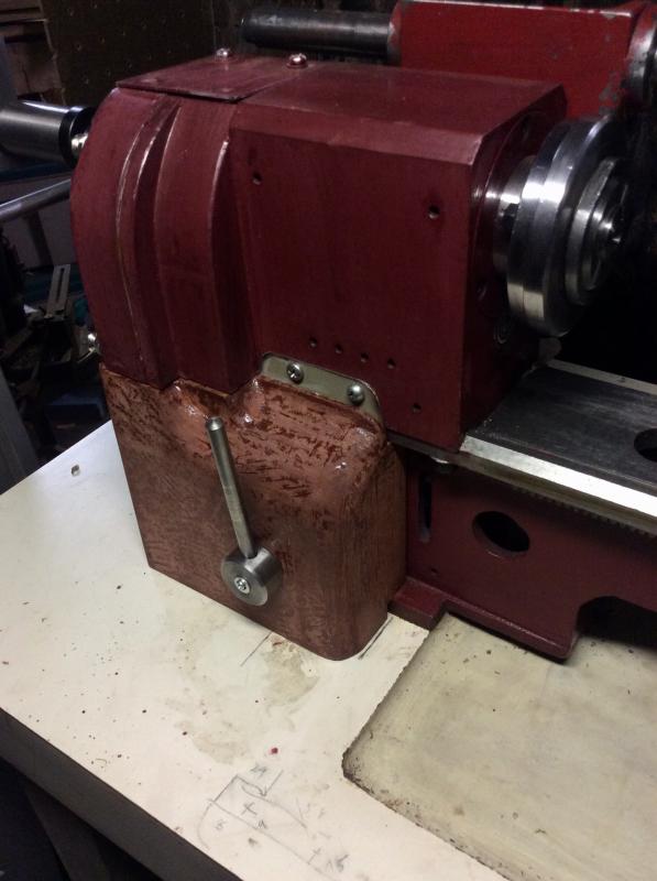

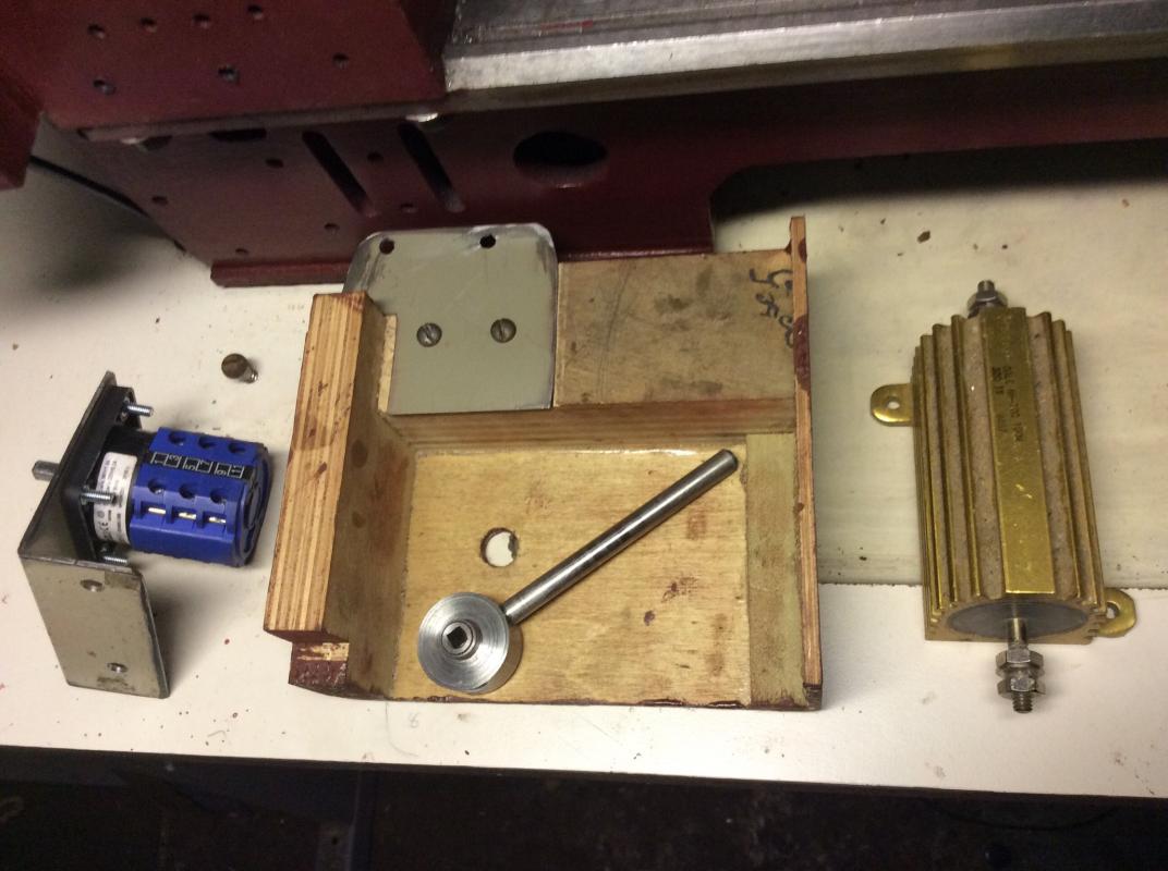

    Forward-brake-reverse switch
    Brake resistor for the motor

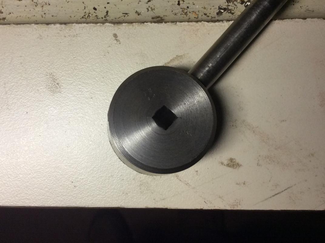

    Square hole in a round hole

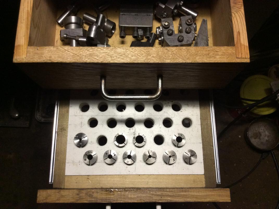

    Added drawers
    New bench for an old mini lathe-e090f611-978f-4508-b895-38c0f7b6848e.jpgNew bench for an old mini lathe-9e30909c-c3f8-4036-8206-1d8fa7b7c3ce.jpg
